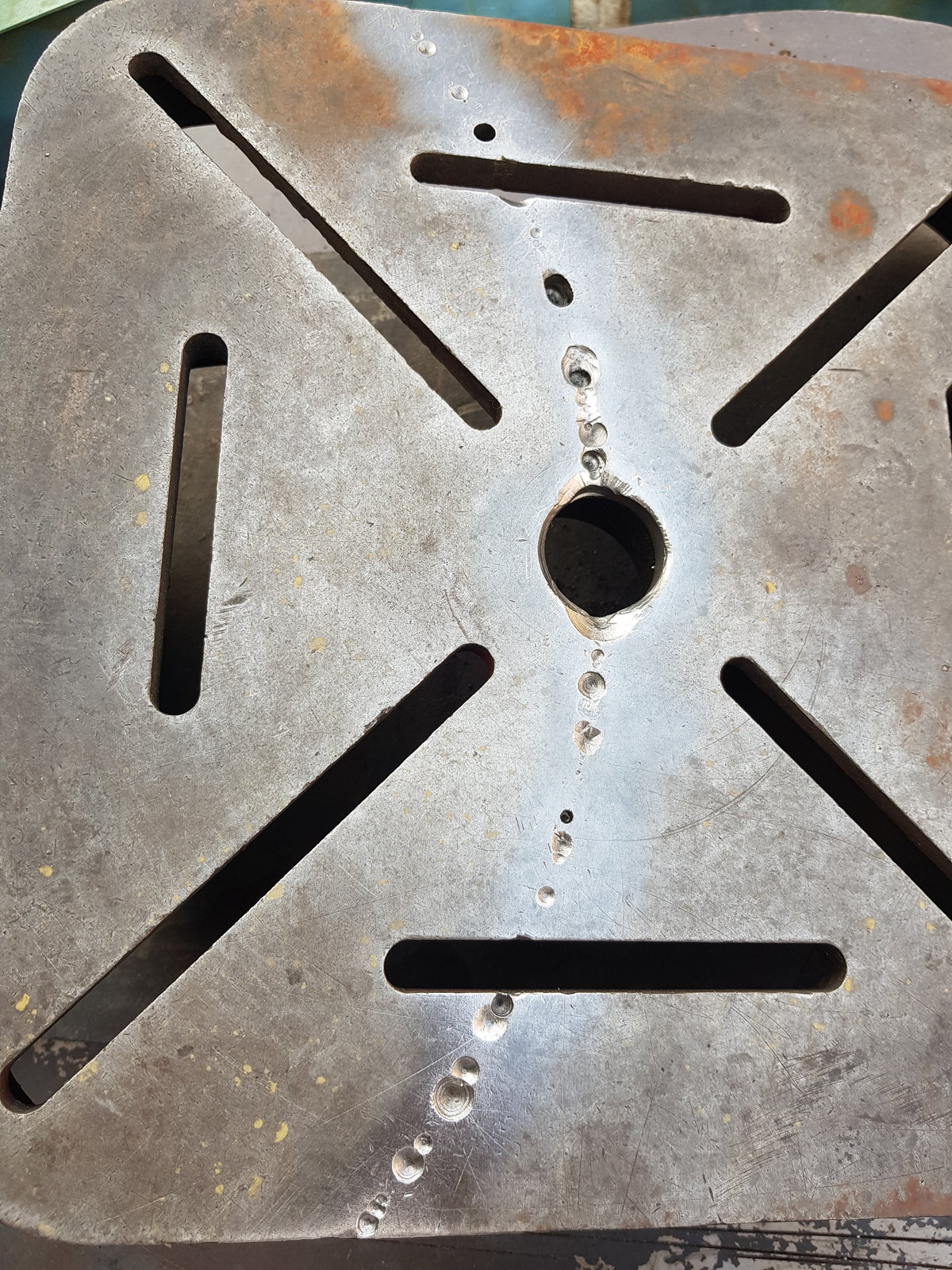

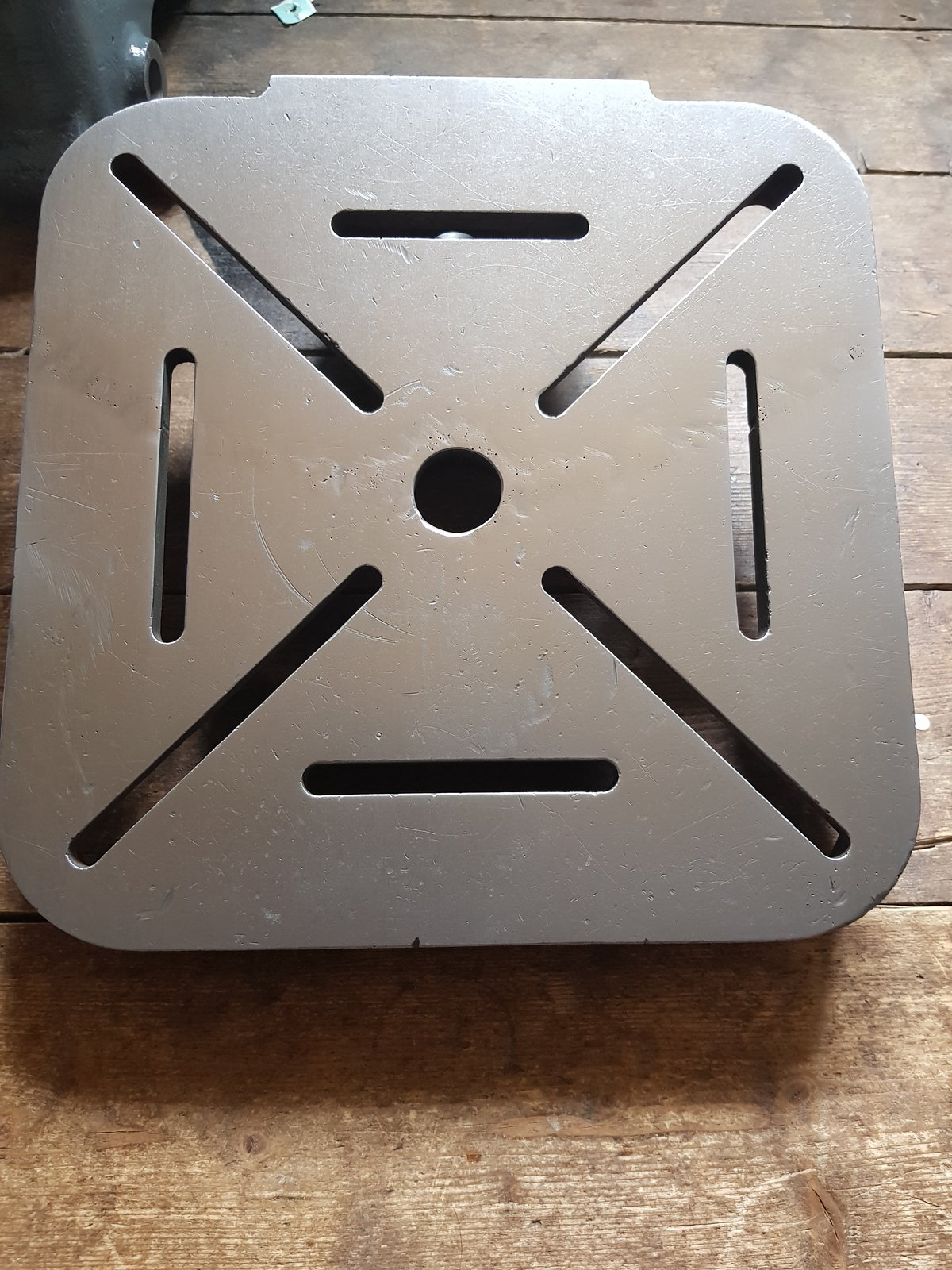

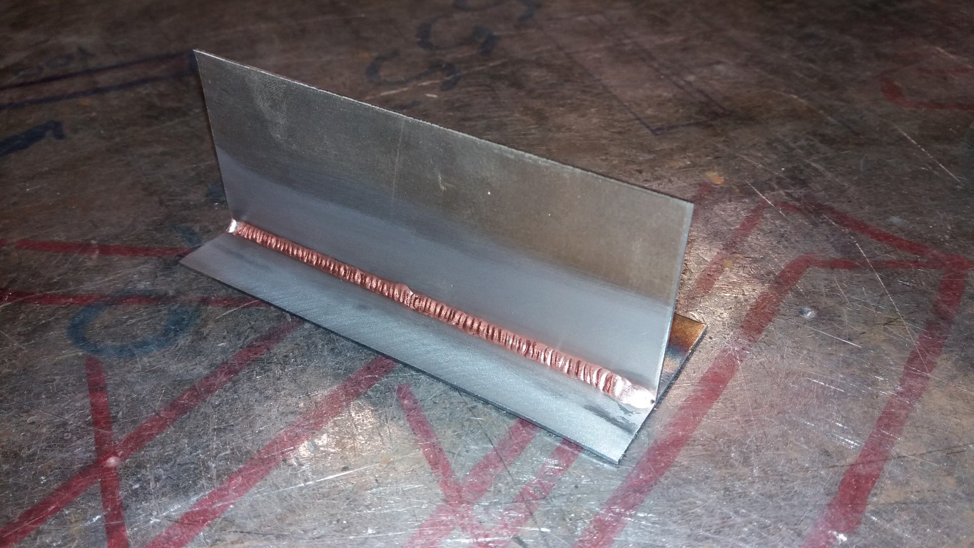

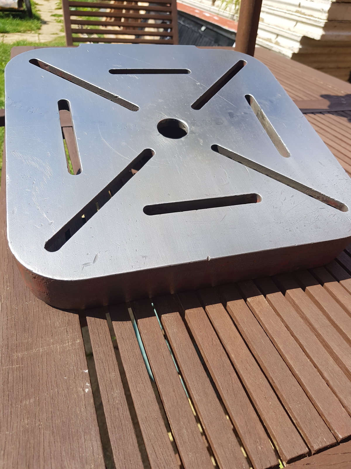

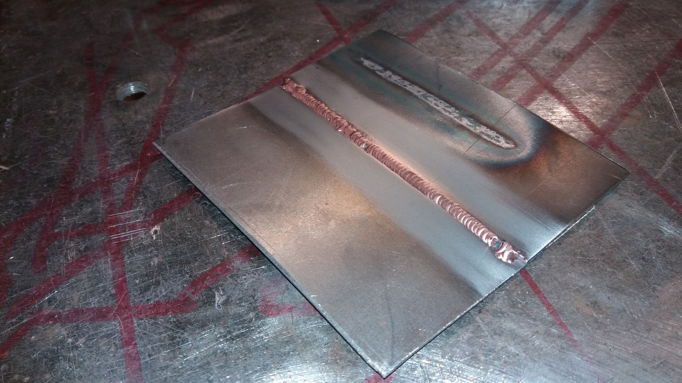

hi ,, id like to hear how you use copper electrical wire ,, im always up for something new to try , many thanks.I weld hundreds of cast iron blocks, water pumps, stoves and brackets. I use copper electrical wire and sometimes Monel welding electrons which I take the powder coating off and stainless steel 316 TIG rods, depending on application. Some casts weld well, some don't and metals don't fuse together...
