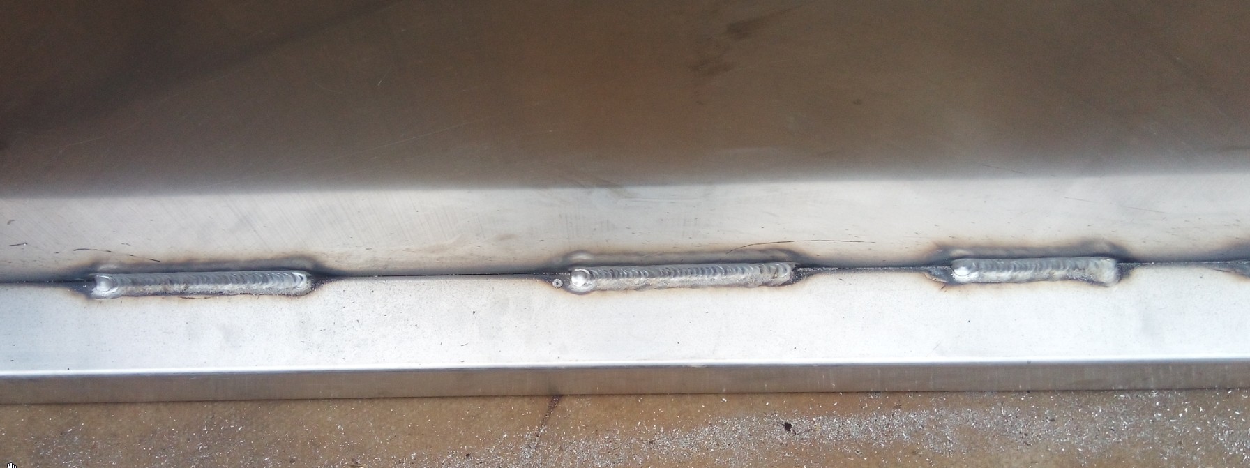

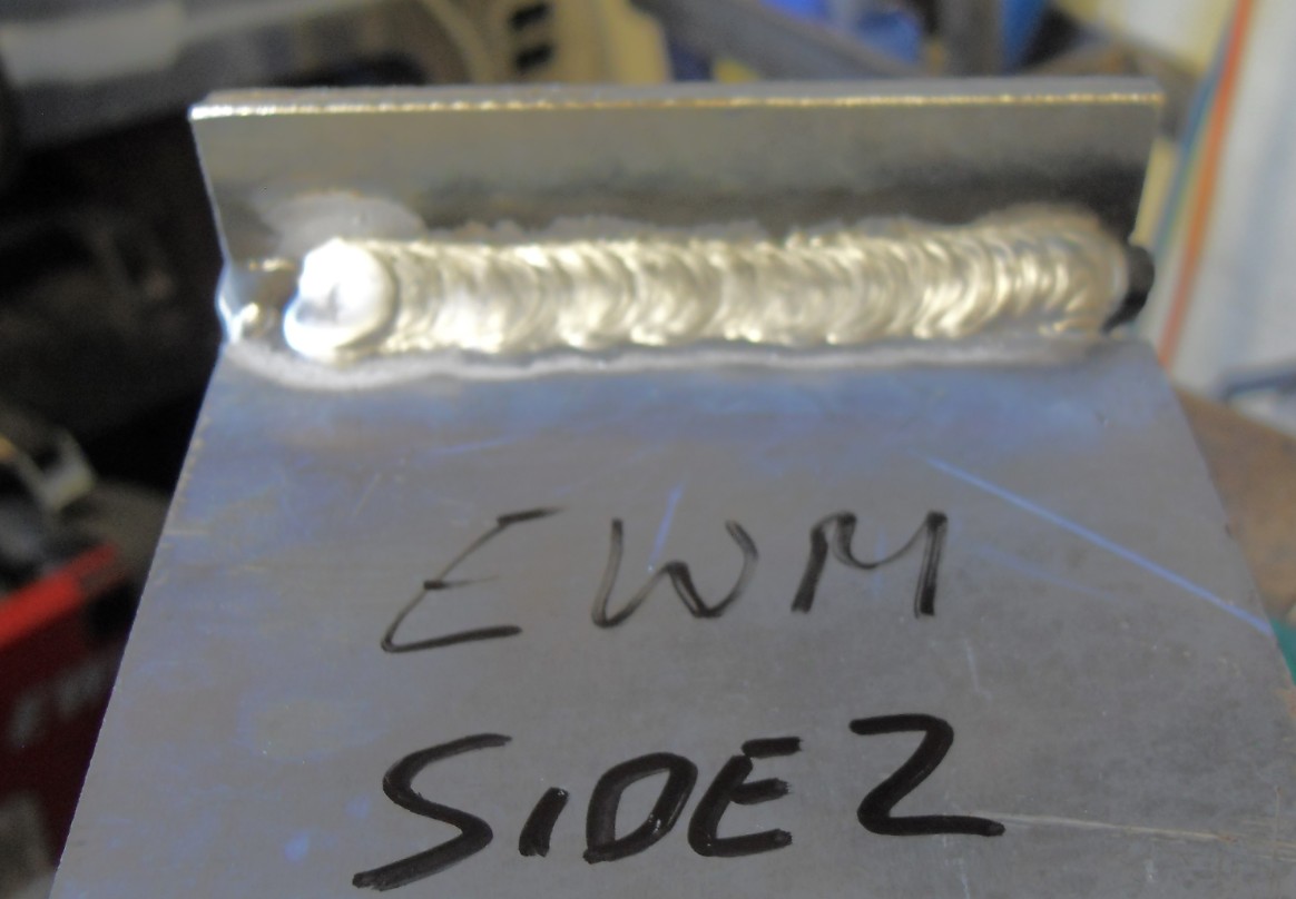

You must keep those ones for personal viewing onlyI think the EWM puts down a neater weld personally
Tacking with mig is 10x faster.any idea what the weld/travel speed would be with this compared to tig? on 3mm alu
tacking up must be a lot faster?
You've just not been paying attentionYou must keep those ones for personal viewing only

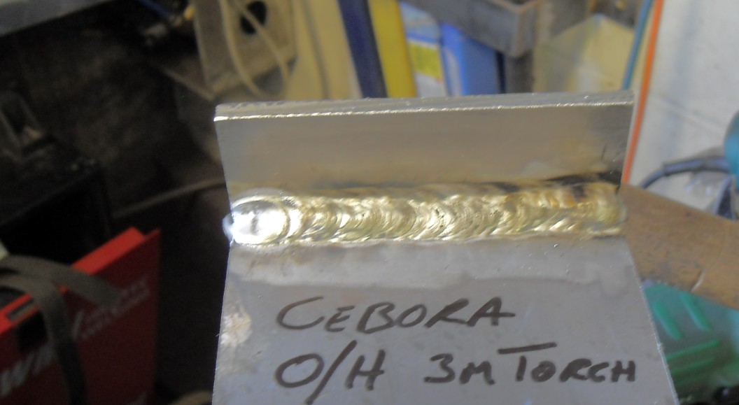

They are all very good but those recent ones with the Cebora seem to look incredibly neat for mig. I can’t alu mig weld like that. Never been that neat. It’s obviously a quality machine in skilled mittens.You've just not been paying attention

It does seem nice for the limited tests I have done with it but really it is too small for me as a main welder and I was thinking it would do me as a standby second welder, tomorrow will be the big test for it.
I nipped up to Dundee this afternoon to get some wire and a teflon liner for the 4m torch and also some hose to make up a longer gas line.

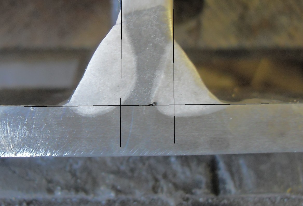

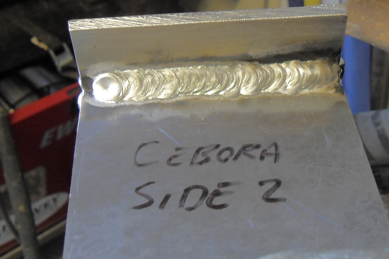

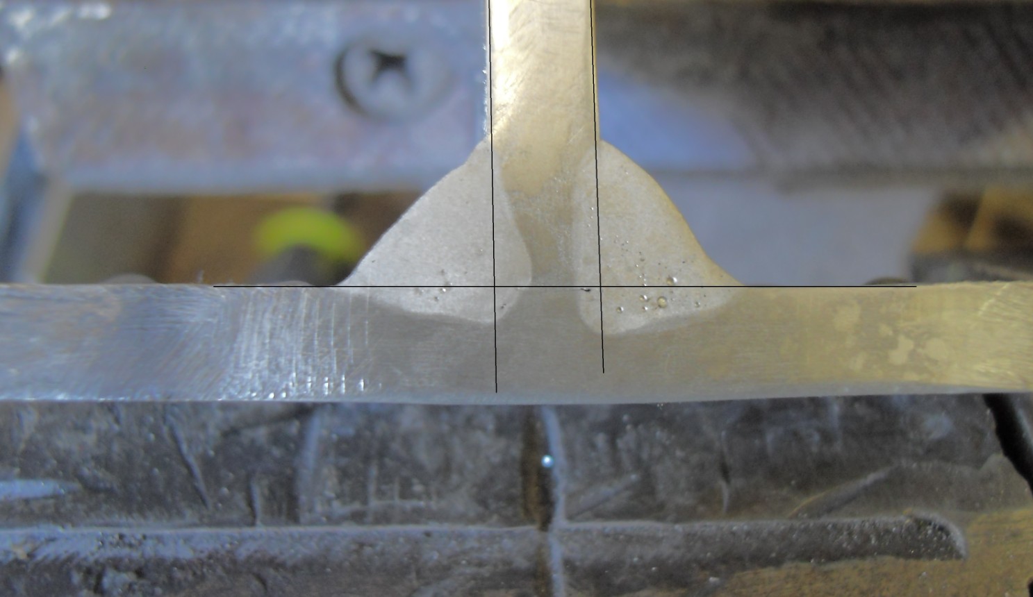

Well some good and some not quite so good news.Test it as long as you want
There is only one lacking pen in the corner from what I can see. Probably a direction thing more than anything else.
What is crystal clear and more concerning is the amount of worm holes in the bottom section. Far more than I’d hope to see. (You’ll always get some)
Dunno what’s causing that but it’s an investigation job.
Face sides look great mind. Nice welding there hood especially considering the position you did them.
