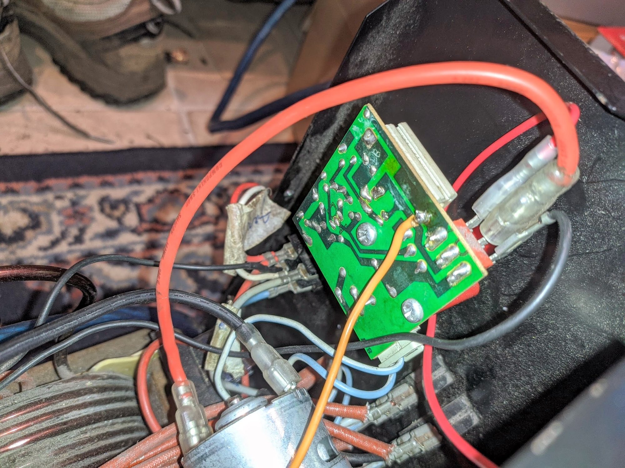

I bought a non working sipmate eurotorch conversion for £60. The seller had fitted a 4m torch. I wasn't sure if it was the sipmate or the 4m hose causing the issue, but I have fitted those parts to my cebora with a 3m torch. I have the 4m torch to compare against once everything is working.
Was inspired by this thread as I've got an old Snapon that had a damaged wirefeed and also the torch had seen better days so it made economic sense to convert rather than buy a new system.
Ended up buying what was linked above on ebay, the motor is a lot beefier than the Cebora.
Bought a £3 24v Chinese solenoid and connected it to the PCB where it gets from 22-26V depending on what setting is used, I initially wired it in parallel with the motor but it only activated at max speed, on the slower speeds it was only registering around 11v.
Not sure how long it will last for but if it does break I'll probably use an automotive solenoid as you can get them for a couple of pounds secondhand from a breaker.
Hope this is of help for anyone considering doing the same, total cost for the conversion was around £35.

Your Eurotorch conversion looks great. It seems that you used some laminated UPVC as an insulating mounting for the wirefeed assembly, and also as a shroud on the threaded brass block and the hole in the front panel of the welder ?
Don't forget to turn the gas off at the cylinder when you finish welding - I'm not sure I would trust that solenoid to shut off fully.
