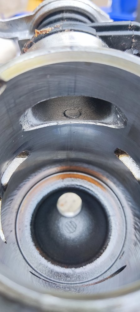

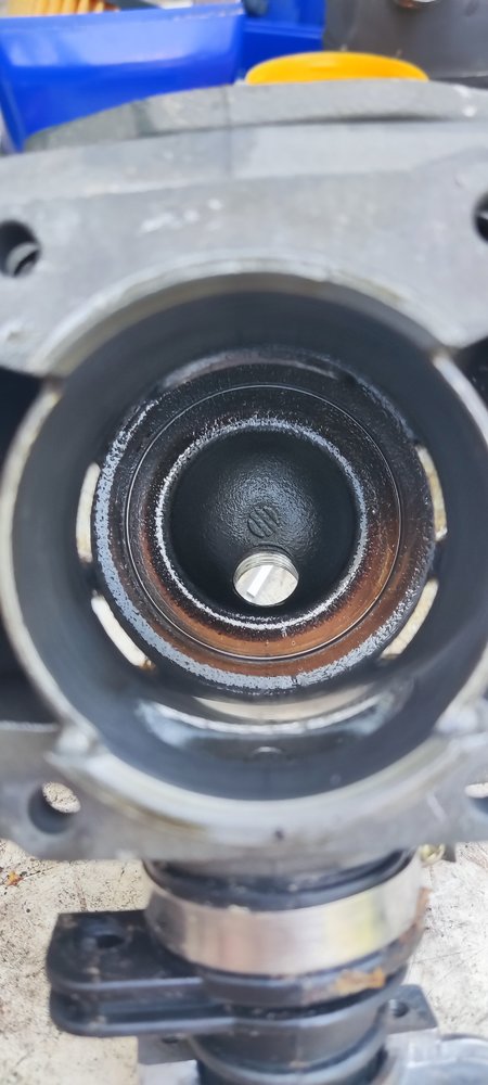

Thats the decompression port hole

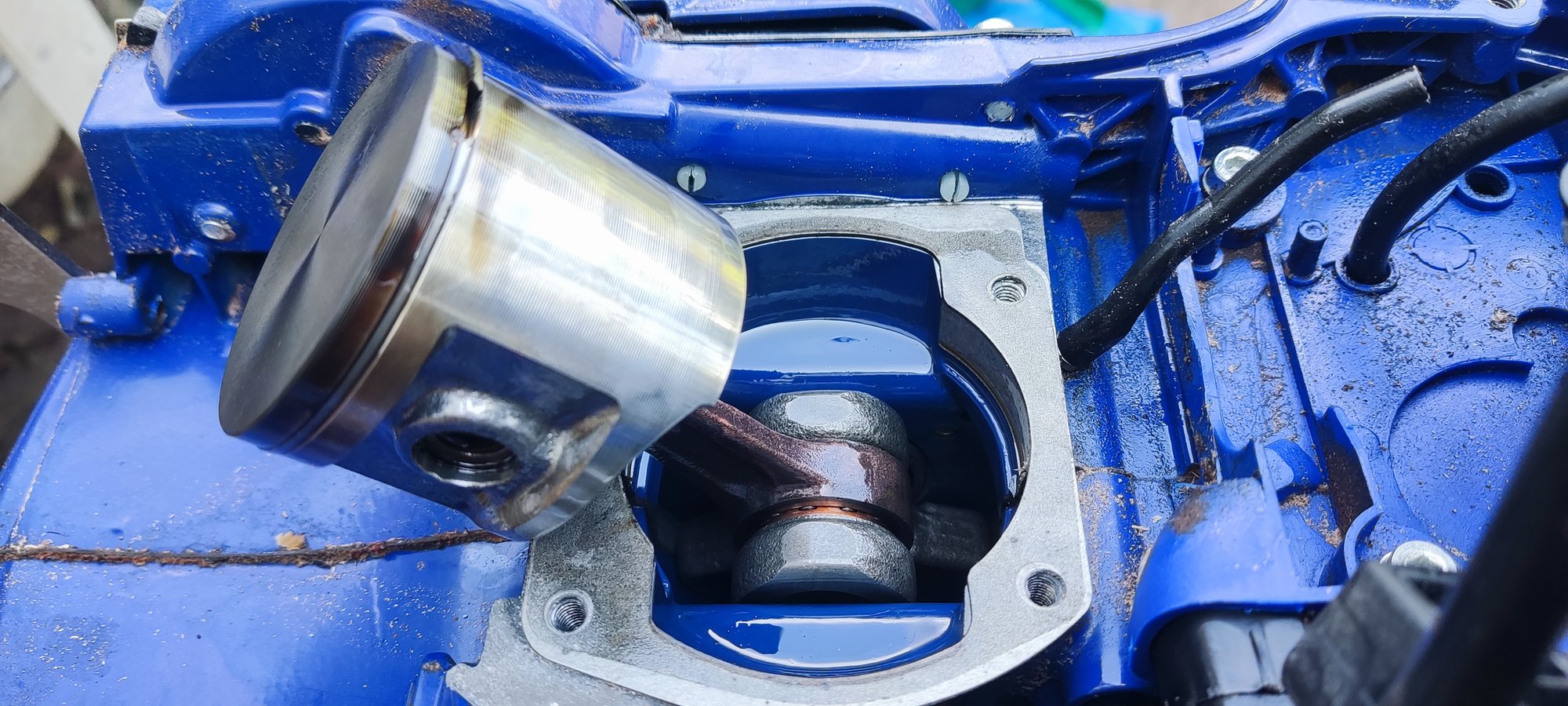

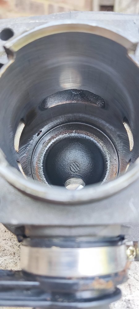

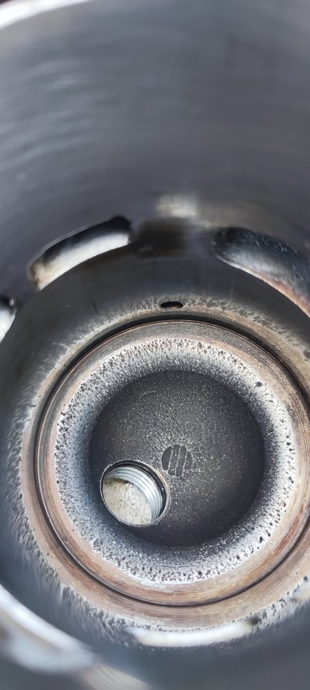

I'm pretty sure I put good branded bearings in my Stihl saw when I rebuilt it and as for those lumps on the combustion chamber roof I'd carefully grind them down because as you said they might become hot spots and cause pre ignition.So could one of the more experienced here answer these:
1) use the needle bearing or source a branded one, or reuse the current one?
2) any adjustment to the roof of cylinder, the lumps visible in second pic.
It also appears to come with crankcase gasket and crank seals, but afaik theres no need to touch those for this task?
To be honest tho it would make much more sense to me on roof of cylinder because I dont see it on the side and always forget to press it, and then the piston rings wouldnt go over it.

Likely due to short runs, I imagine it would have cleaned and burnt off a lot of it with a bit of use. Perhaps my mix was a bit rich on oil.RE carbon buildup- what oil do you use?
I use Stihl HP Ultra which is supposed to help with reducing carbon deposits but I've never had one apart after running on it for a significant time to confirm myself.
