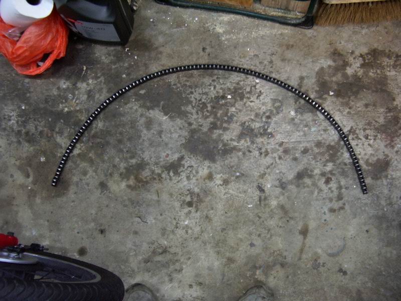

Its wear and bedding in not stretch.Nope they do stretch.
And cheap ones especially on ms200 seem to be the worst for.
Check a new one no play in links. Check one you think has stretched and you will find play in each link.
If it was stretch then each link would be longer and no play.
