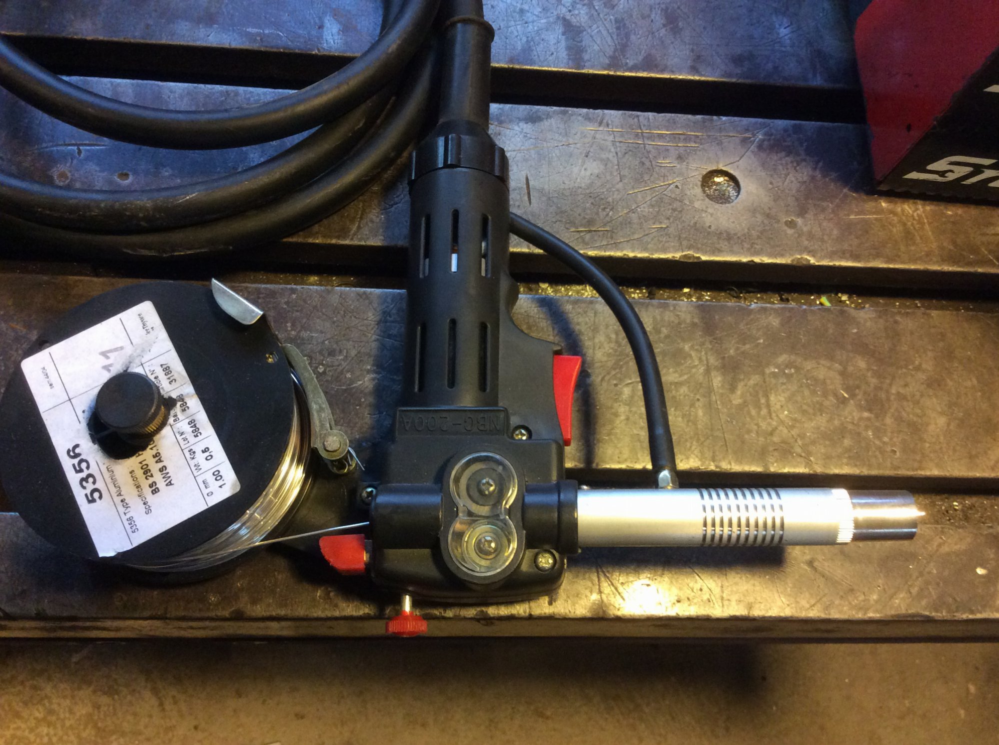

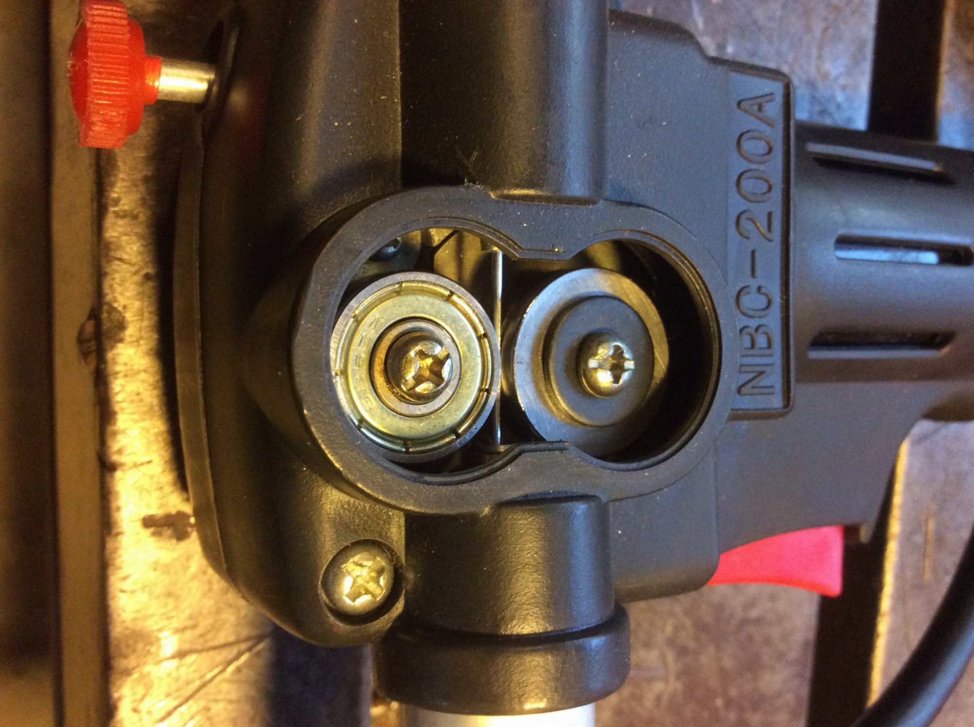

I took it all apart, and, it doesnt look that bad. There is only a groove in the lower drive roller so i cant see misallignment being an issue.
The motor and mechanism body itself is of quite good quality. Thye nozzle part is less impressive, i guess it remains to be seen how it will fare.
on one of these pics you will see where the gas enters the nozzle. Apparently the nozzle gets very hot and melts off the plastic gas pipe pretty quickly when in use.
So im trying to think of a way to have the gas line be metal or some other heat resistant material.
I created a spacer so the unit will accept normal 0.5kg rolls of wire.
I reckon Im going to need to figure out tips, chances are I'll be going through a lot of them.

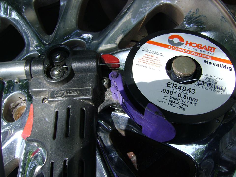

This has the other, gear style rollers like to the miller pic above. The wire grooves are offset, and different wire size without flipping rollers? assuming it works. If it doesn't, I can turn a new one on lathe. Needs adjustment for normal 1kg spools.
Have not used it yet, but much higher quality and design than the LTS 65 quid gun I destoyed (plastic gearbox.. bent).
