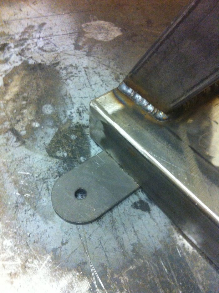

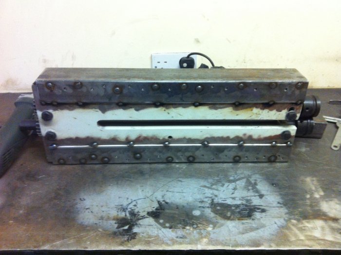

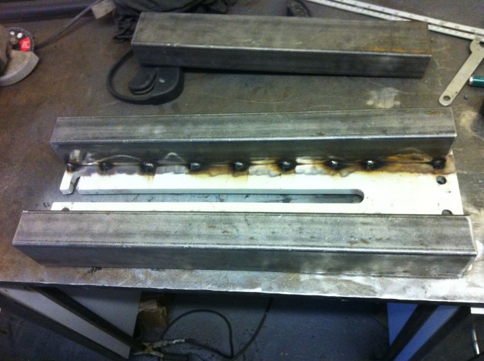

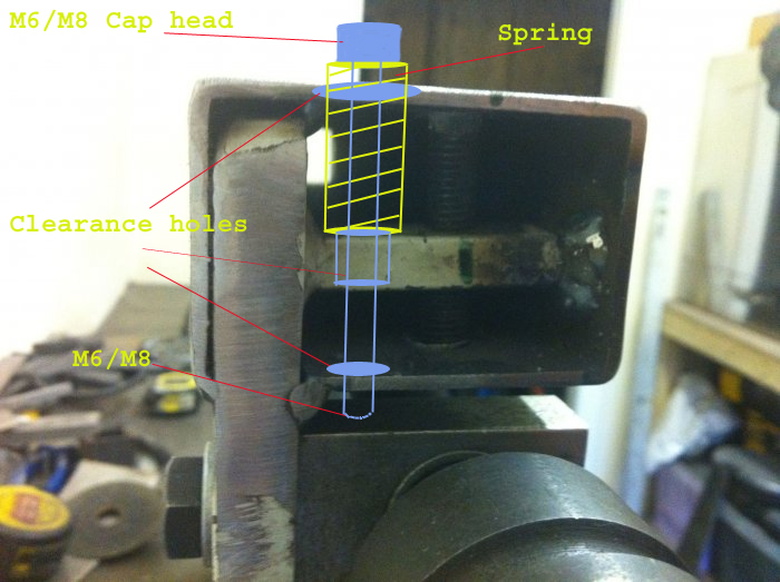

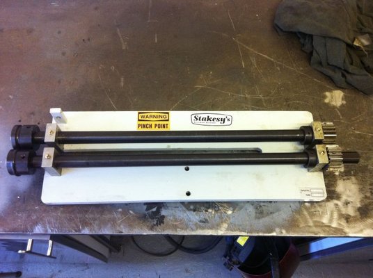

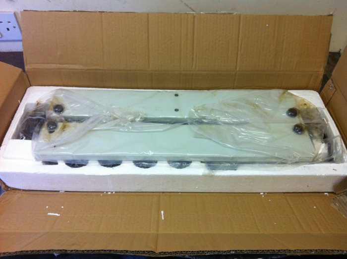

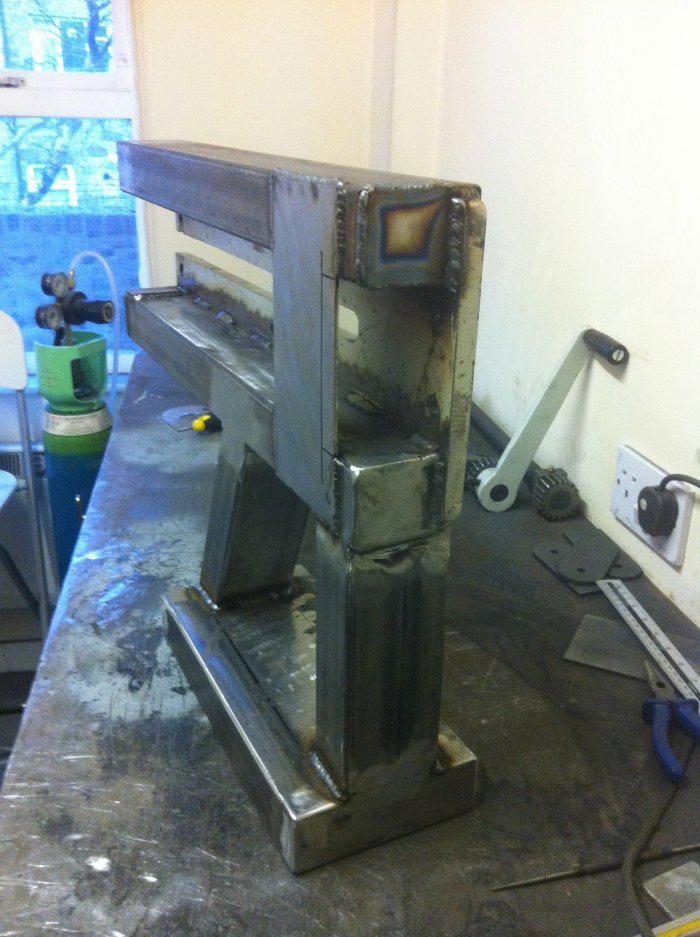

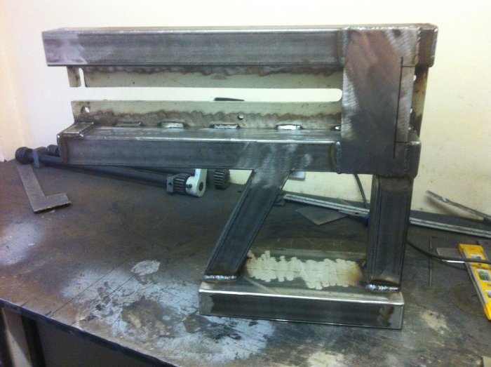

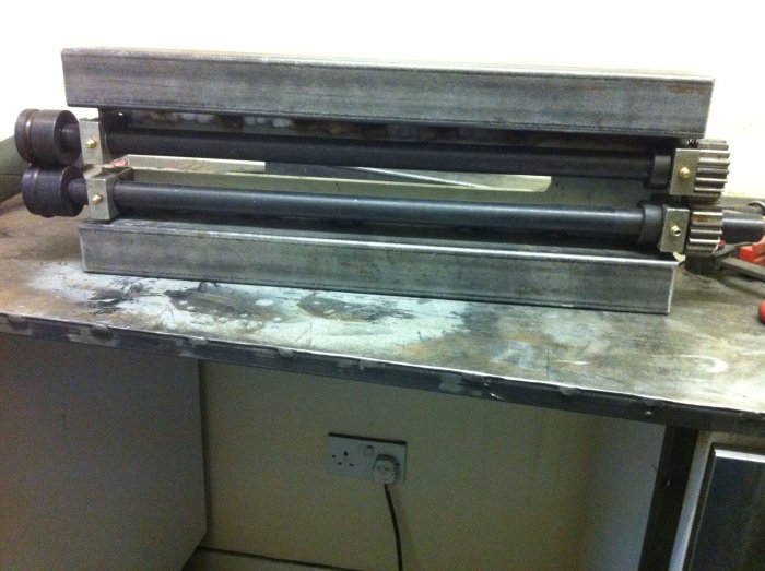

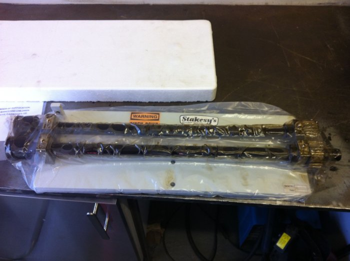

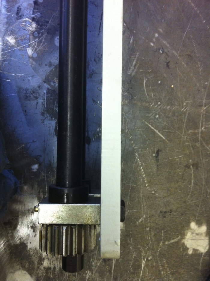

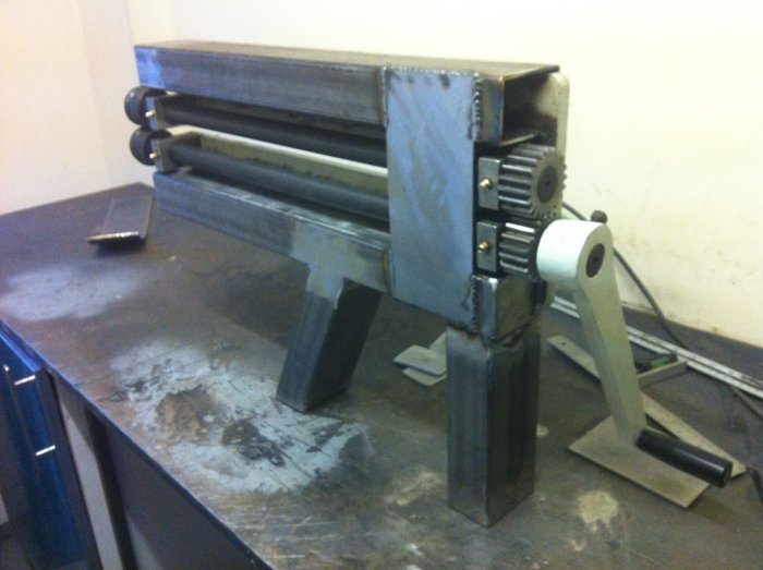

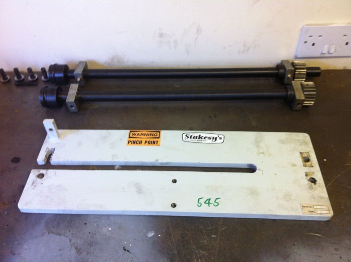

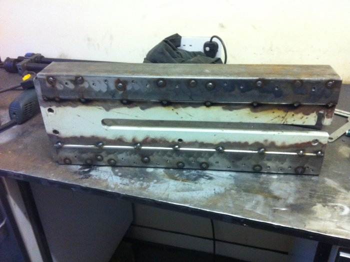

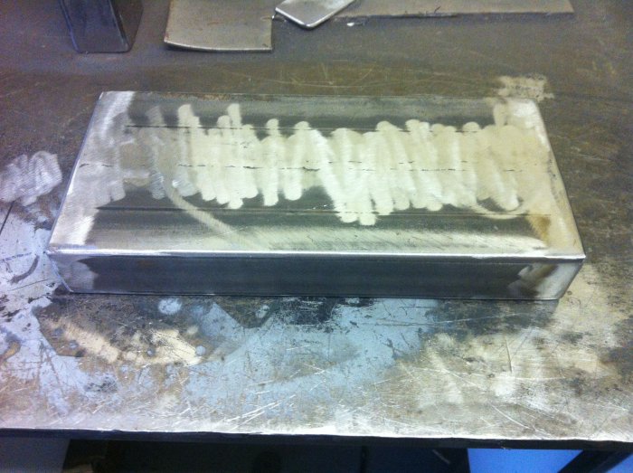

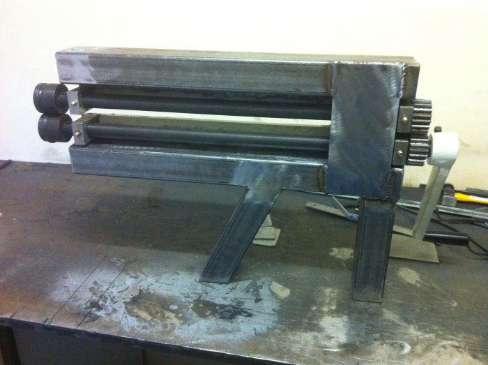

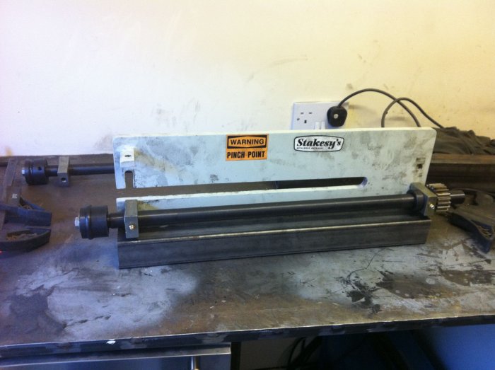

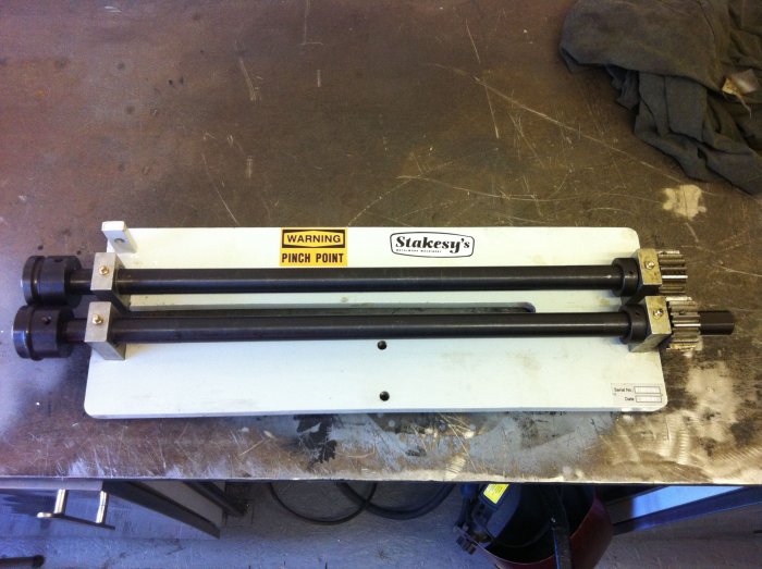

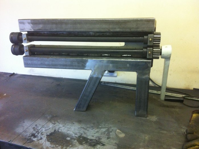

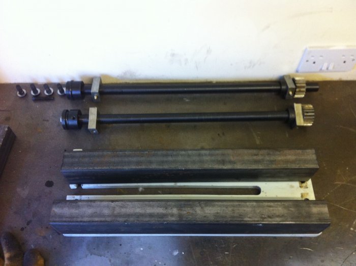

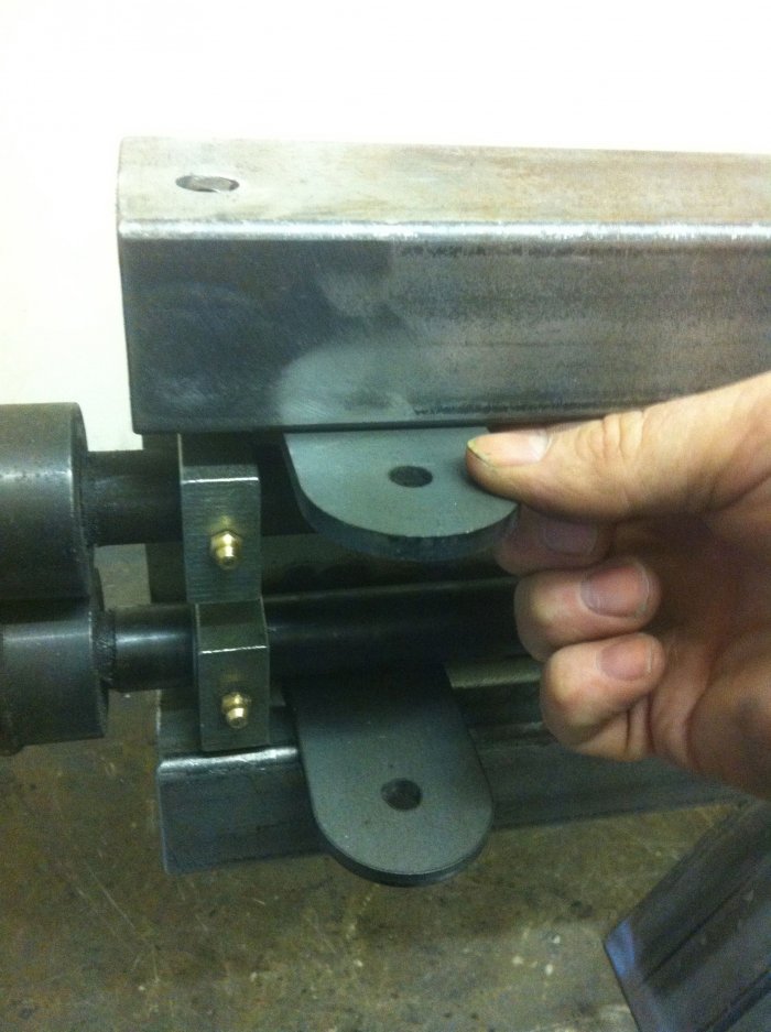

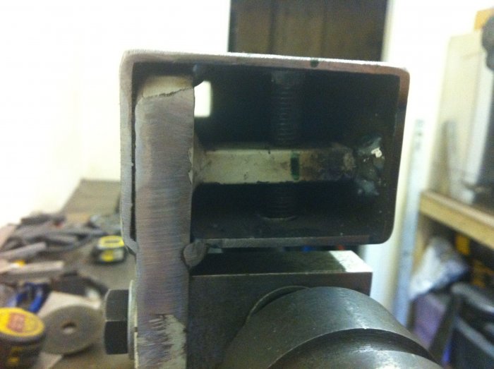

Okay so this has been done a million times before, so make it a million and one. While I'm waiting for the paint to dry on my English wheel I thought rather than watch it I'd modify a HF style bead roller and see if it will do what I want. I bought a Stakesy's bead roller and it's quite good for a cheapo; 14.5mm plate and 25mm shafts. At this stage all I'm doing is stiffening the frame and welding on a small stand and a clamping arrangement for it to clamp to a bench. May look at other upgrades later. Also is it worthwhile bolting the box sections together for a bit more rigidity when I don't need the big throat but rolling a thick sheet, that's one reason why I made it the way I did so I could if it was worthwhile.
Anyway enough of me rabbiting on, some pics of progress tonight.
