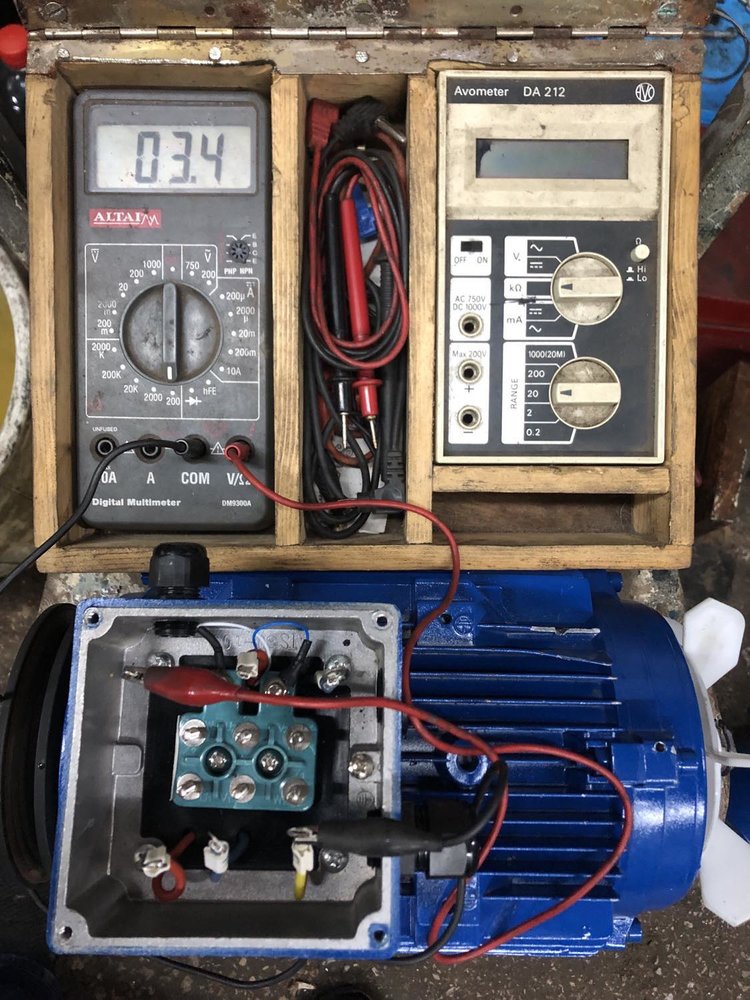

Yes!Ally air flow fins/channels that are broken on the motor case. Is the damage negligible?
Will just straighten what I can then and paintthe motor won't get hot enough in normal service for those fins to make a difference e
verry it will make no oddsAlly air flow fins/channels that are broken on the motor case. Is the damage negligible?
Boxford model 'A'Of course, the 2HP output might be important - depending on the lathe.
If it is a myford ML7, or similar, it is possible to break the lathe! If under-powered it might be a bear in operation.
Right, always learning. I didn't know a motor wired in star could be used with 230v. Thanks.Running a 2HP three phase 415/240V motor in star configuration, with a 230V VFD, would provide around 1.2 HP. Likely a good fit for that lathe?
You generally turn down the frequency to 29Hz to keep the V/F ratio correct.Right, always learning. I didn't know a motor wired in star could be used with 230v. Thanks.
29Hz comes from (240/415) x 50Hz.
