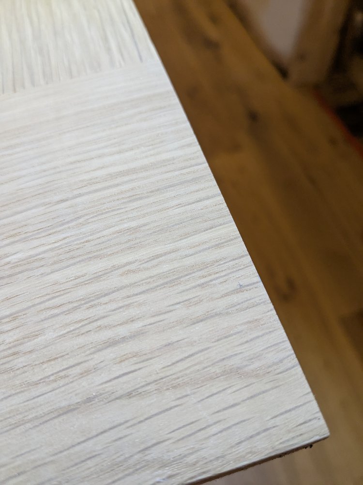

80 tooth,masking tape both sides of the cut,raise the blade up so its just(2mm) or so on the bottom,gentle push
If you don’t want do make multiple passes this is the way to do it; I’ve had good results this way myself. Maybe I’ve just been lucky, as I’m a bit of an amateur when it comes to wood bothering!
