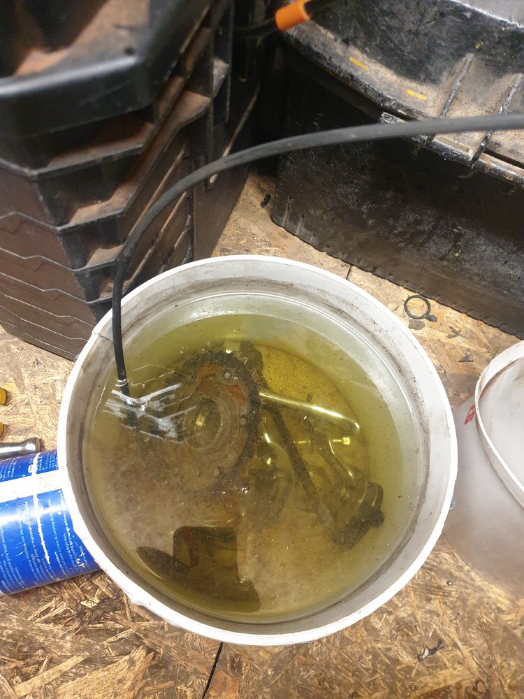

Not been mentioned but best to use a plastic container for the process. No point in using the cleaning power of the citric acid to clean a rusty bucket!
I filled an old deep fat fryer with a citric acid mix (not too strong) and used it to heat the mixture & the parts up to 70 deg c before leaving the parts in overnight to be cleaned.
It worked very well but the chip basket started to dissolve after a few days! It wasn't stainless steel but chrome plated mild steel! I left the mixture in the stainless steel tank for a month or 2, thinking it was safe - it dissolved the heating element in the bottom of the tank!
Lesson learned - only store it in a plastic container!
It will dissolve aluminum, copper, zinc, brass etc

That pic was post stir, I did wonder about the flakes sticking
Not if you leave it to long.Why is it the base ingredient for coffee machines then? Together with sodium percarbonate. It won't dissolve copper but will dissolve zinc leaving brass with a copper colour, which is easily removed.
