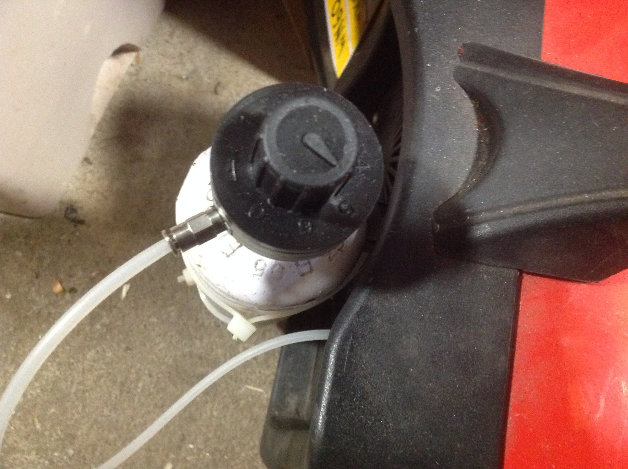

would tell youThat’s great that you’re getting there it will be miles cheaper to get a pub co2 bottle but it’ll mean you have to get a new regulator. The welder you’ve got has a gas solenoid so if you turn on the bottle then flip the wire feed roller off when you press the trigger you should be able to hear the gas coming out of the shroud. You should be able to weld 3mm ok on max 2 might just have to move a bit quicker but as I have said I’m not an expert give it a go and see how you get on. Graham.Thankyou to everyone, looks like I failed to do the obvious , clean the metal well. I managed to get a co2 gas bottle and tried the gas option with the electrode connected to the positive this time. I noticed this seems to give a better result for me. I think you guys would definitely reject the results, haha but at least I,m up and running now. Could I ask if the strongest setting on this welder max 2 , would this be too much power for 3mm mild steel. Also I've bought a co2 gas bottle and I have the correct value regulator ( bought it from clarkes ) how do you release the gas from the bottle, is it just released by turning the regulator knob up ?
