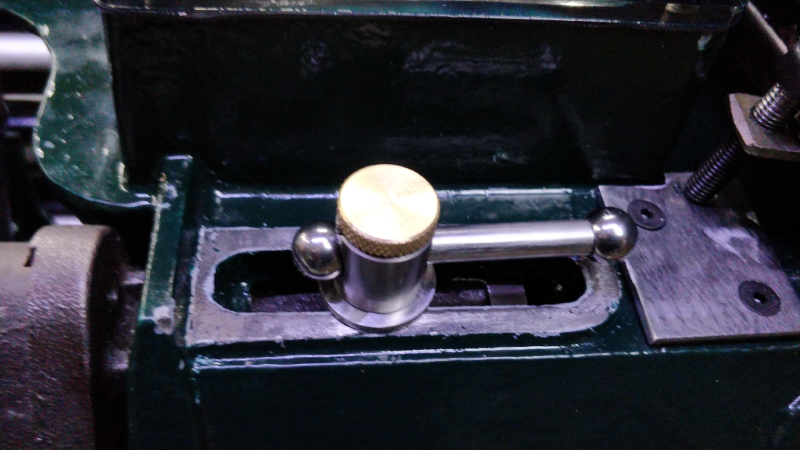

Cut a window in the old plate you took off to place over the Perspex, it will clamp the gasket better.
A window above the oil level would work and you could peer in with a torch to check level...also another idea would be to keep the metal cover intact and before you remove clear cover why don't you drill a small 6mm hole in the top of box and use measure a dip stick to keep an eye on oil and the hole could be bunged back up with a bolt and PTFE tapeI did see that post @roofman. The thing I particularly liked about @Wallace's idea was that it avoided the need for any epoxy/other glue: just using the plate as a clamp. The oil level when the bandsaw is at rest is right at the bottom of the window, so the glue joint would be about where the rubber gasket is. Having worked in a high-volume but high reliability product design environment for a lot of years, I also do everything I can to avoid glue joints anywhere where a joint failure would cause a big problem...

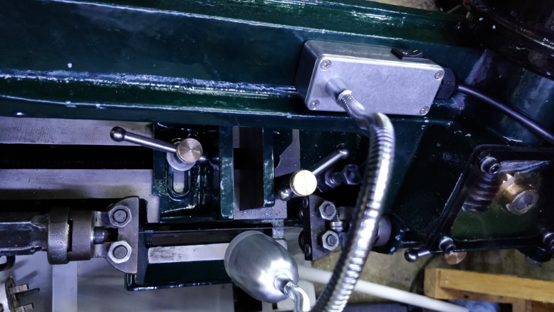

Okay, don't try this at home kids... electrickery is dangerous and all that.

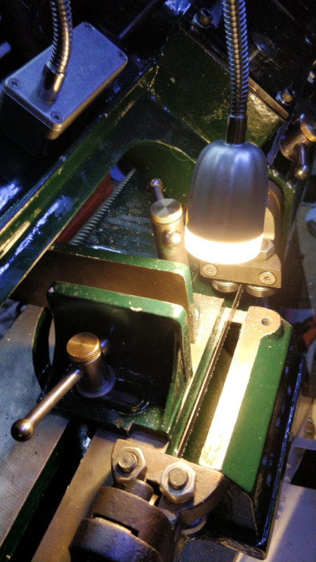

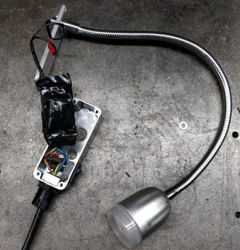

Today I added a light to the bandsaw. I bought one of these from Lidl:
I would have preferred cool white rather than warm white (easier to see details by), but it was cheap and beggars can't be choosers.

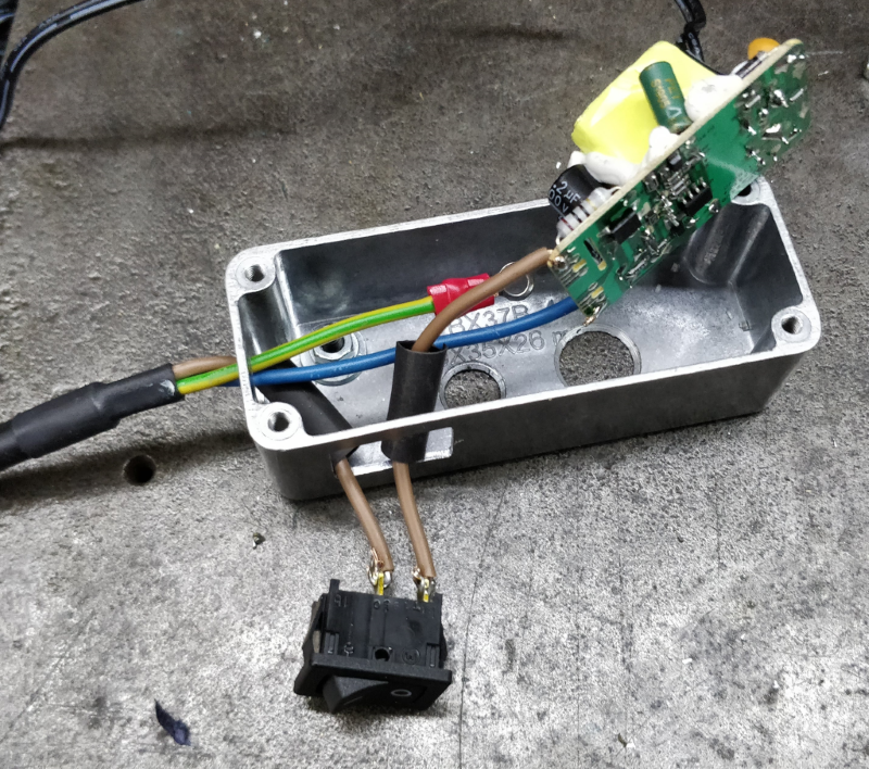

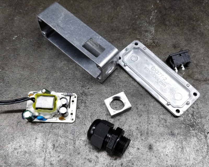

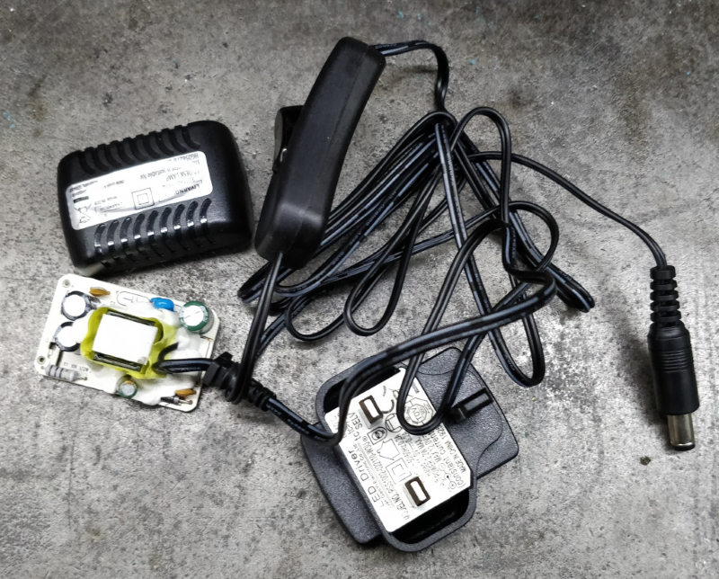

The lamp itself was easy to get apart (three screws in the base and a fine thread 8 mm nut). I dismantled that and then attacked the power supply:

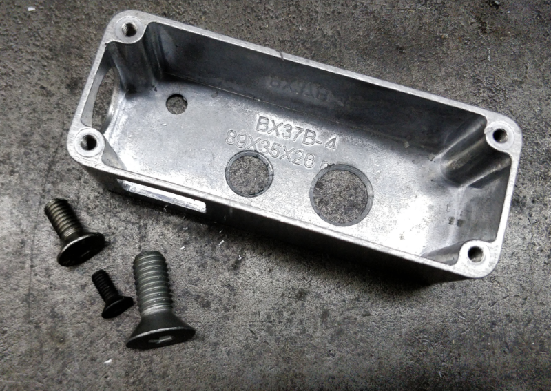

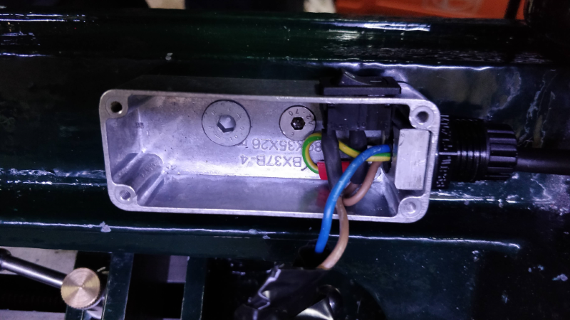

Got another little aluminium die cast box and made some holes in it. Bit of an odd assortment of screws as they're designed to fit into holes that are already in the casting (designed for the blade cover interlock) so I worked with what was there:

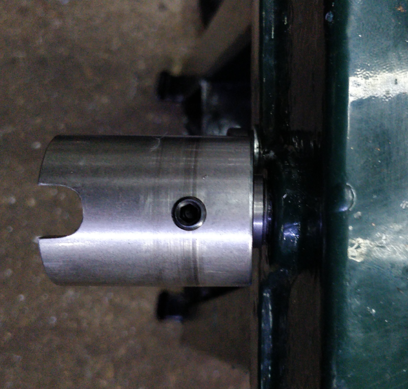

I also made a custom nut from some 8 mm thick aluminium to replace the one that came with a conduit entry:
Then I started wiring it up:
Then I put the heatshrink over the switch contacts and applied heat. Then I realised I'd forgotten to thread the custom nut onto the wires.
So off came the wires again and I did it again. The screw in the top-left of the picture above is an earth connection.
I wrapped the power supply in about 8 layers of electrical insulation tape to isolate it from the earthed box and then soldered and protected the connections to the light itself:
The switch box housing then got mounted on the upper arm of the saw:
and here it is closed up:
It's alive!
The power is fed from the existing connection box I described back in post 88. I didn't take any photos of the new connection as it really isn't that interesting! I need to add a bit of extra cable restraint (using the other interlock restraint connection holes), but that's a job for another day.
I think this will be really useful for reading scales on rulers when measuring out for a cut. The light's icky and yellow (or "warm" as they call it), more suited for reading in front of a fire than doing metalwork, but I think I can live with that on a bandsaw.

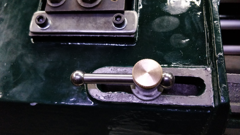

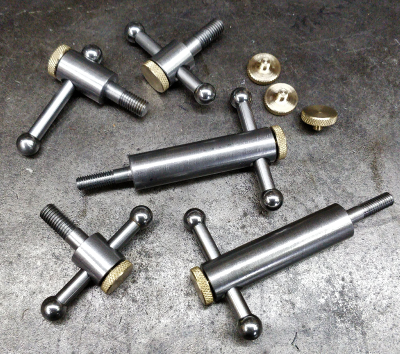

Don’t forget the cup holder.![]()
How did you hold the balls to drill them, er collet?
