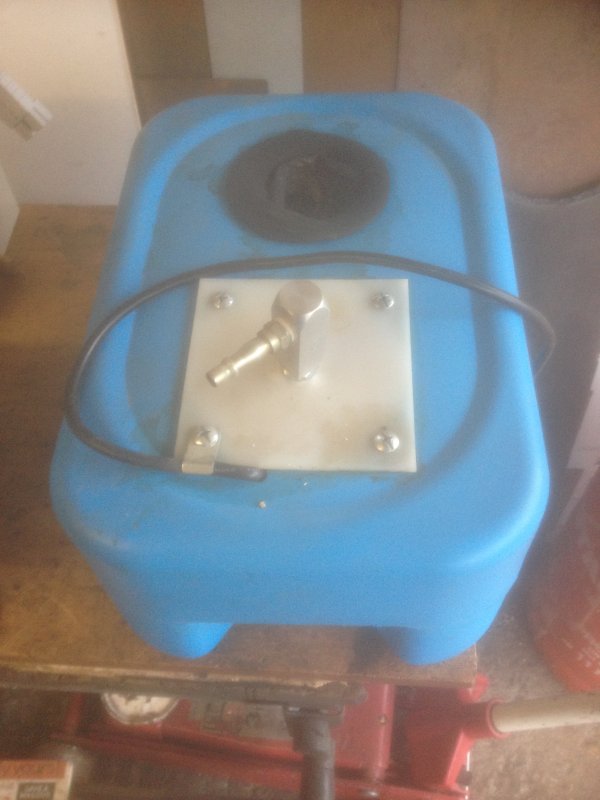

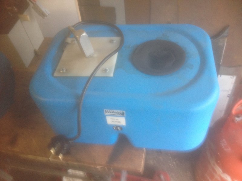

think the coolant tank is 9 litres and it dilutes 25 parts water.

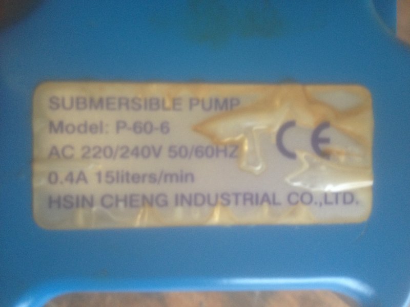

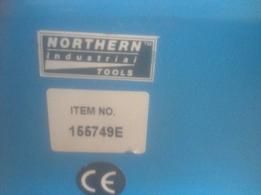

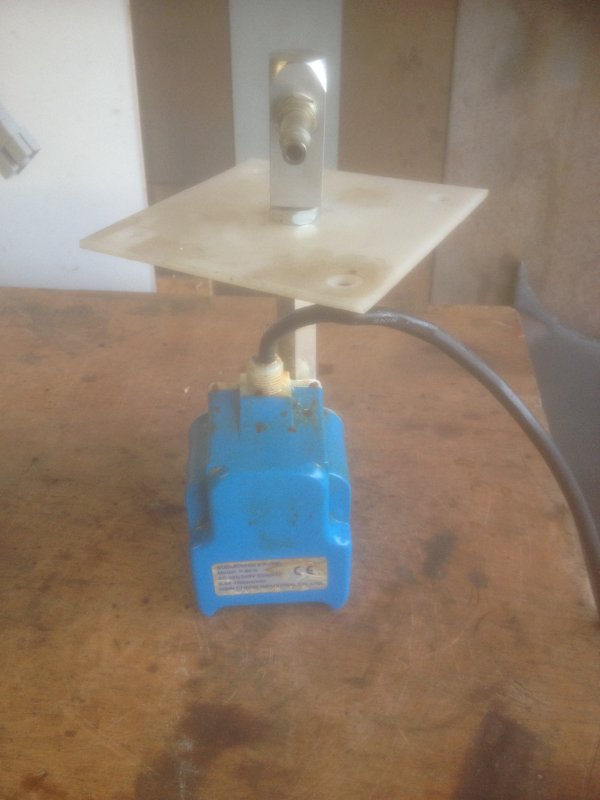

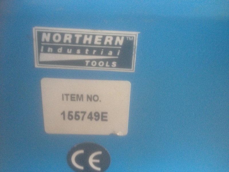

i took the pump out of the tank,
so i could give the tank a good wash out and also get a pic of the pump and its label for you.

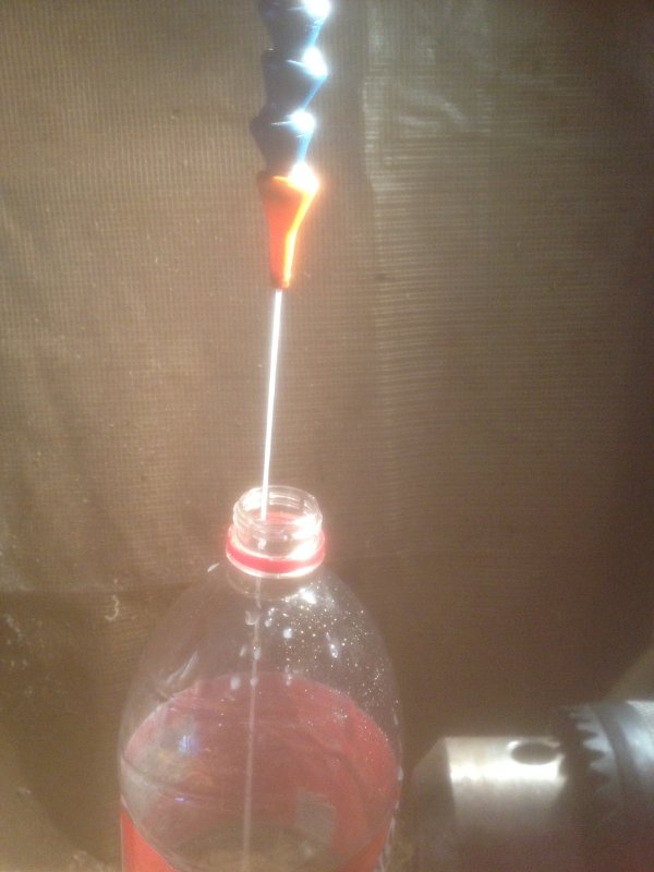

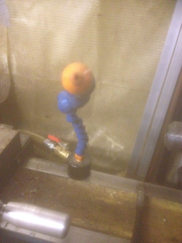

i have the small nozzle on the end of the pipe for the lathe.
i find it lets me have a strong jet, yet not alot of flood everywhere.
good when drilling etc.

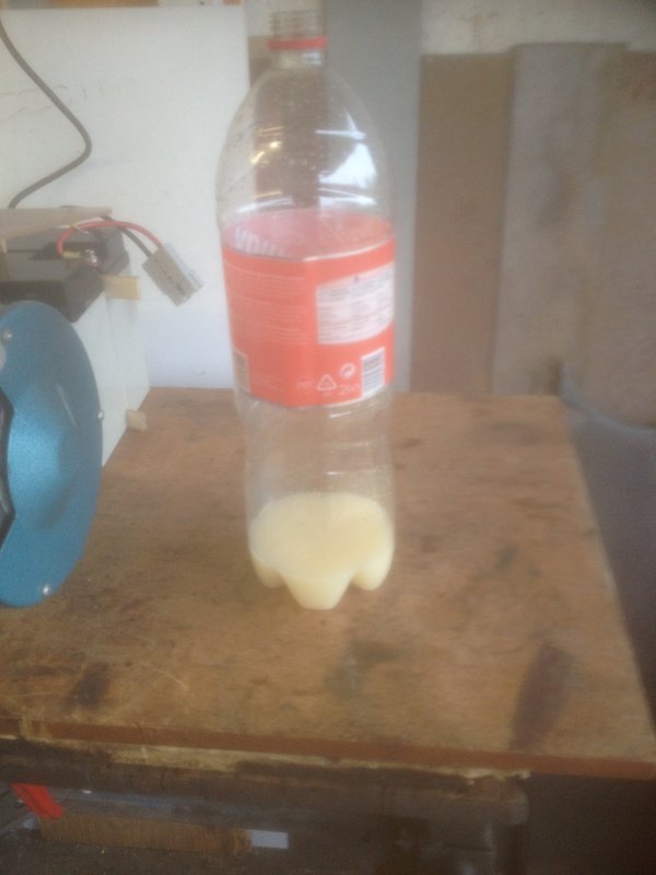

with the small nozzle i let it run fully open for 1 min into a 2ltr bottle.
wasnt a lot TBH. but with the small nozzle i didnt think it would be.
the pump says its good for 15ltrs a min.
but i would think the end nozzle would have to be the big one that came with the pipe
hope this helps.
