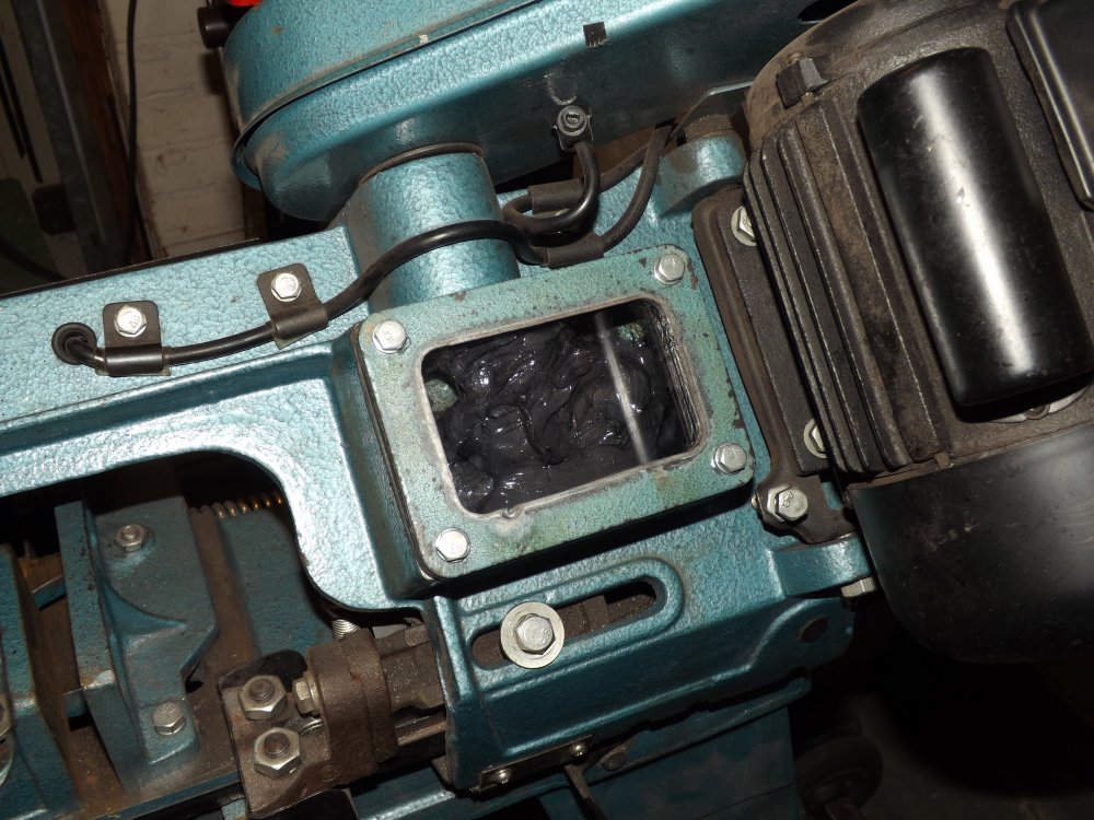

Worm & Wheel Gearbox Lubrication.

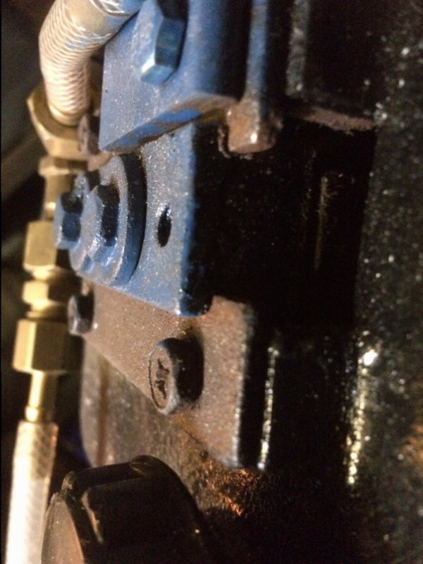

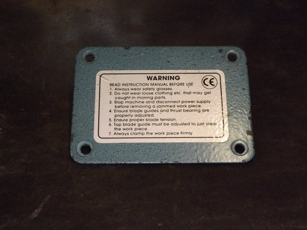

I noticed in the past couple of months a build up of dirt and oil accumulating on the guide rollers and blade so assume the gearbox seal is weeping. Sure enough on checking the gearbox oil level has dropped a little so I decide it was time to switch over to moly-disulphide grease. Whilst the cover was off I made a sight window for inspecting the gears.
Before.
Add a hardboard template for the plasma cutter.
Deburr and bolt back on with a sheet of Lexan so you can see what's going on inside.
