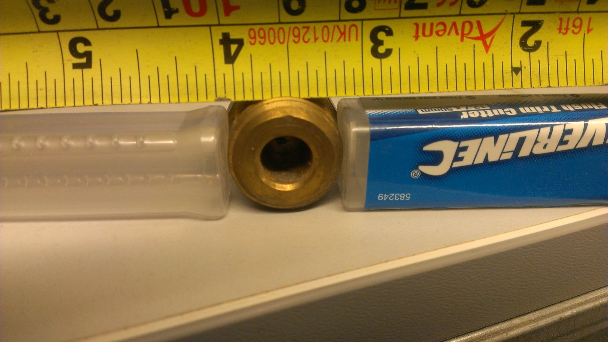

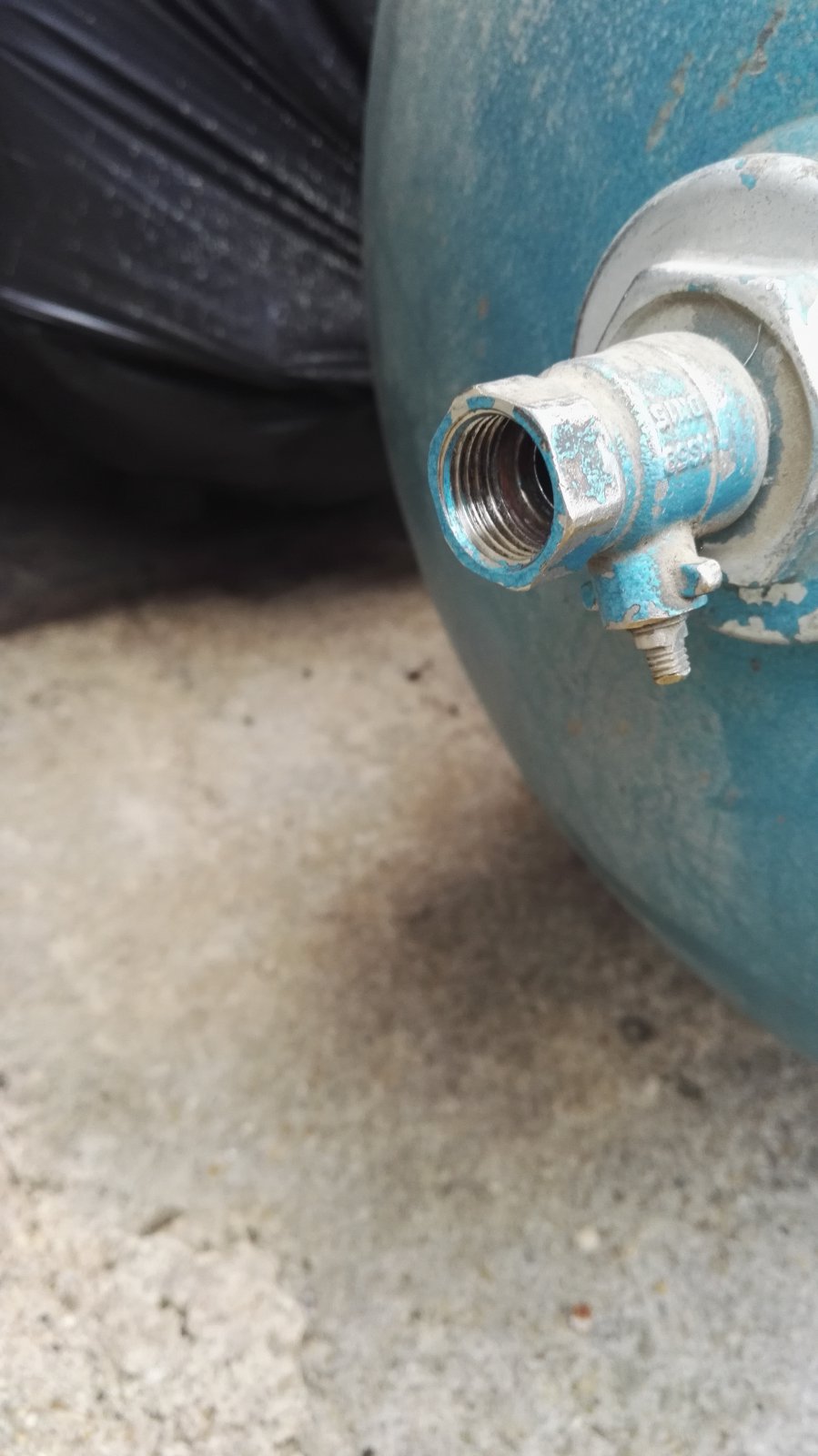

I.ll take some measures when I get back home! ThanksGoing by the size of that valve in relation to the thred for the missing handle that is probably a 1/2" bsp measures approx 7/8"View attachment 89029
I.ve measured partway.....which is just a tad over 3/4 as measured exactly 3/4 should be 1.905 cm
did you measure partway along the tape or from the end? if from the end did you have the slidey bit pushed in or pulled out
ExactlyBsp stands for BRITISH STANDARD PIPE .
the measurement will be imperial not eurotrash
Exactly
Remember this will be a taper thread not parallel as you would find on a standard bolt.
