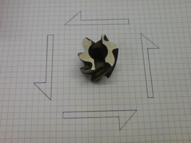

I think that but next time I cant remember..lol I might just find a nice diagram and print it out and laminate it.Necro-resurrecting my own thread...
I thought I had it, way back in the 2017s... was just watching a blondihacks vid on youtube tonight and I was convinced she was wrong, so revisited this thread and realised that I didn't even learn my lesson back then. I've still been climb-milling, albeit with very fine cuts
OK - cutter rotates clockwise, piece feeds front left-to-right. Hopefully got it this time.
Lefty-slightly, tightly-rightly. goosely-loosely. I thinkI think that but next time I cant remember..lol I might just find a nice diagram and print it out and laminate it.

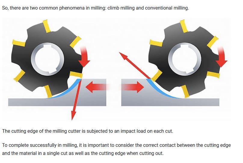

You mean light enough cut don't you ? Trying a heavy climb cut in a manual mill is asking for trouble.
I usually try to climb mill as a finishing cut, as the finish is usually better. Usually no more than .1mm or so.
If you look at the picture, you can see the left cutters chip is big to start with tapering down to nothing, the cutter wants to jump away from the work and chatters as that's easier than overcoming the steel to cut it.
