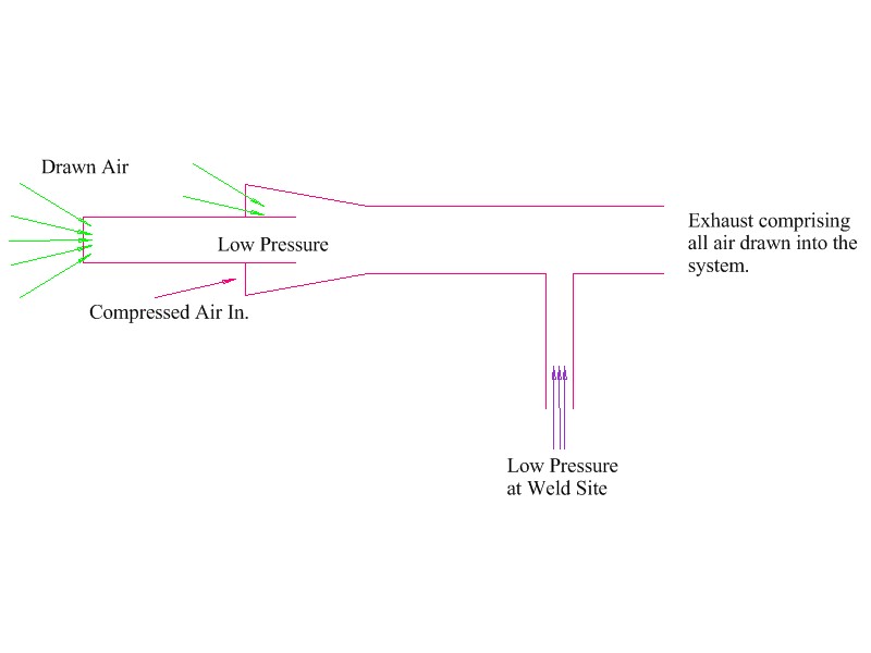

That's the ticket.So, like this? (excuse the bad artwork - best I could do in ten minutes!)
All the crap and nasty fumes are carried by moving air without touching the expensive fan. I know we are probably not going to be using it to the extent that any of those fumes would affect the fan. ?Why make a problem for the future?Why wouldn't you just use that fan inlet instead of the modified pipework?^^
Someone with a brain may be along soon, but I think the fan would move 'so many' litres of air through a system. That stays the same wherever the fan is, pushing or pulling. However, using that air movement to draw extra air would increase the extraction at the welding site.Yeah fair enough.i would prefer more suction myself but i see your point

That wouldnt add up to extra air removed from the welding site unless the fan inlet was utilised for fume extraction also,you would thinkCRB said:Someone with a brain may be along soon, but I think the fan would move 'so many' litres of air through a system. That stays the same wherever the fan is, pushing or pulling. However, using that air movement to draw extra air would increase the extraction at the welding site.

A lot of flux recovery systems are built in this manner, it's a very effective way to draw, if it pick flux up behind a sub arc run it will draw any amount of fume no issue.Someone with a brain may be along soon, but I think the fan would move 'so many' litres of air through a system. That stays the same wherever the fan is, pushing or pulling. However, using that air movement to draw extra air would increase the extraction at the welding site.
