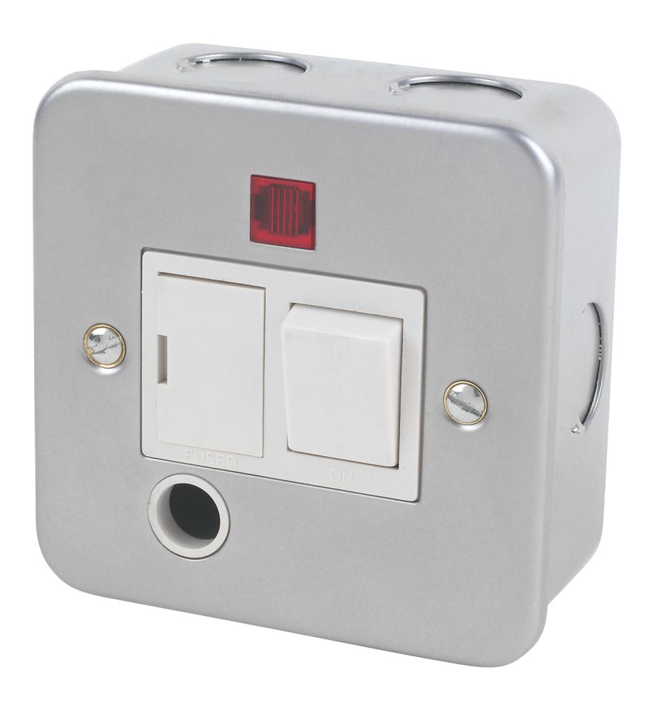

well your not likely to when the fuse rating is over twice the rating of the 13 amp .strictly speaking large supplies shouldnt be taken of a domestic ringmain but thats your choice if its on your own propertyI run 2 x 3hp compressors as I now only have single phase at home. They continually were blowing fuses on a 13a plug in a ring main. I removed the plugs and hard wired each one to a junction box within the same ring main and have never had a problem since.
That's what I was going to recommend, until I got to your post and read that this is what you've installed.Ok maybe I misled you. I am a sprayer not a spark. The junction box I refer to is like a fused wall socket but without a plughole. just a switch??
its 13 amp max. no diffrent to using a 13 amp plug or theres a 20 amp double pole switch or a 30amp both unfused ??That's what I was going to recommend, until I got to your post and read that this is what you've installed.
Not so scary, then, at first glance.
These are called "Fused Connection Units" or FCUs. What fuse size did you fit?
Edit: Like one of these (possibly without the Neon lamp)?
S'why I was wondering (but didn't explicitly say so!) why this was an improvement over the original fused plug.its 13 amp max. no diffrent to using a 13 amp plug or theres a 20 amp double pole switch or a 30amp both unfused ??
That would explain a lack of blown fuses...Are you saying it's similar to a fused wall socket with just a switch and no fuse? As BS suggests.
I like this description it's like triggers brush from fools and horses, he's had the same brush for years only had 6 handles and 10 headsAre you saying it's similar to a fused wall socket with just a switch and no fuse? As BS suggests.
, not the same at allThe correct termexactly like skotl picture with a 13a fuse and indicator. never blown the fuse since I installed it 6 yrs ago
