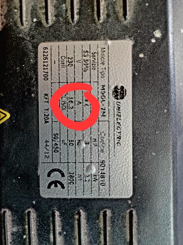

Just remember that adjusting the pressure like that is a one off, you need a separate air regulator to make the pressure suitable for any tools.
As I said above if the centrifugal is stuck on, the start winding is always powered and the motor draws extra current. This can damage the start winding, which was never intended to work for more than a few seconds and means the motor may not spin up to speed.
