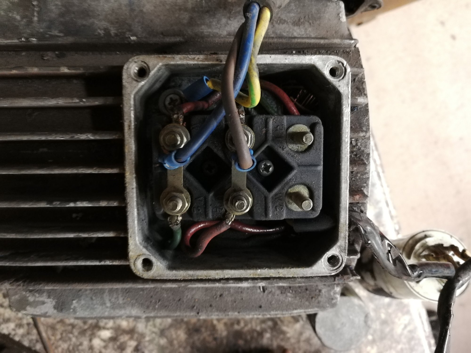

No idea, was surprised myselfI wasn't disputing the reading. Also seems odd to have two different valve caps in parallel, could they have been aiming for 35uf. On my old compressor 2800 rpm 2.2kw motor it had a single 40uf cap
Good find! Will read through.I'd check the condition of the joint behind the insulation but does look like solder on the outside.
Also found this not sure if it helps or makes things worse.
http://www.kenworthproducts.co.uk/acatalog/Emg Single Phase.pdf
Possibly current motor of similar size and power is EM BP 100L-2A which shows two caps one 40uf and one 20uf for a permanent capacitor single phase motor
Been thinking more and i reckon you must be right, a single cap of correct size was not readily available. I can't see any other reason for it.I wasn't disputing the reading. Also seems odd to have two different valve caps in parallel, could they have been aiming for 35uf. On my old compressor 2800 rpm 2.2kw motor it had a single 40uf cap
Thinking about it, last motor i wired up would have been 3 phaseIt’s a single phase motor, sometimes one of the connections is used for a connection for the capacitor but depends on the manufacturer the direction could easily be changed by changing the direction of the links from vertical to horizontal and moving either the live or neutral
