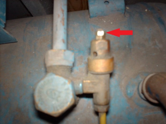

Some of you may remember from my previous post that I had an intermittent problem with my compressor. Sometimes when it would start it would begin to run, but then slowly stall before getting up to running speed. I would have to immediately turn it off else it would trip the fuse box switch.
I took the motor off and took it to a local electric motor repair shop. They said that the capacitor was breaking down under load and also changed the bearings on it. I refitted the motor and it started up great and was a lot quiter with the new bearings.
A few days later I used the compressor during the day, left it full for a couple of hours while I went out, came home, and used it, it then tried to start up but stalled slowly just as before. I have been using the copressor for the last few days, it has mostly been good. However, today it has stalled and tripped the fuse box a number of times.
I am not sure what this fault could be, I don't really want to take the electric motor off again because the bolts are fiddely and it seems to be lined up correctly with the pump now. Could it be that the brand new capacitor has broken down again?
When it had the problem before I took the motor to be repaired, I would check the pump and each time it seemed free. The air also seems to be dumping when the compressor cuts out or the switch is turned off and on. However, when it won't start up properly and I completely drain the tank it will usually then start.
This problem is starting to get annoying, has anyone any ideas what it could be?
