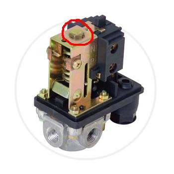

Hmmm maybe im trying to adjust the wrong thing then...
This is what im trying to adjust it with (red arrow points at it), it has a disk on to that twists with - <--- ---> + or something similar to that so just presumed it was for the pressure cut off adjuster...
Also this is what i presume is supposed to be the on/off button (blue arrow?)
Also on the rear it had a little arm that proturdes out slightly and when i lift this air is released when the pump is running but if the pumps off no air will come out...
Ok here are a couple of pictures of the thing i presume is a pressure adjuster cut off...
and heres what i presume is supposed to be the on off switch. Bother of witch im just guessing as it seems to make sense, but im happy to be proven wrong haha.
the bit with the disc is the pressure adjustment and on off switch but it looks like the cover is missing.
in your last picture the part on the motor that you thought was the on off switch is the overload cutout for the motor it will pop out if its overloaded you then just press it back in to reset
just looked at you other picture re the switch it looks like there is more then the cover missing the cable doesnt even connect to it.
if i were you i would go out and buy a new switch remove the old one and bin it
remove the old one then go to machine mart or somewhere similar take it with you and see what they, have you will notice a small pipe connected to the switch the new switch must have the option for the pipe. when the machine switches off the switch then unloads the pressure in the delivery pipe so the motor doesn't struggle to restart machine mart shows them for about 18 pounds i think
