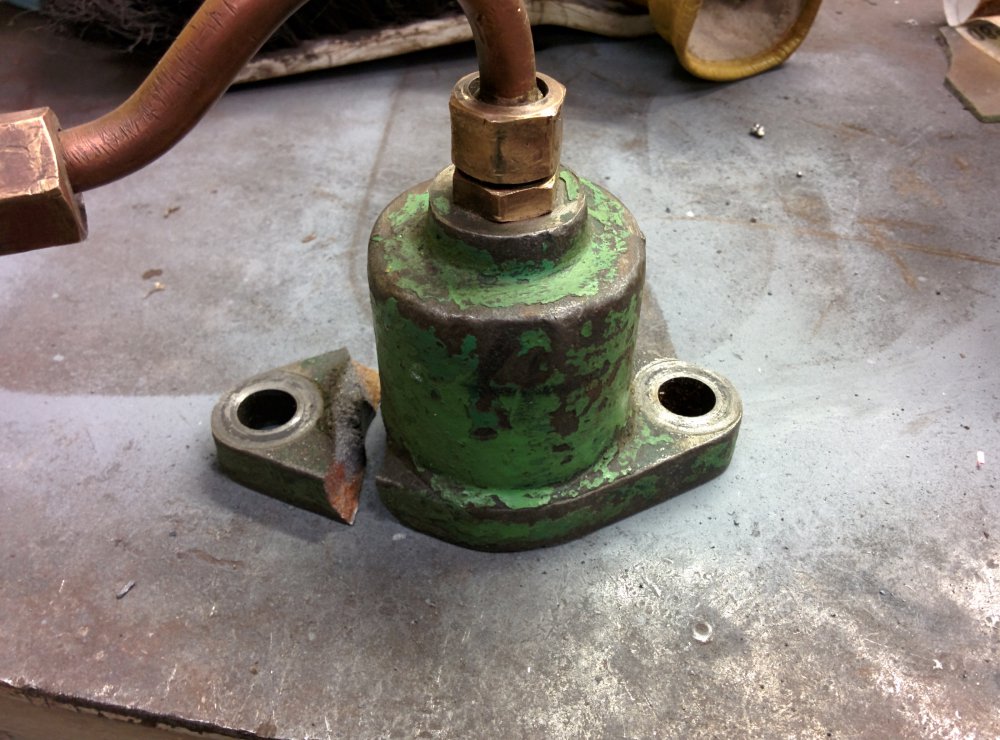

It needs two unloader valve caps fixing.

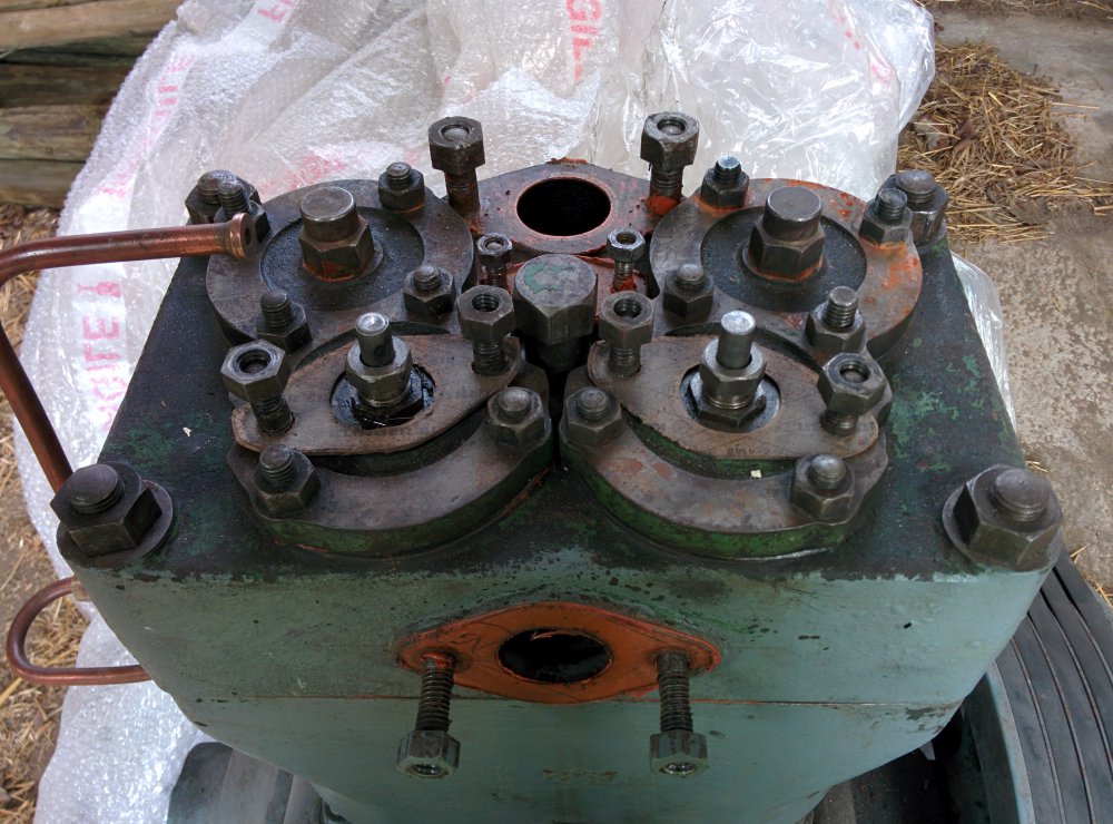

They are both broken like this. The crack includes part of the internal surface which houses a brass, 1.75" piston.
They fit onto here;
I've been ringing/emailing companies today who have almost all come back to me with no spares available (still waiting on two, fingers crossed)
So I'm thinking I'll have to work around it and think of a way to remake them.
I could have a go at machining from scratch, probably make it in two parts with the flange loose - like a motorbike exhaust clamp. But that's a fair bit if work, some tool buying and a lot of learning before I can manage that.
My other thought was to weld them up (have already had a go on one and it seems like it might be mechanically strong enough. Then, bore out the inside a few mm oversize and fit a liner. There seems to be enough metal in the thing. But I don't know where I can gat a 1.75" liner from...
Any other suggestions?
Could I do away with them all together?
They fit onto here;
