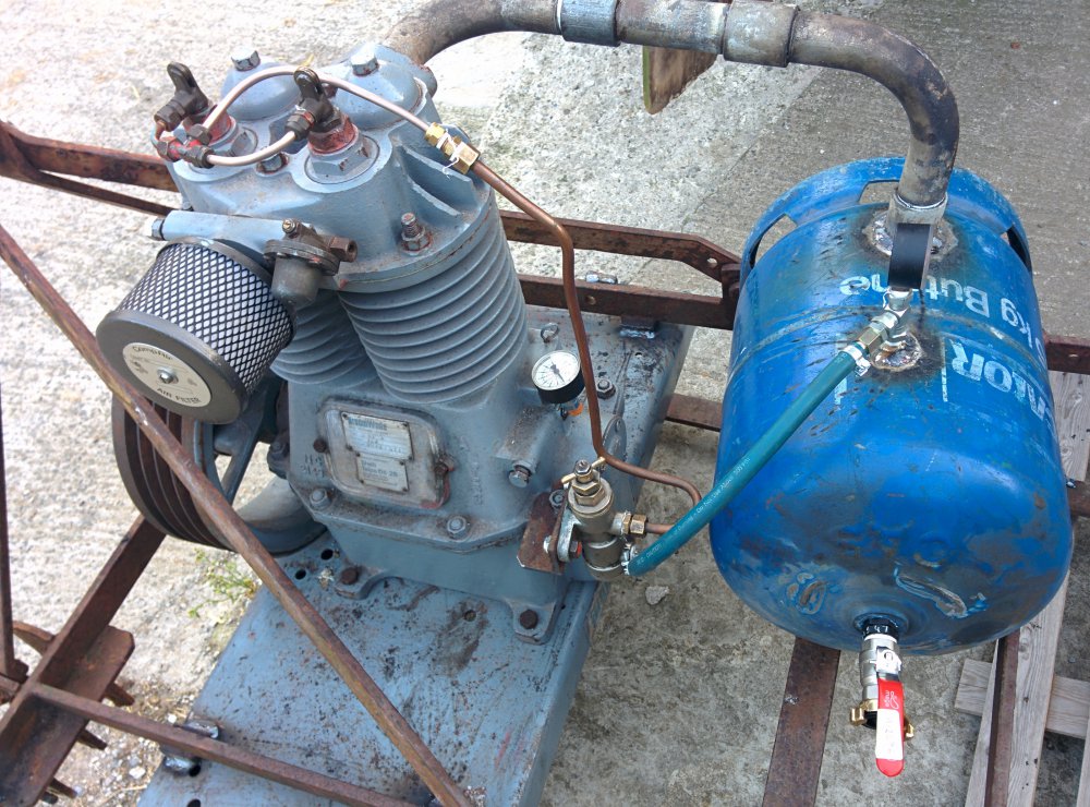

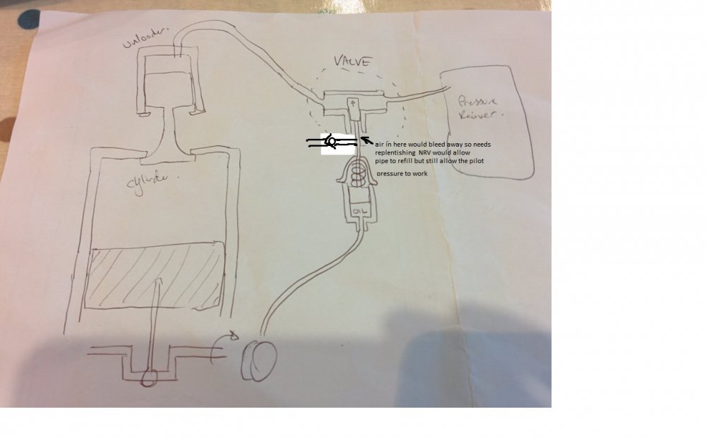

That might work but you would need a tee with a one way NRV valve-- open to air to 'regenerate' the air in in the control line to the solenoid
That was the reason for plumbing it into the air receiver - plenty of air under pressure available to pop the unloaders.
