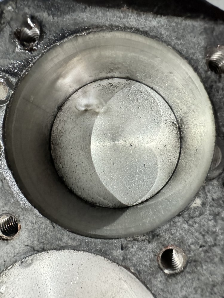

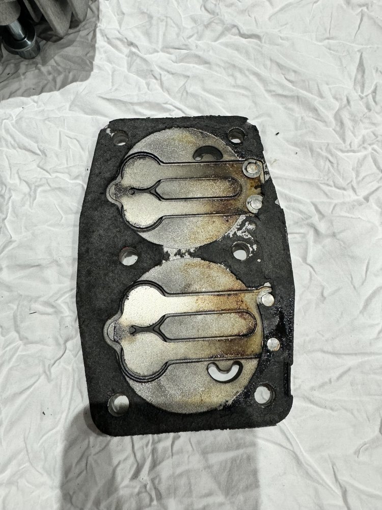

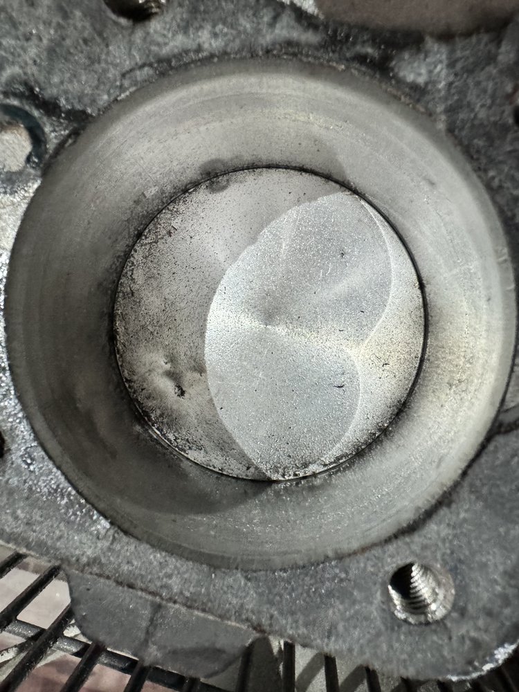

Feel like I've ticked most of the electrical boxes but equally with new bearings in the motor and the pump feeling ok by hand a mechanical issue isn't obvious... I guess I could give the pump a full strip to be sure?
