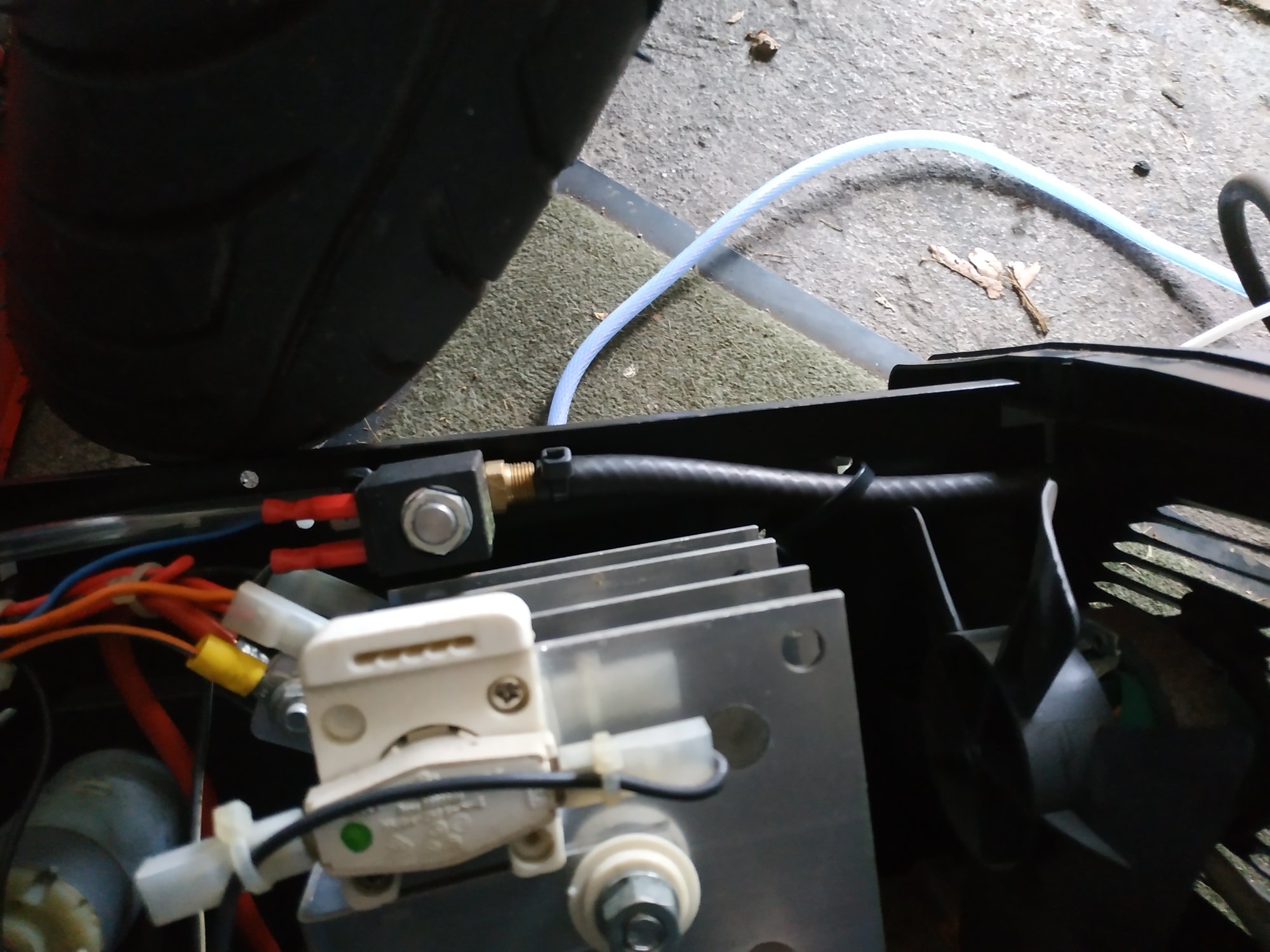

On the clarke the gas is controlled by a valve behind the tigger.

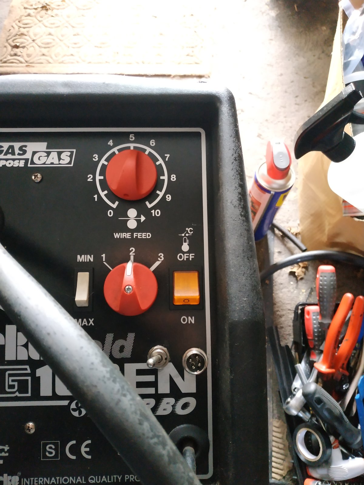

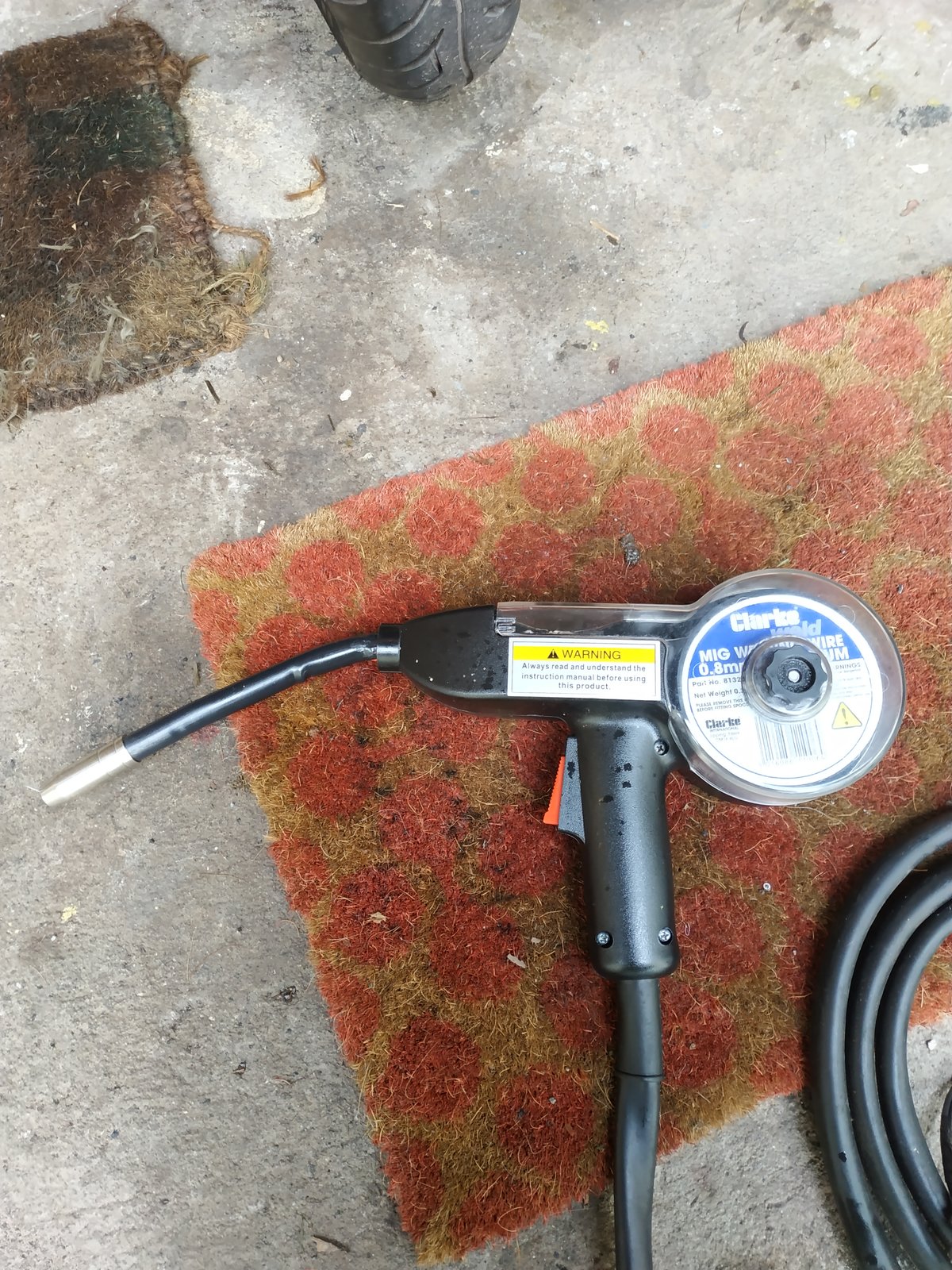

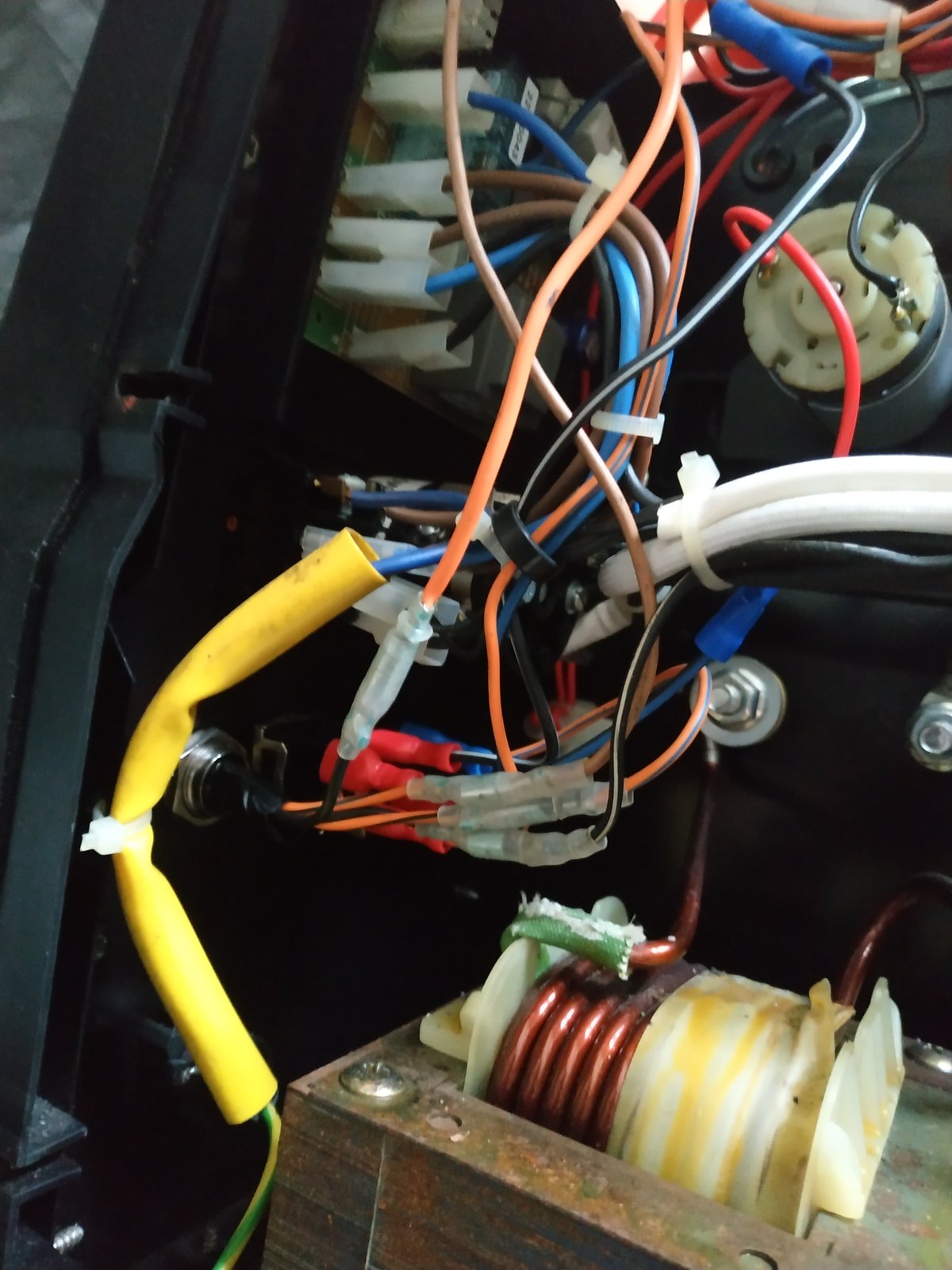

Glad to see the old post isn’t dead. I’m doing the same thing to my 180en. But I also want to be able to add a spool gun. Anyone have any recommendations on what wires to tap into for a toggle switch? I need to be able to choose power spool gun or the drive motor. Thanks for any advice.

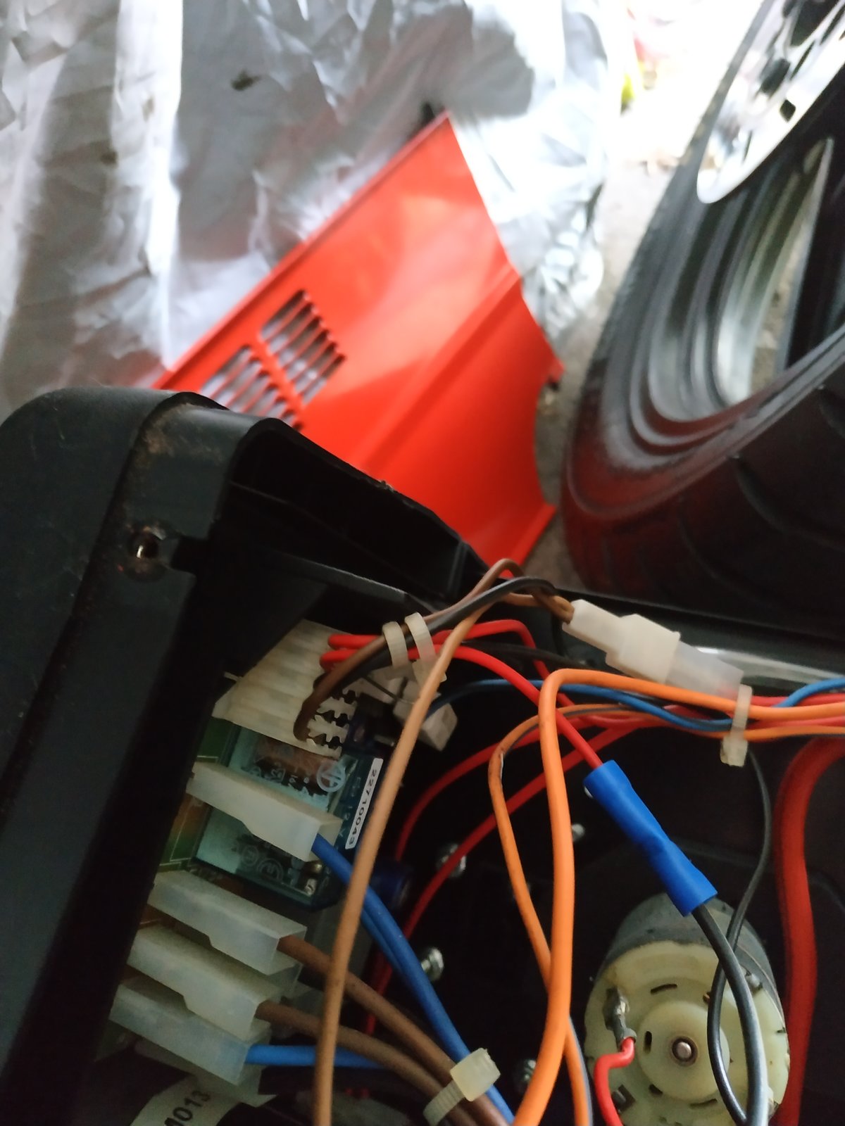

I have an old (1980's?)170a Clarke turbo weld.
Works Ok but could do with a bit of tlc, so I thought I'd treat it to a nice new spangly Eurotorch jobbie.
Any advice or hints very welcome.

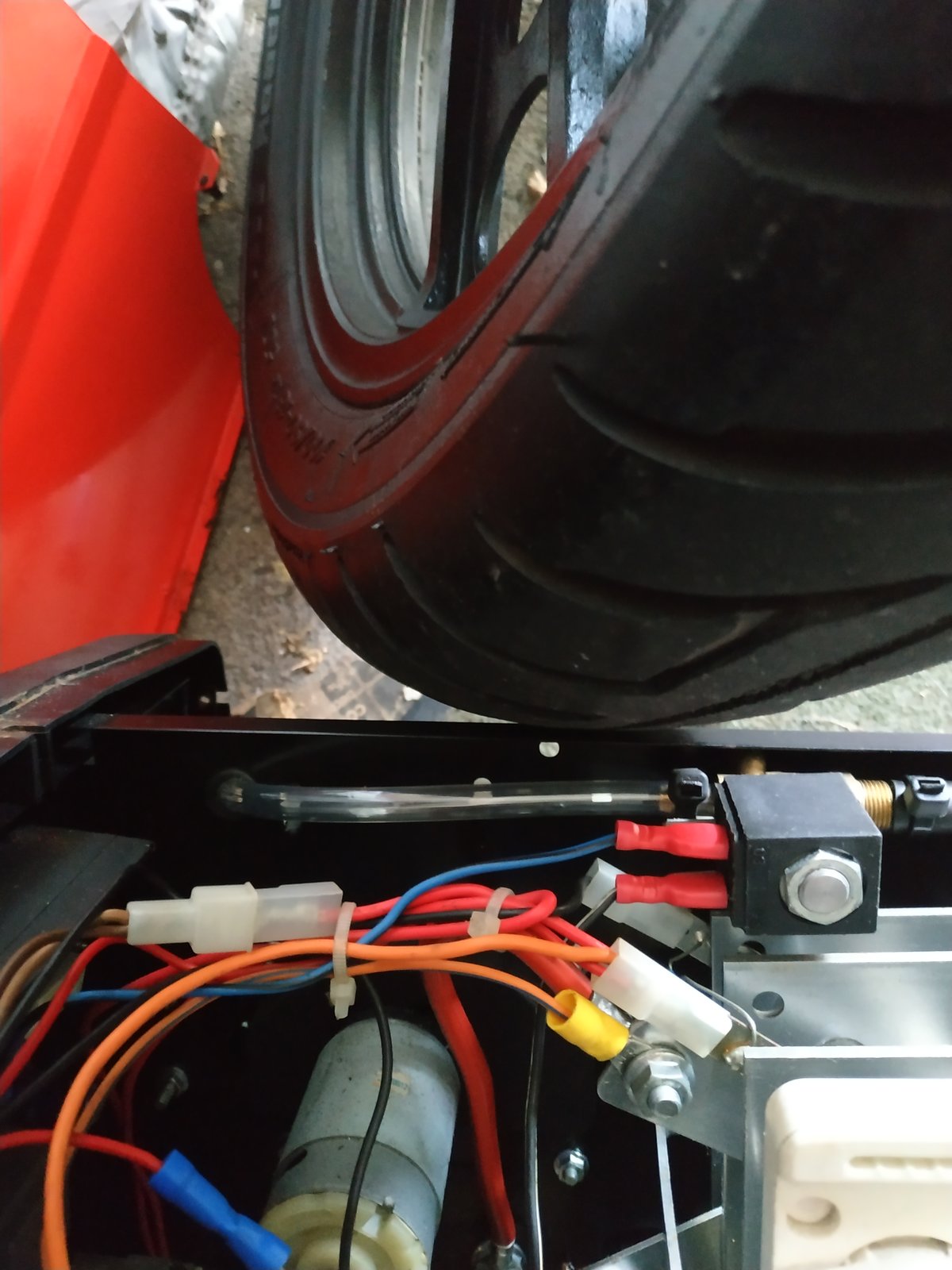

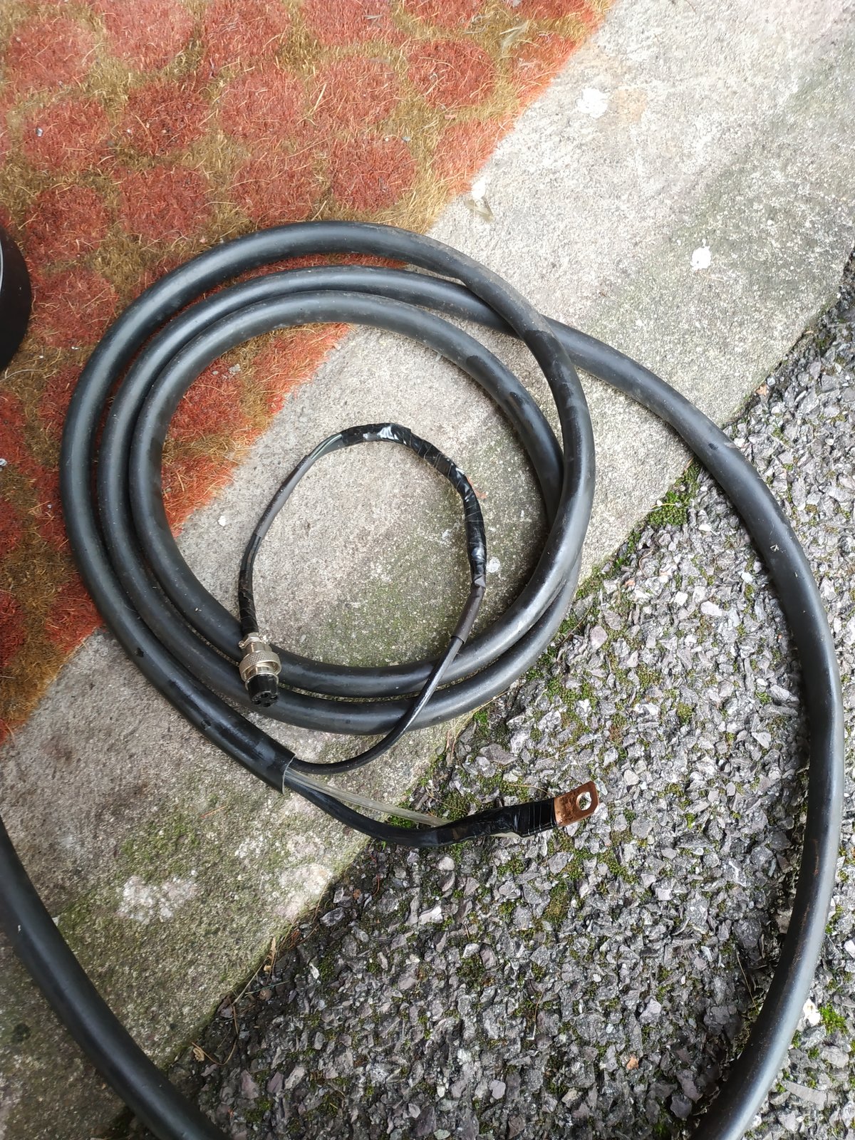

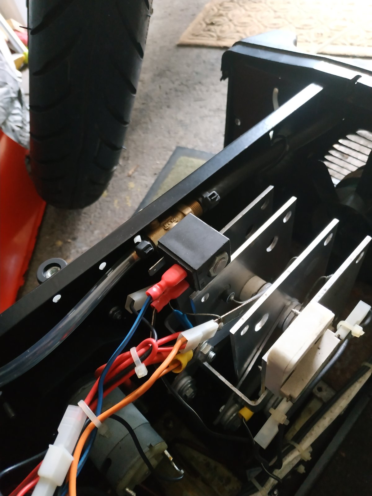

I converted a 160en to spoolgun for aluminium while back. Can't remember what wires but it wasn't hard. I keep the full functioning of the stock gun etc. Wired in a gas valve and a plug to connect the spool Gun. Had it all switched. You need the stock motor switched so the power goes to the spool gun(two wires). Speed adjusted on the machine. Also the trigger on the spool gun to trigger the gas solenode. Its works surprisingly well. It welded 5mm alluminum with preheat no problem. Won't be good for thin stuff.
Could I just take the wires off the back of the small electric motor that drives the wheels and connect them to a on off on toggle switch as the common? Since power will be given to it when the trigger is pulled? Whether you pull the trigger on the torch or the spool gun correct?
I've got my welder in bits.
Easy peasy.
The conversion looks fairly straightforward as there is a gas solenoid already there. (Result!)

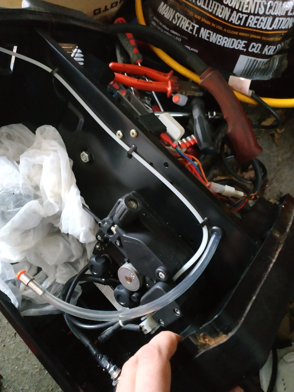

But I'm a bit confused about which socket to buy. (The part that bolts to the welder chassis?)
I don't appear to have much wriggle room between the feed roller mechanism and the inside front of the cabinet...

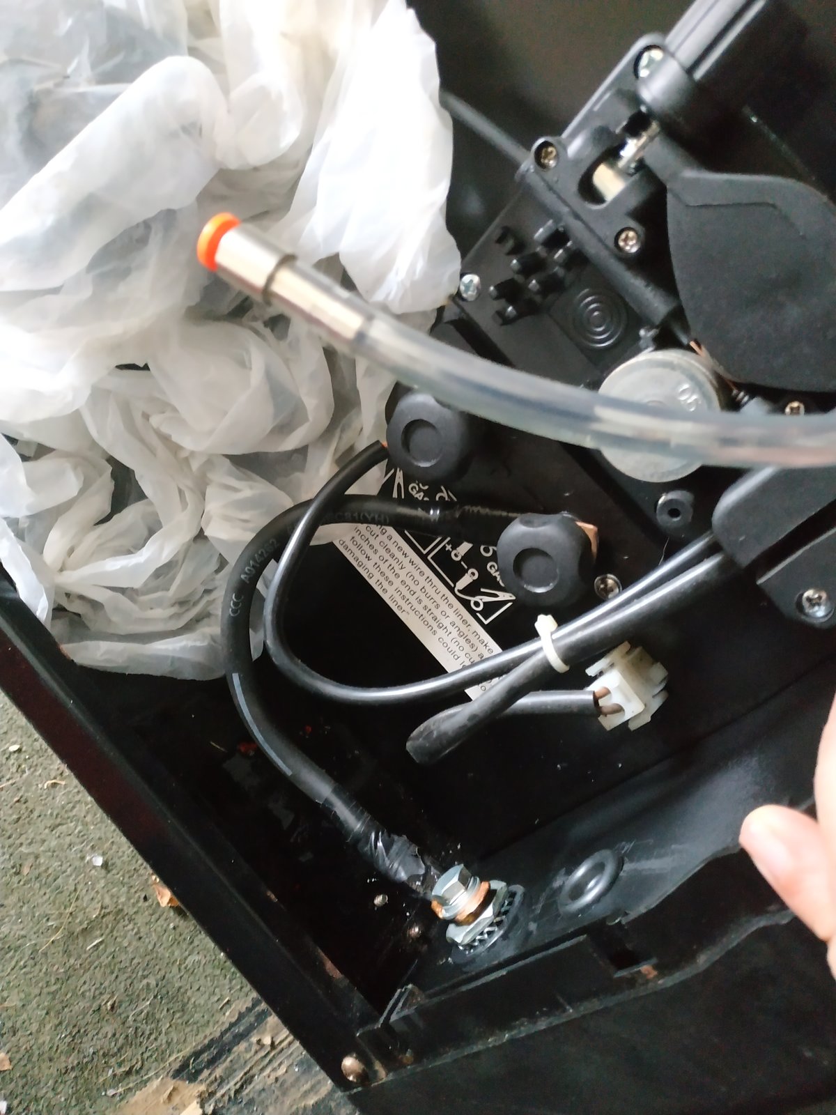

Any Euro connector will work as long as it’s air cooled and not water cooled. And you cut the bolt and hollow needle the wire feeds into to length. There’s a really good YouTube video of a guy doing it to a harbor freight welder.

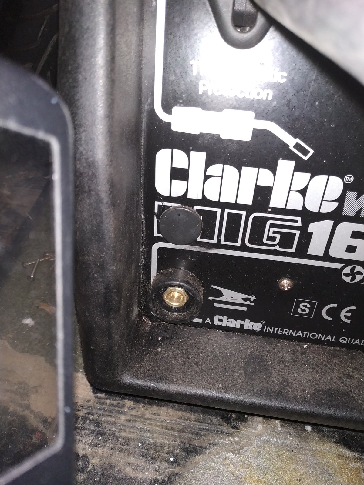

Just finished fitting euro socket.
Used M5 bolts...solid.
Looks like a factory fit!
Works beautifully too, lovely smooth feed.
Fiddly to fit, but easy enough if you take your time.
I now has the 'sizzle' sound!
Chuffed!
Nice. Did you wire in a switch and plug to use a spool gun? I’m almost done with my conversion. The only gas solenoid I could find had to come from China.
No, I didn't....I'm just getting the hang of welding steel...once I've got my head around that properly, I might have a shot at the ali. I think ali might be a bridge too far with my skillset...lol
