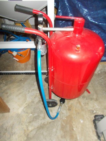

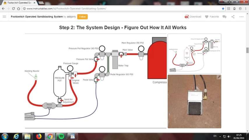

I'm using a foot pedal to turn the grit supply through the pot on and off using a pinch valve. I'm using a Model FV320 Foot-switch, 3 Way, 2 Position. This is the same as the instructable showing how to do this. http://www.instructables.com/id/Footswitch-Operated-Sandblasting-System/
He says, " The footswitch needs to supply the bladder pinch valve port with a constant pressure, then when you step on it, the bladder needs to be able to vent out."
"Normally the footswitch is used with the IN and OUT ports to control a pneumatic cylinder or similar device, the VENT port would just bleed air into the room. In this application however, the air is fed into what is normally the vent. "

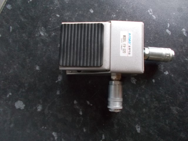

I don't want to run the risk of messing up the pinch valve bladder by connecting the pedal airline connectors the wrong way round. I'd appreciate it if someone could tell me the correct way to connect up the footswitch?

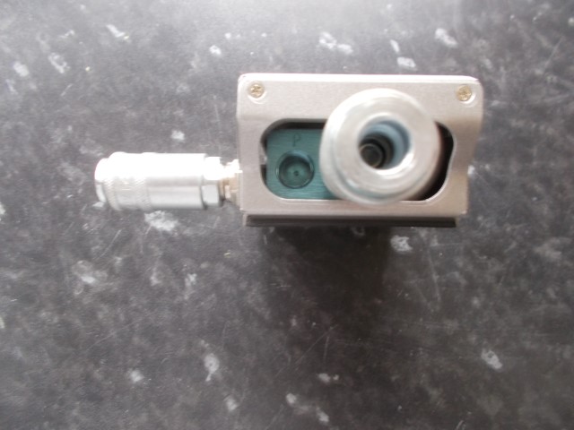

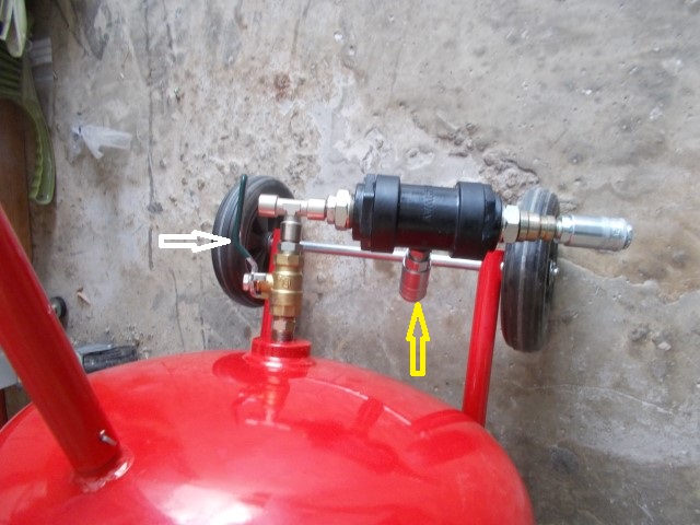

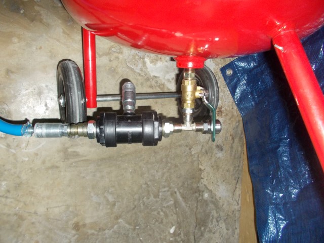

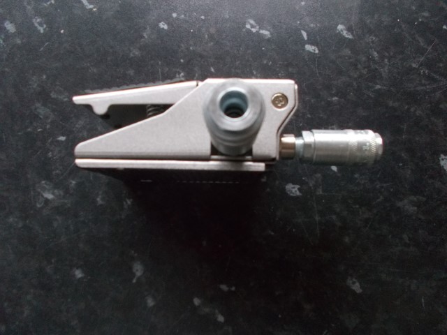

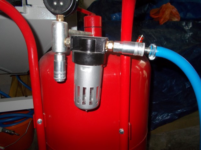

I attach photos of pedal and pinch valve on bottom of pot. The yellow arrow shows the coupler that is connected via airline to the pedal. The T connector above the white arrow will have the hose that goes to the blast cabinet.
The lever on the pot valve, because of the T the lever almost completely opens the valve. I don't know if this will be an issue or not. If it is, besides bending the lever so it avoids the T. Is there another way to do this, another design of lever, type, where available?
The large quick connect at end of pinch valve, is connected to the pot to supply the grit through the pinch valve.
As I say I'm not sure which port on the pedal should be connected to the coupler ( yellow) on the pinch valve? Also the correct in port on the pedal for the main air going in?
Thanks.
