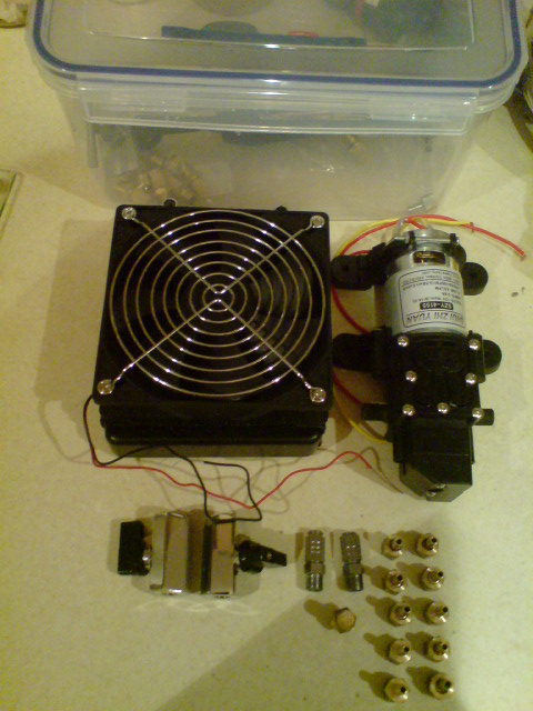

Ive been using a WP9 air cooled torch, but find that it can get a bit warm when using over 100 amps, and has a limit of 125 amps, so was looking at using a WP17 air cooled torch instead as that can go up to 150 amps, but then I'd need to get some new torch consumables too, so then decided to get a WP20 instead, as they use the same consumables as the WP9 torch.
I also decided that I'll need to make a cheap cooler to go with it, so that'll be a tupperware type container, 12v water pump and computer radiator and 12v fan and a few other bits and pieces. I'm not sure how well this will work once done, and it will probably take me a few weeks to get done, but I've made a start on things so I'll update it as I go along.

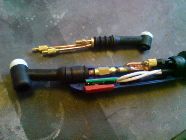

as I already have a spare air cooled torch (with a WP17 head) and lead I thought I'd convert it to water cooled.
so here is the air cooled torch and lead and the water cooled torch

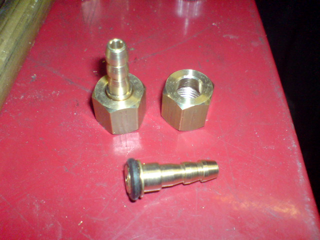

so the first problem was that the original power cable doesn't fit the water cooled torch, so I ended up making a new connector
so here's the parts the connector is made from, and luckily I had a 1/4" unf tap which is the same thread as the power connection on the water cooled torch. so I was able to make a new nut. the small tube with the conical end was made from phosphor bronze. the bent tube and the main body are made from copper. the bore of the smaller tubes is 2.5mm, so hopefully it won't be too restrictive to coolant as I intend to use 4mm bore tubes to connect to the cooler once its made. the power cable will be held in place with a couple of M5 grub screws.
I think the power lead connector on the original cable was soft soldered together, but I ended up silver soldering the new one together. and here it is in the torch handle, so as it fits, so I can get on with the next part in the near future.
