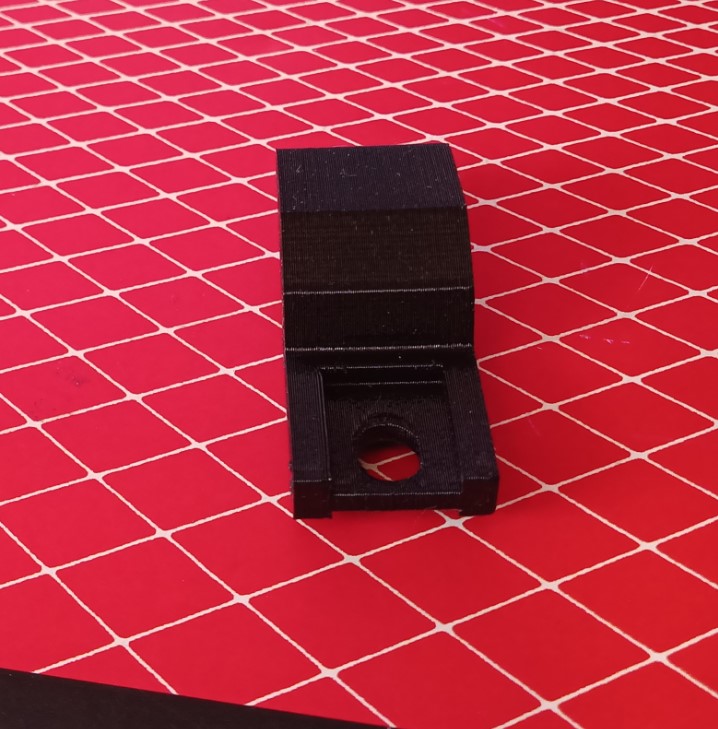

I have a decent supply of it all be it in Natural or Gold colours....so if no one else manages it send me the STL.

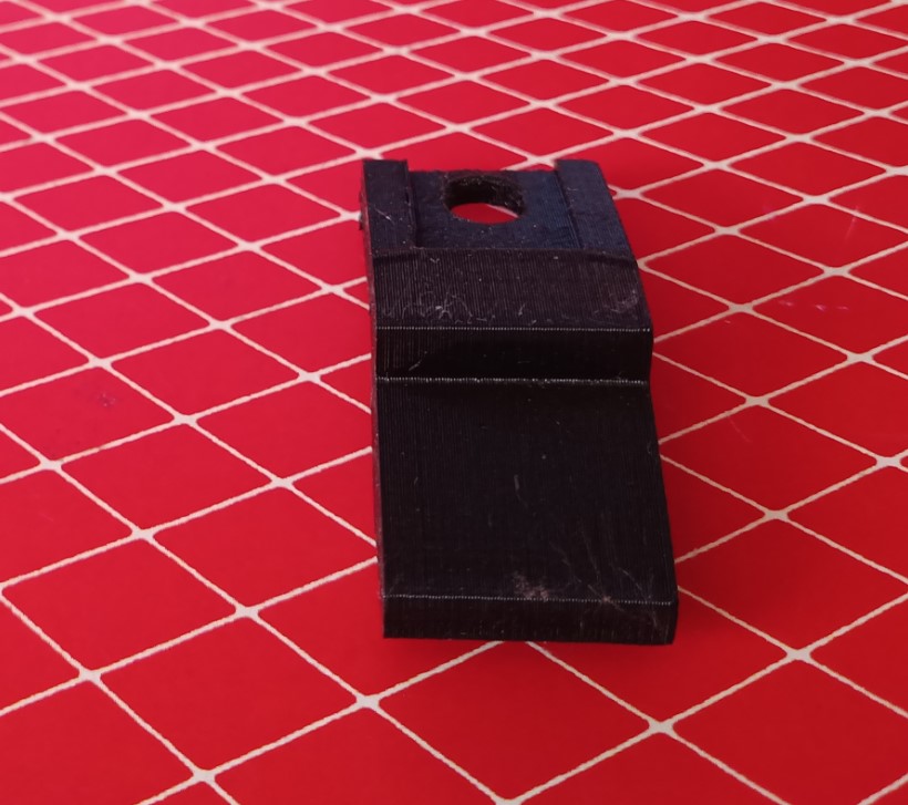

Given the loading and shape, I'd print it on edge, so you're not solely relying on layer adhesion for strength.I would go for option 1 - the solid. It will need supports somewhere. I'm thinking to print it upside down. Let's get the model first and work out the detail from that.

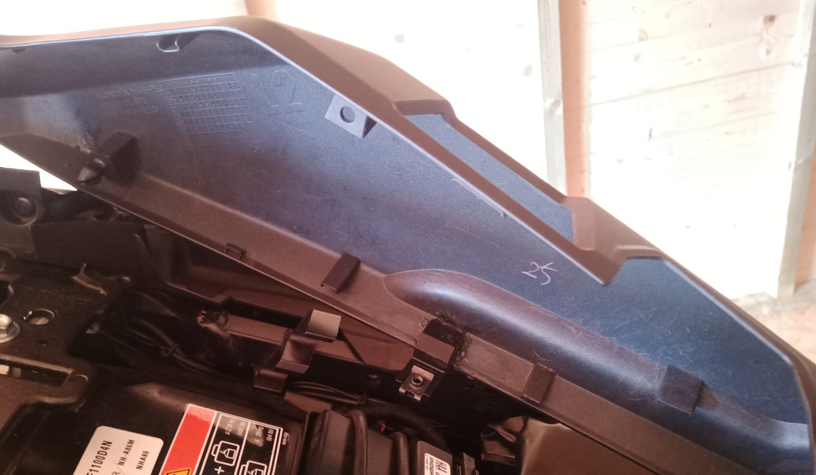

That's good as superglue is also affected by water.Got a chance to try the acetone and I didn't think it was going to work as it hardly seemed to touch the printed part. It did act well on the ABS however so I gave it a try. It seems to have worked, let it sit overnight and now if I try and prise it off the panel bends and I think it would likely break the panel before it separates so very happy with the result
Once again big thanks to @Bladevane![]()
