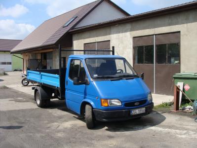

Isn't the frame just mild steel? If so why not just use normal mild steel?
Clean the crack up and weld but first; as said chassis is mild steel and it should be fully welded or may fail a future mot as chassis has to be fully welded
Yer it is
What year is the transit Jack?
From what i was told,if it moves then stops it passes
With a fairly bullet proof engine, very reliableEarly Mk5
Those are becoming like rocking horse poo jack look after it,is it a tipper?
Run of the mill mild steel will do you,just put a good protective finish inside and out afterwards
I want to bend 2 angle and weld it to frame
correct me if im wrong but it looks to me like the op intends to do a bolted repair only?
The holes are probably for plugs welds.correct me if im wrong but it looks to me like the op intends to do a bolted repair only?
