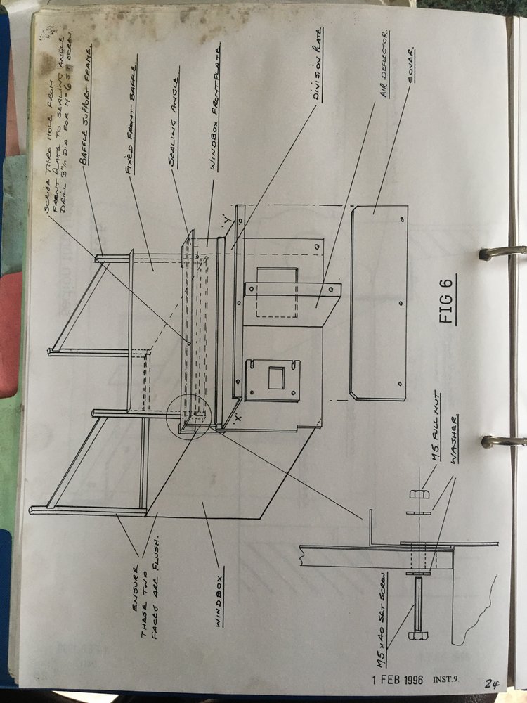

That's terrific, thanks. Problem is I think I'm too new to send PMs. I only get Follow/Ignore/Find, not Follow/Ignore/Start Conversation/Find. I'll check my profile settings.I’ve found the manual and taken photos of all the pages. If you pm me your email I should be able to set up a shared photo album. I guess you know the whole burner box is fitted as one piece? It looks like you remove the baffle assembly, the front sealing angle and the oil pipe and cables and it should slide out as one unit.

Thanks for finding these baffles - I've ordered them. Mine are totally misshapen. I am getting hopeful.These guys have the rings - maybe they can get the pot. If not an 8” pot with the same dimensions from the mounting flange to the bottom would probably be fine.
It’s an 8” Awena pot
