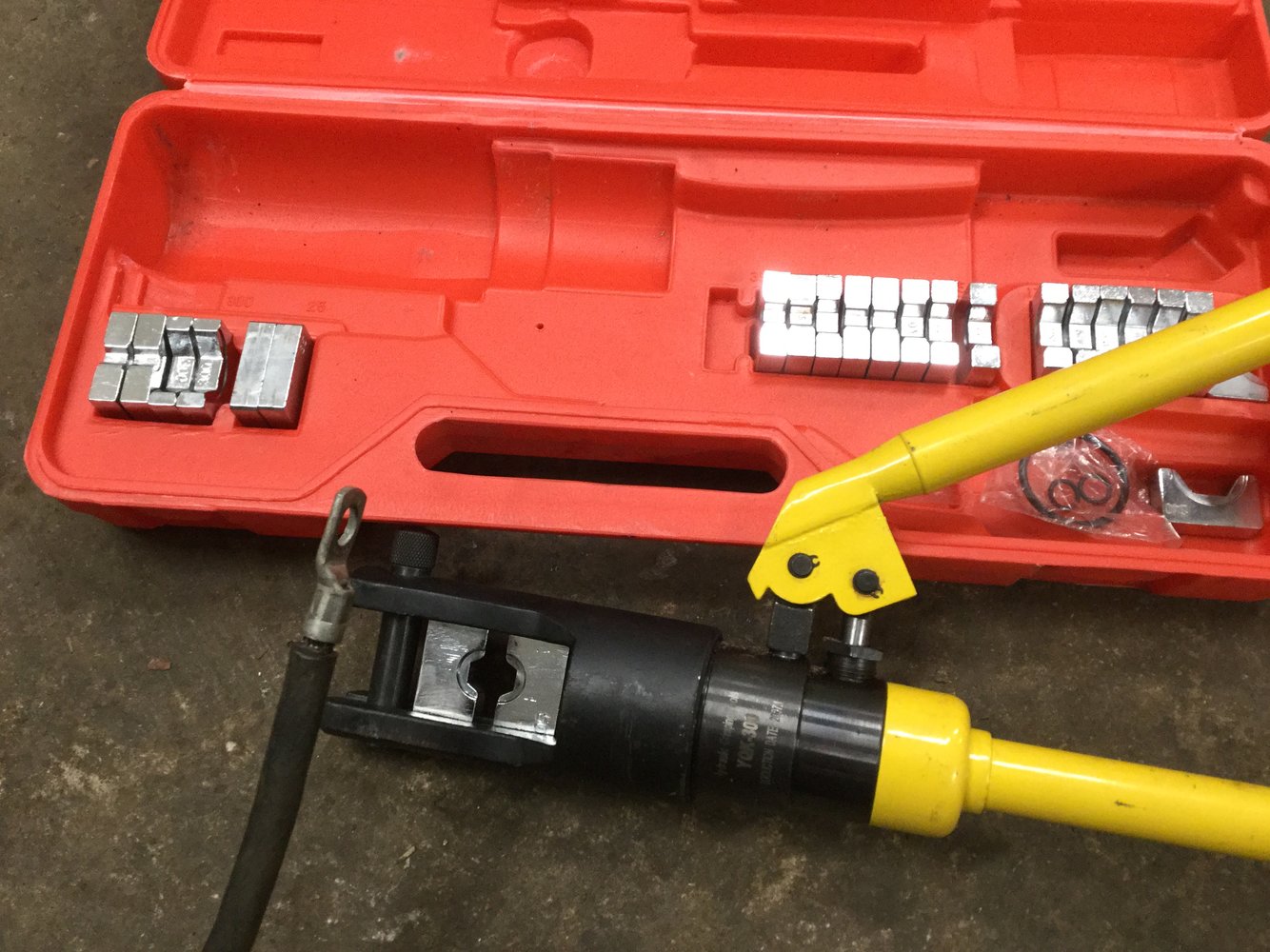

I just use a suitable size nut cut in half to make a cradle to support the cable lug and an 8mm ball bearing. put between the 6" vice jaws and squeeze, Perfectly secure fitting.
