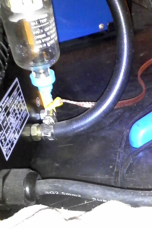

OK some pictures, first one is the grounding connection to the back of the plasma unit, ,

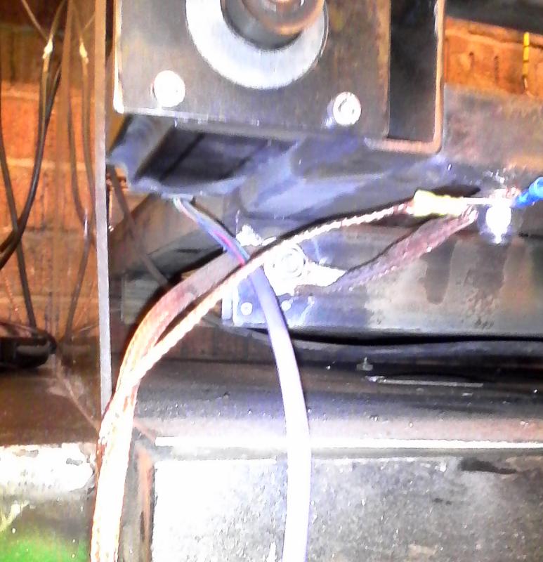

from here it goes to to the underside of the main frame and the disposable frame the metal being cut sits on:-
From here a grounding strap goes up to the control box, bottom left of the picture:-

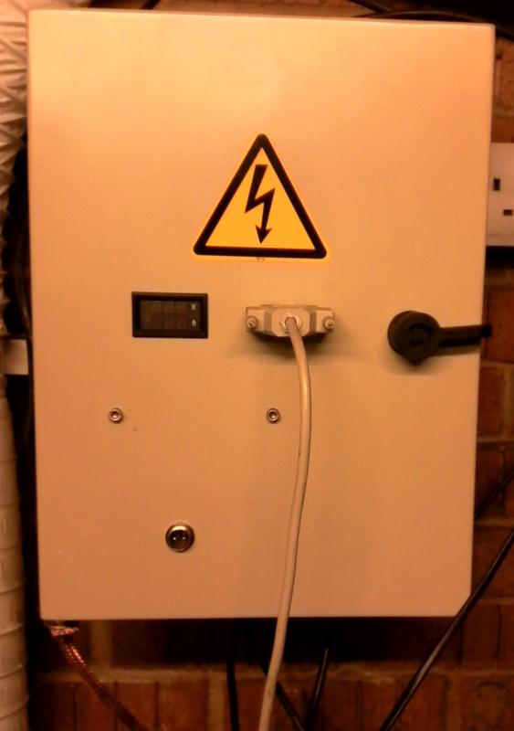

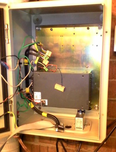

Inside shot of the box, again note the grounding stubs bottom left of the door area, three green wires go up to the screens on the output cables, also there is connection from the door earth stud to the main box earth sud and the mains is also filtered:-

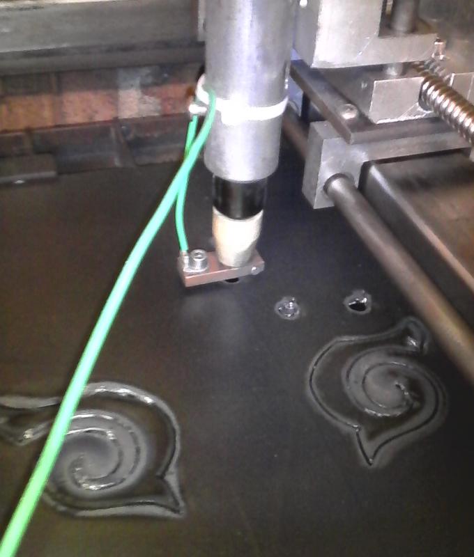

Next is the copper ground connected to the nozzle, the idea of this is to stop the sputtering, if possible and provide a sort of pilot earth. This taken from the CNC forum. The green ground wire goes off to the Clamp which is clamped again to the Plasma frame and back to the negative terminal on the plasma cutter:-

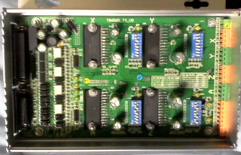

Last picture if of the board, sorry fuzzy but all taken with camera phone. left hand side is all the Opto-isolators for the input side to the TB6560 chips.
Now the negative of the PSU is connected to a common ground in the control board PCB.
