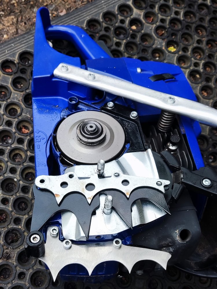

i think my issue here was the 16mm thickness more than anything. Hard to keep even with the flap disc. A flat table with the belt would have been nice. I think if I go for a belt grinder I'll get one with the ability to notch tubes, that would be really handy for making little gantries and cat catchers.Plasma saves time particually with concave curves but wont let you do anything that couldnt already be done with just a grinder, cutting discs and flap discs. Its just quicker not having to go in a straight line.
I'd recommend a die grinder if there are any concave curves.
Example of some freehand plasma and tidying up with flap disc and die grinder.
I dont believe a belt sander has much advantage over a flap disc, likely quicker, but then it takes a lot more space. With limited space, I wouldnt want one.
Yes ^^^ and a clip on stand off will help as well for squareness.The issue may be more if your doing it by eye? rather than marking out the profile to cut to with permenent marker or similar to follow. Rechecking the profile often and marking again if it burns off.
