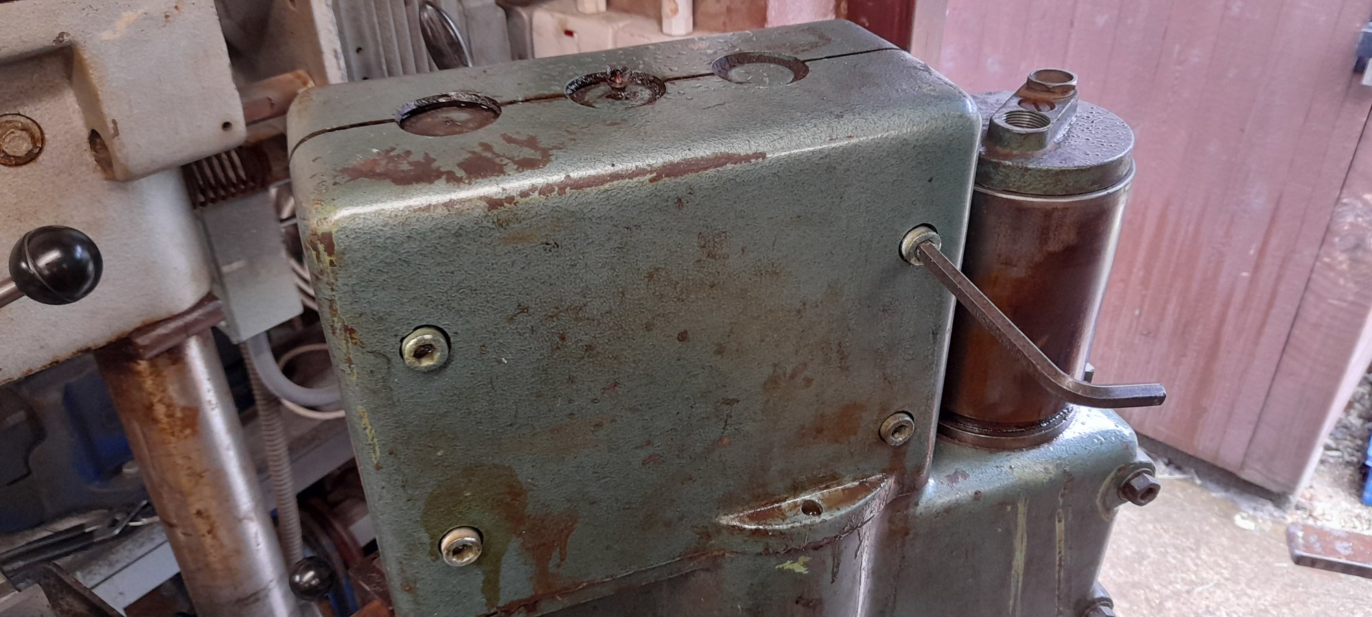

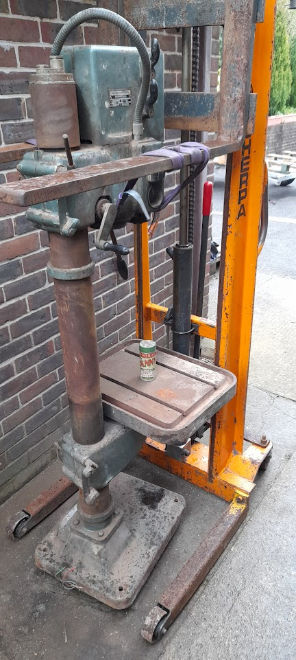

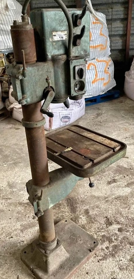

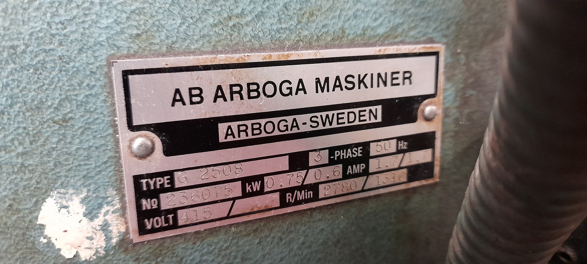

I'm considering purchasing a machine with a built in Dahlander motor. Rating plate says 415V.
i would normally feel confident about finding the star point and rewiring for low voltage Delta use, but maybe not this one. I'm assuming it could be troublesome.
i have no shortage of motors, but this one is built in and can't be changed.
any comment before I make a decision?
