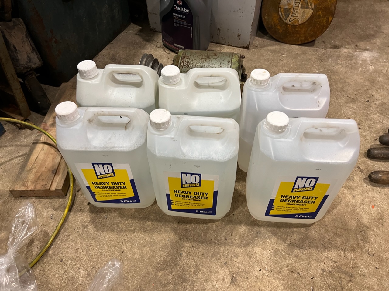

Why did you need that much?

I put 2.5l in my ultrasonic cleaner every time. I’ve already used one. Probably have another 2 to use next weekend.Why did you need that much?
I was watching someone recently on you tube, he used sealed containers to put the parts in, just big enough to house the part, then filled the container up with degreaser and put that in the ultrasonic cleaner filled with water, uses much less degreaser and doesn’t contaminate the machine, it appeared to work very well.I put 2.5l in my ultrasonic cleaner every time. I’ve already used one. Probably have another 2 to use next weekend.
Drain, all purpose cleaner etc is no different to cleaner used on household floors etcHow to dispose of the used up degreaser ?
I read the first page after I saw there was one.I put 2.5l in my ultrasonic cleaner every time. I’ve already used one. Probably have another 2 to use next weekend.
