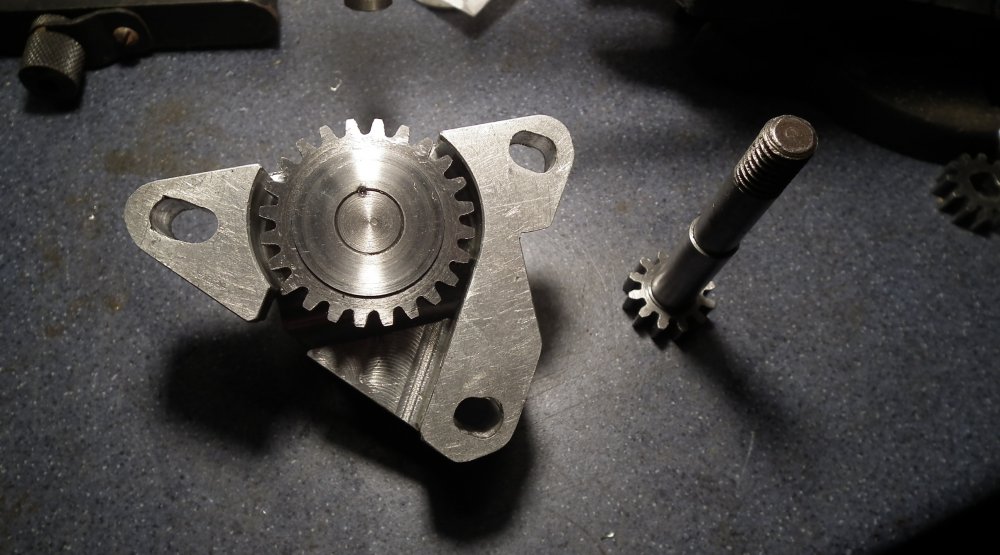

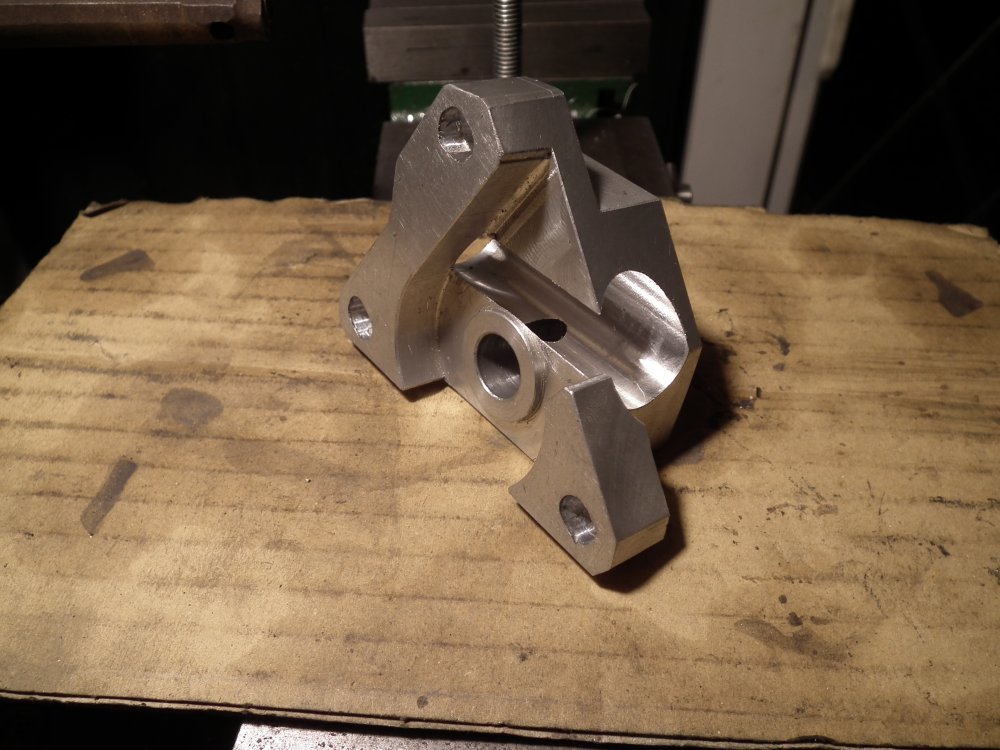

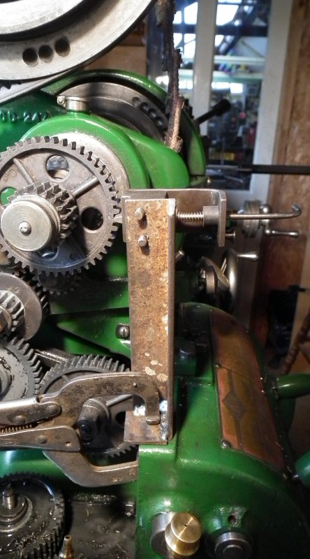

Here's my effort, it works very well and locks the spindle solid, but if you have a disconnect pin to your chuck for the back gear, a little play may happen there. One way of preventing that is to hung a weighted strap over the chuck to add tension, and only turn the chuck one way.
