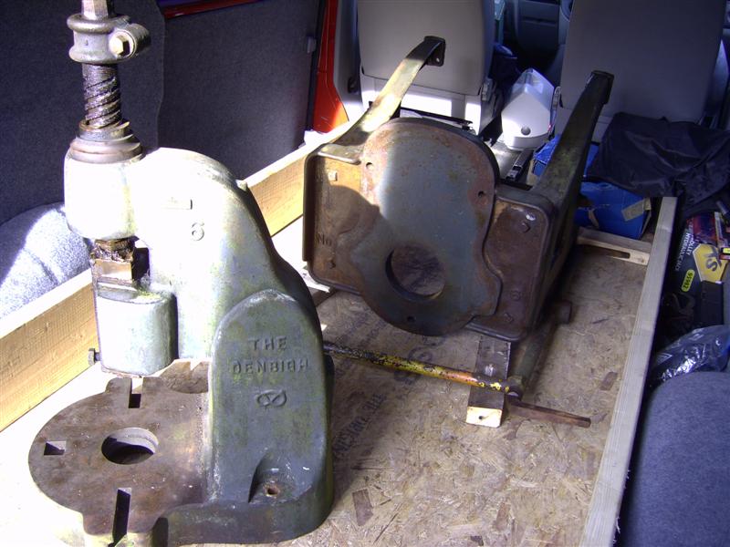

I have a Denbigh No. 6 fly press with the original cast iron stand. For what its worth, the combined height = 34" to top of the press's table, and 64" from floor to the horizontal swing bar. I haven't put it back together yet, but it seems about the right height for dealing with hot forgings, but too low with regard to possible head injuries.I have taken delivery of my 'new' flypress from @pressbrake. Whats the general opinion on height? I was looking to have the weight arm above my head so I dont get hit with it. That means the workpiece will be about 1300mm which is about sternum height on me. I have heard this is about right, but also heard its too high
I dont want to be stooping when I use it but dont want to get clouted by the damn thing either!
