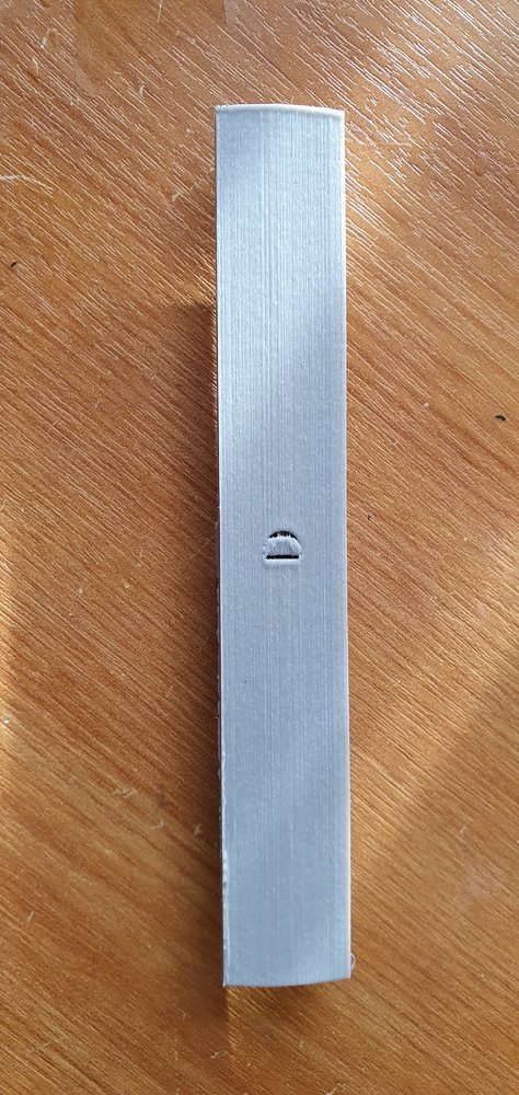

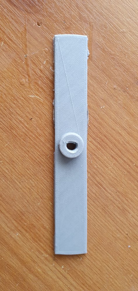

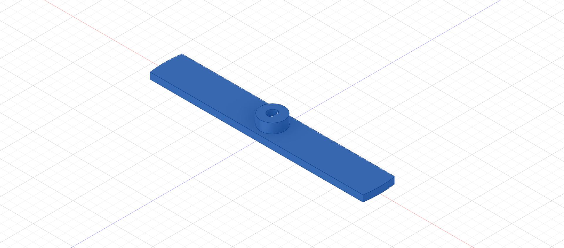

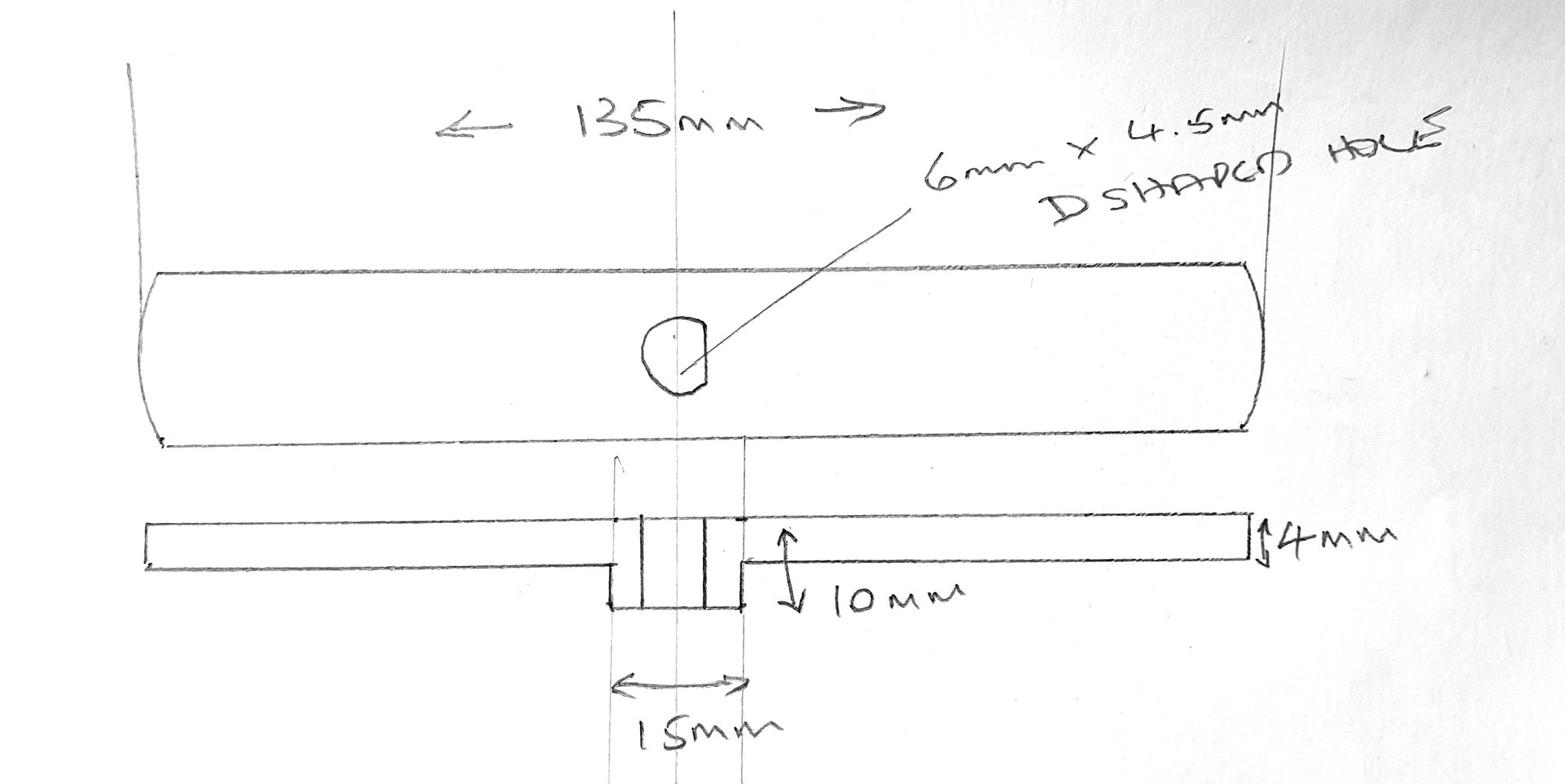

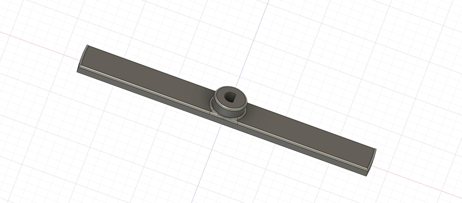

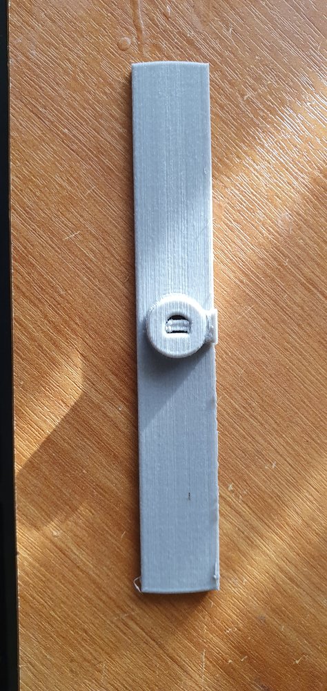

I'm trying to make a watch winder for my new automatic watch...I have a little 10 rpm motor with a 10mm long 6mm dia (D shaped) output shaft. I want to make the item in the attached sketch out of PLA. I have an Anycubic 3D printer which I've used for a few things but they have been 'ready made' files from Thingyverse and Cults.
I have tried various programs to design this simple piece (used to do a lot of 2D dxf designs with my plasma cutter) but I'm struggling. Would prefer to be able to draw this and turn into 3D gcode but if anyone can either show me or draw it for me I'd be grateful....thanks Gerry
