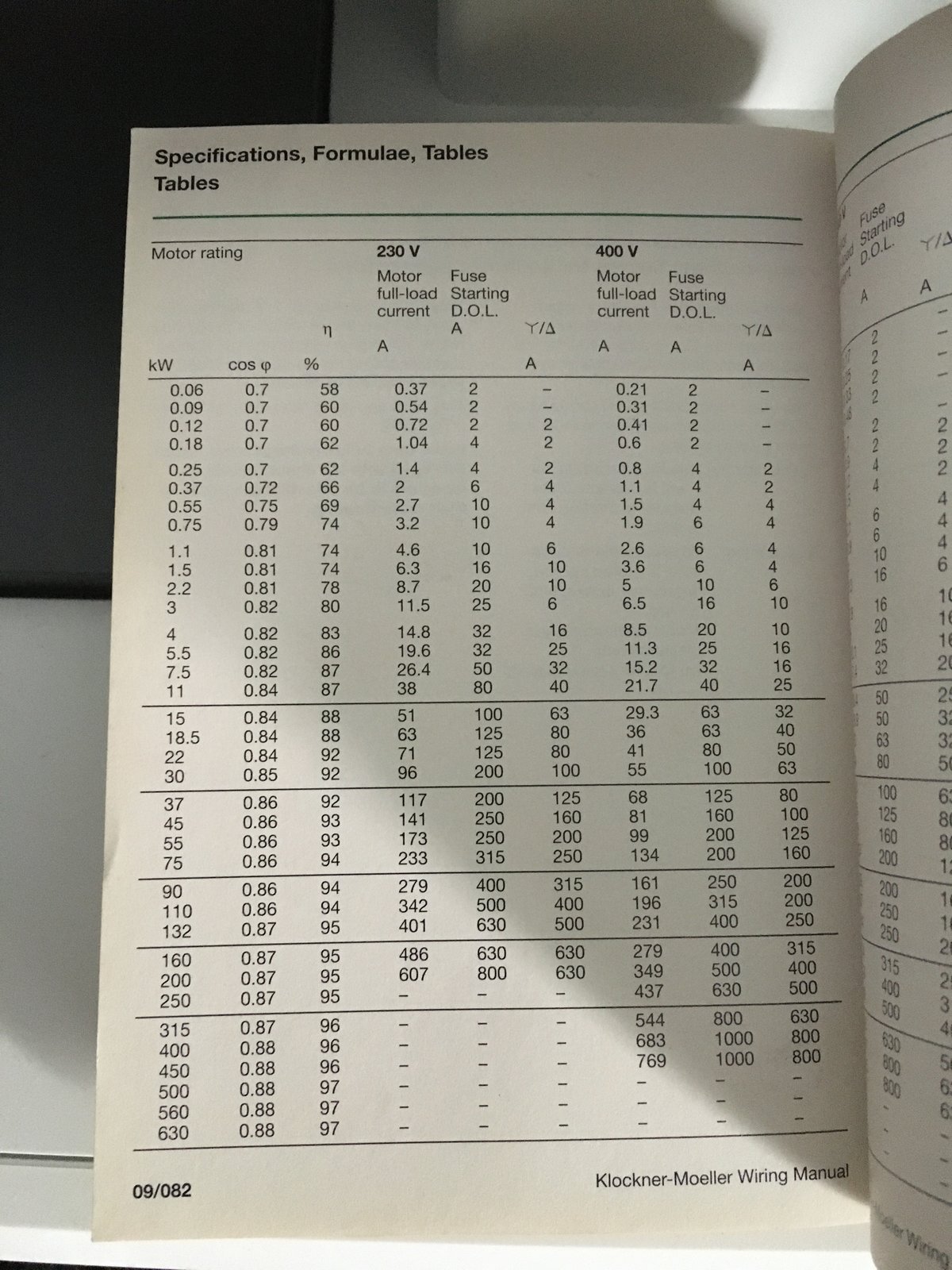

I am looking at a 130cfm 22kw Hydrovane to run a blast pot for my blasting room. I am unsure what would workout cheaper.
To buy a road compressor or run such a big motor from the hydrovane.
Whats your thoughts, was hoping to run a 6mm nozzle for prepping wheels.

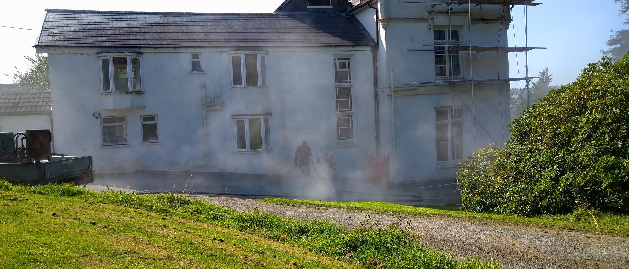

I just used to do wheels and frames in a shed outside with the walls and floor lined with conveyor belt just leave the door open and the crap just blew away
