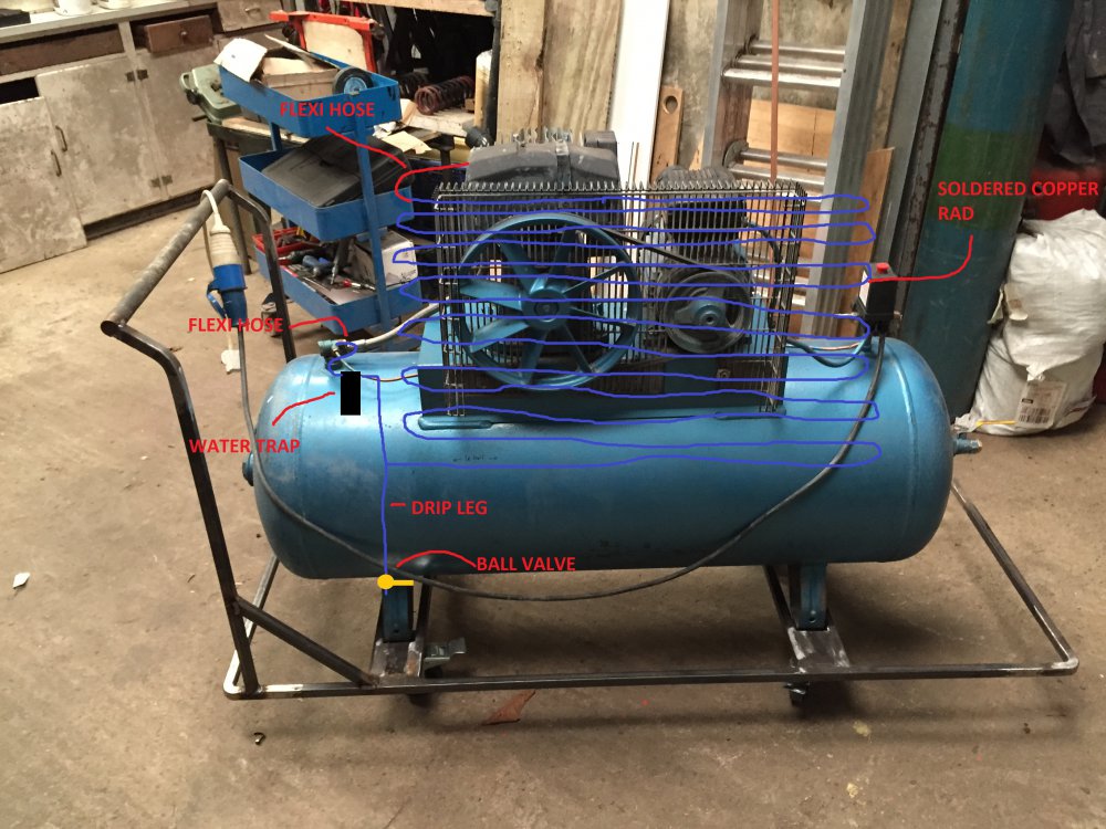

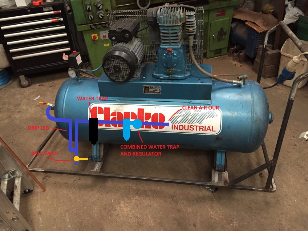

Hi Guys,
I've seen various threads online/youtube postings of peoples home made air dryers recently. I'm looking to use my compressor to spray and sandblast with occasionally, so this seemed like a good project.
This is only for hobby use, so I cant justify buying an expensive air dryer, although using something to help condense the compressed compressed air before using drip legs/water traps seemed like a good idea.
I've seen many people with smaller compressors (mine is a 4hp unit) connecting the compressor pump to a vehicle ac condenser radiator, then through water traps, allowing most of the condensate to be removed before allowing the air to enter the tank.
I made a wheeled frame for my compressor over xmas to allow it to be more mobile and enable a similar setup to be attached to my unit. See details of the planned dryer setup below:

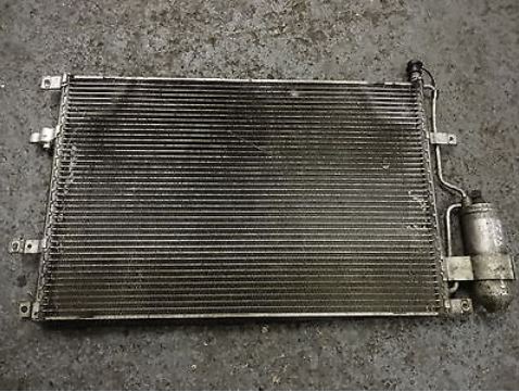

For my application a mondeo condenser seemed to be a good fit, the inlet and outlet ports were in a great location and the unit was of a sensible size. Although after unboxing the unit, and just attempting to blow through it, it seemed seriously restrictive (see the air path below) and had a big pressure drop across it.
I know others have used similar systems to this on their compressors and have had good results (I've not heard of any popping!) so just wanted to get a second opinion. The compressor pump kicks out a lot of air, and I'm concerned the condenser might become damaged due to the large pressure drop/the tank will take ages to fill/place too much strain on the pump.
Would I be better off creating a more basic version just out of 15mm soldered copper pipe instead? I know this may not be as efficient, but I could use 14m or so of copper pipe quite easily, have a minimal pressure drop, great flow rate as well as having something more durable too?
I really just wanted to gather some more expert advice on this project. I'm now thinking the copper pipe route would be safer and probably provide something more durable over time too. Im sure the majority of you have far more experience than myself though, so if you can share a bit of advice on the topic that would be great!
Many thanks,
Ollie
