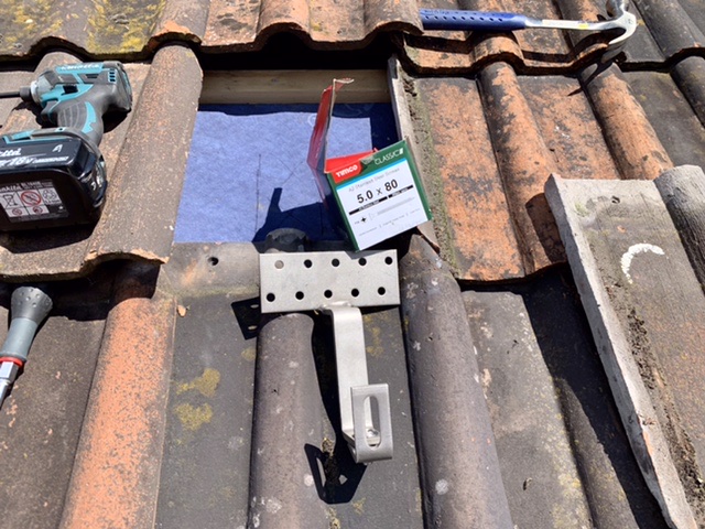

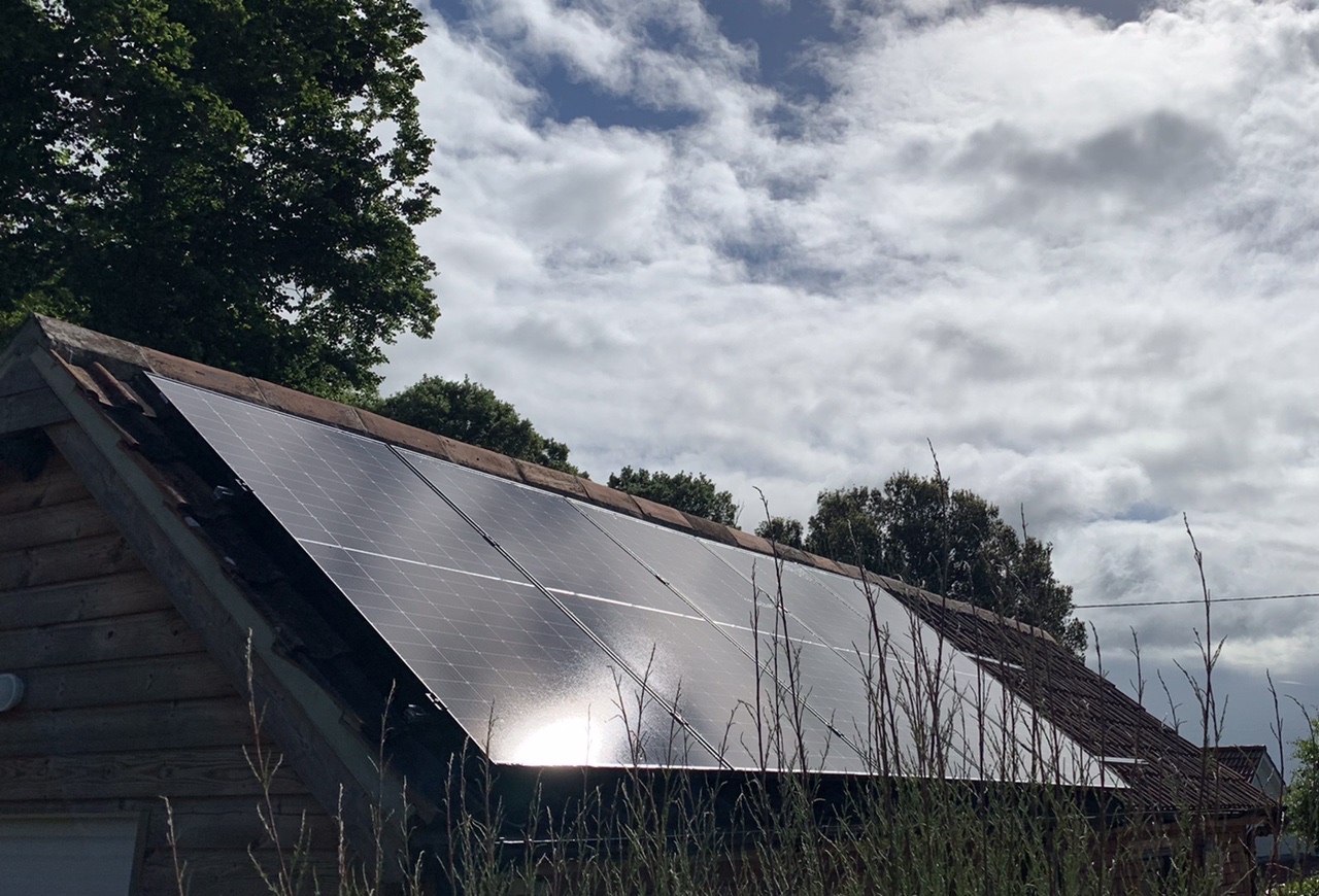

Edmondson electric do 405 watt JA Solar panels for £118 plus vatView attachment 351026
That’s the brackets, then the K2 rail system which was from solarsparky https://www.solarsparky.com/product-category/mounting/
The panels are from a seller on eBay, he imported 500 or so apparently but when delivered he had 17 left, they seem pretty sought after presently. There is currently a seller in Bristol with some 405w panels.
Growatt inverter was also from eBay, I got lucky there, the guy had bought it bundled with a wind turbine but didn’t need it, I received it as new in unopened package.
I’m building a secondary array at a steeper angle to try and make up for winter loosesReally interested to see the data on this, thanks
Am impressed with our steeper 4kW array's production. It's at about 45 degrees.I’m building a secondary array at a steeper angle to try and make up for winter looses
