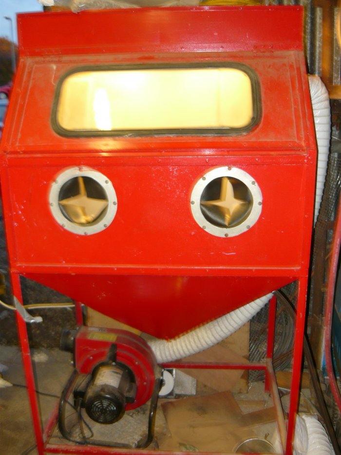

I've just finished my blast cabinet (http://www.mig-welding.co.uk/forum/showthread.php?t=14009) and i had a go today cleaning a few bits up with the syphon gun but i found it really struggled to pick up the media so wasn't really cleaning all that well.
My compressor is a 200l 3hp 14cfm jobbie so should be capable of reasonable results from what i've read. I was getting a good 80-90 psi operating pressure
I tried the pickup tube in various positions ie submerged in media, just on the top of the media but it was still quite hit and miss and miss as to whether it picked up the media. The media is fairly course grit for masonary but on the occasions it would suck up it did remove paint and clean up rust.
I'm thinking the media might be a bit heavy to be sucked up via syphon method so i'm wondering whether i might need a pressure pot instead.
