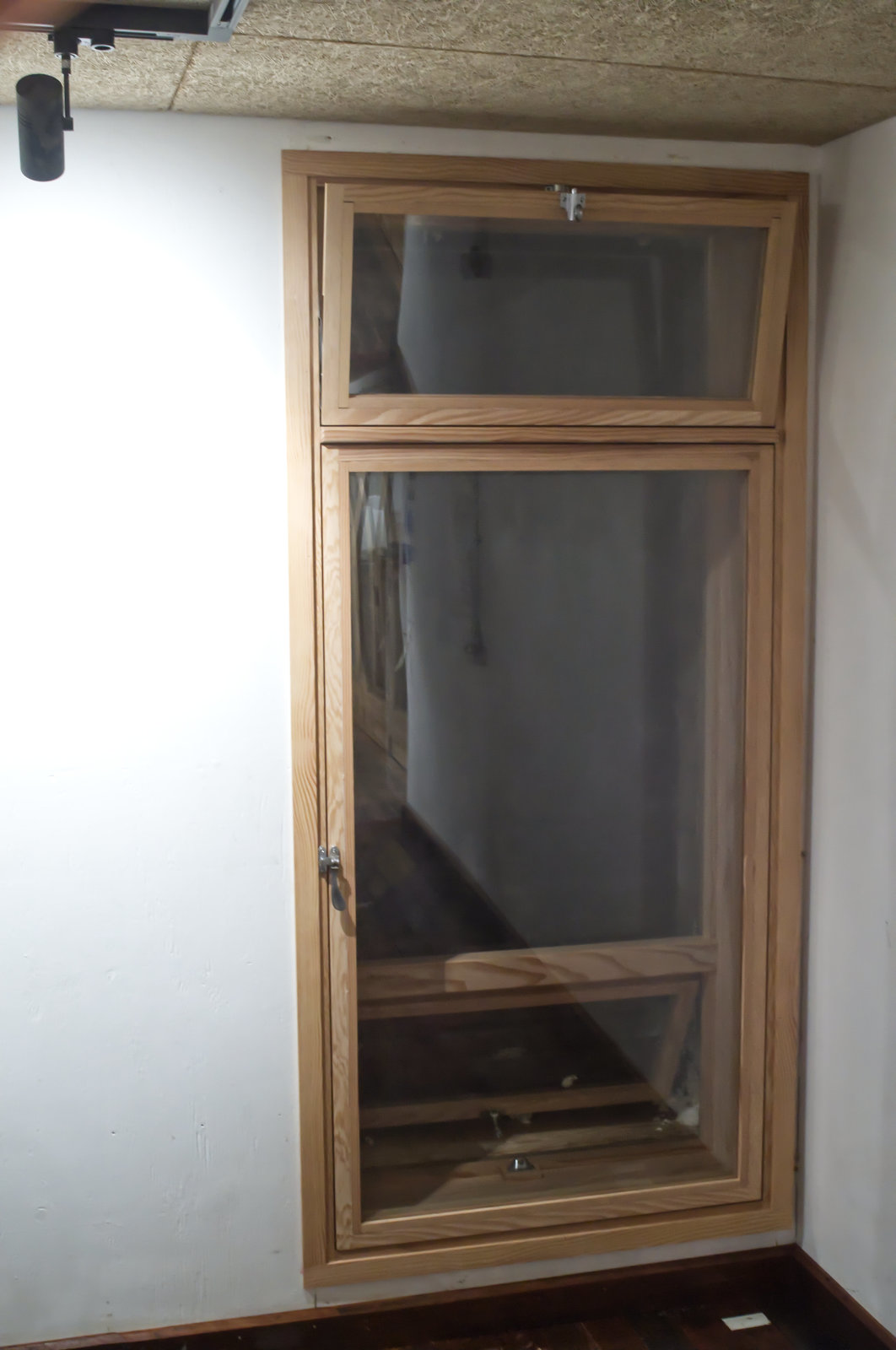

I can do what I like on the inside. In Finland rather than having double or triple glazing they tend to have a secondary glazing system with single glazing on the outside and double glazing on the inside.

Anyone have any ideas for a seal between the glass and frame? I was thinking about making a channel for a round seal that would be compressedby the glass, but don't know all the options.
