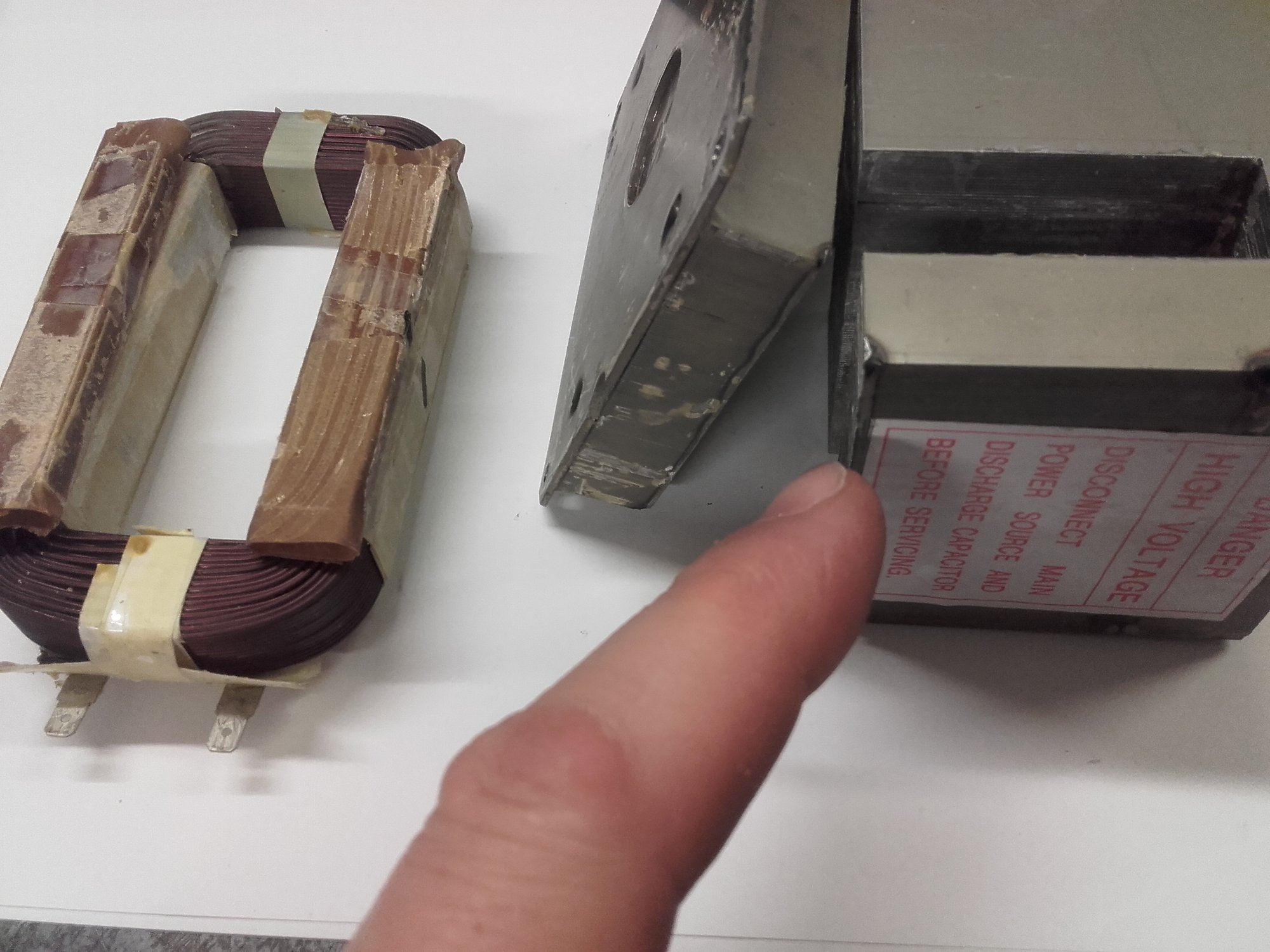

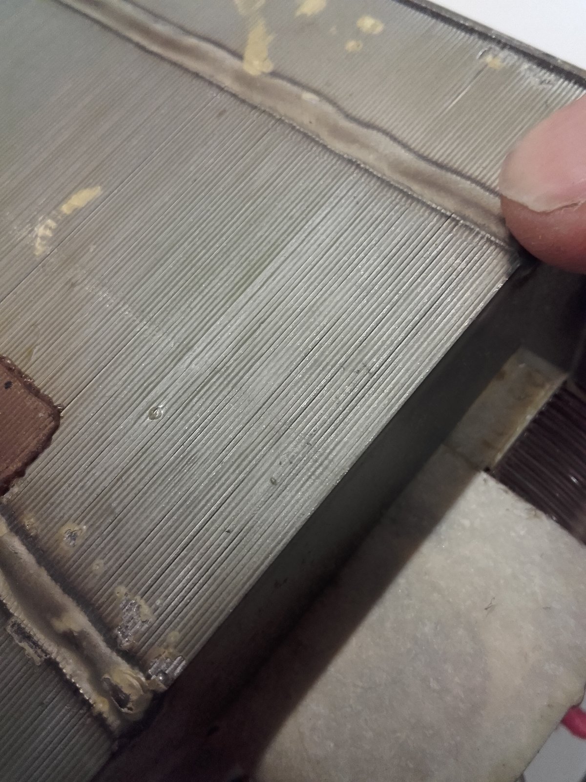

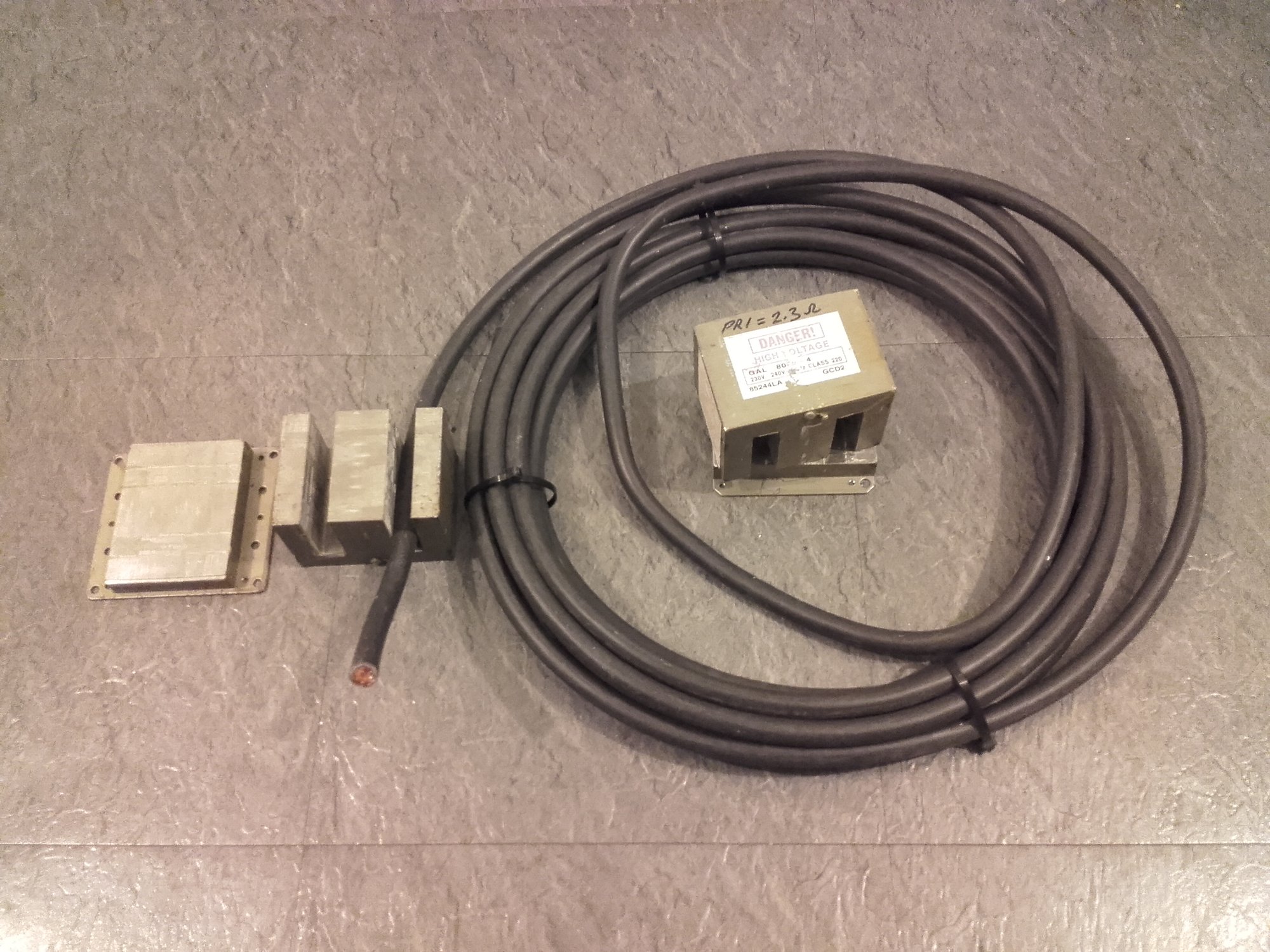

Hacksawed thru the weld to split the first trannie (vice, timber, bfo hammer) and salvaged the primary.
After I fit the new secondaries I'll need to "stick" the trannie back together. One site advocates Araldite ffs! Hardly going to guarantee continuity on the earthing!
Can't decide whether to clamp and stick /MIG weld the join or just tack each corner...
