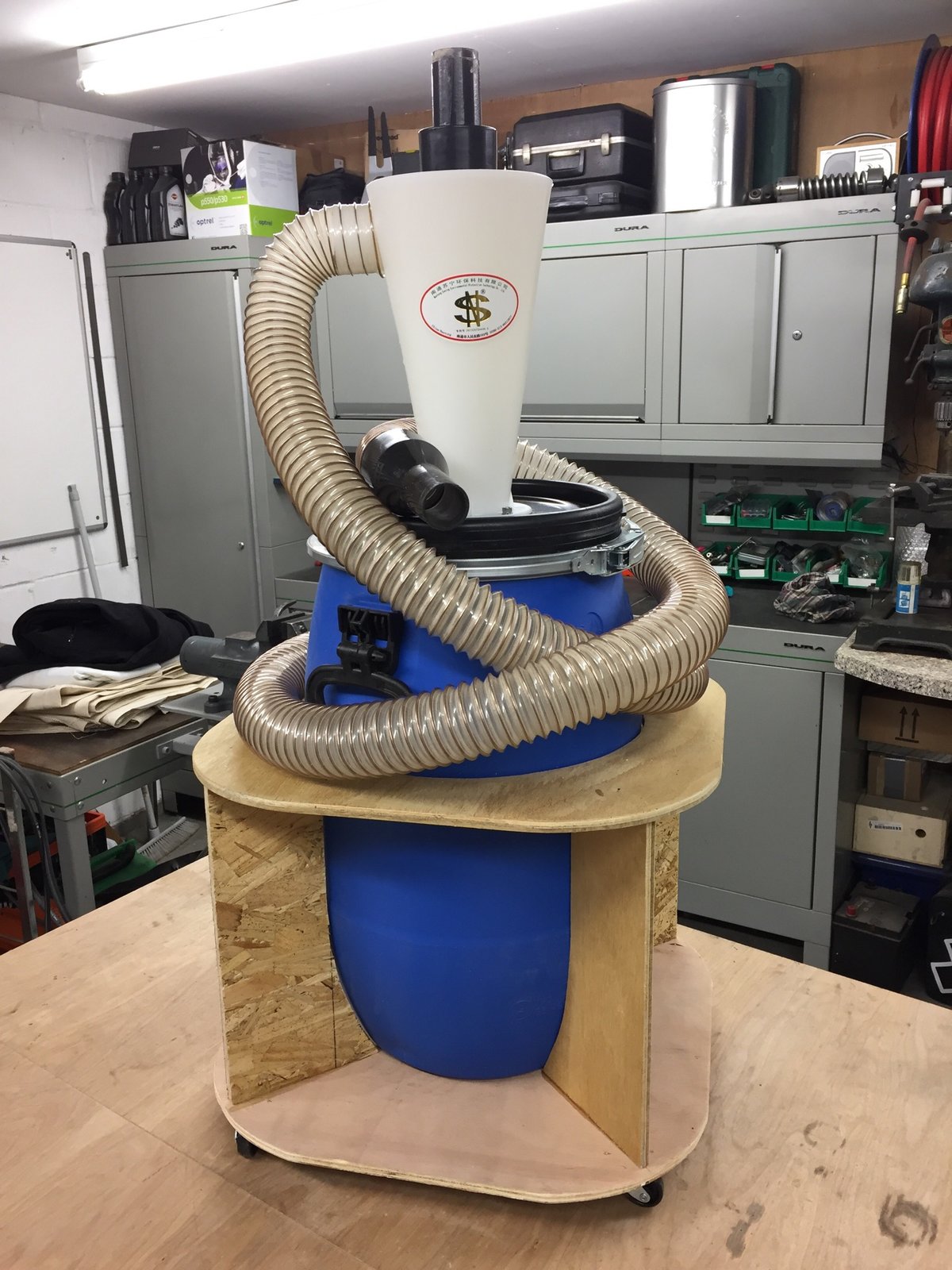

looks great .seem to recall sumthing similar used during & after a student drinking game........Here’s mine. It gets attached to a Dyson and if you block the hose completely it will collapse the drum.
A ply box with a hinge lid would be better, and you could mount the wheels easily.
Works amazingly well though. I haven’t needed to empty the hoover since I made it.

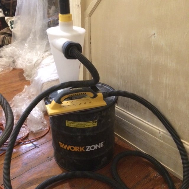

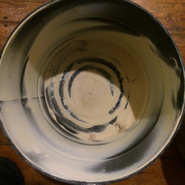

Sawdust is fine but ash blocked the Dyson micro filter. I guess the particles need some weight for the cyclone to work but I’m no expert.

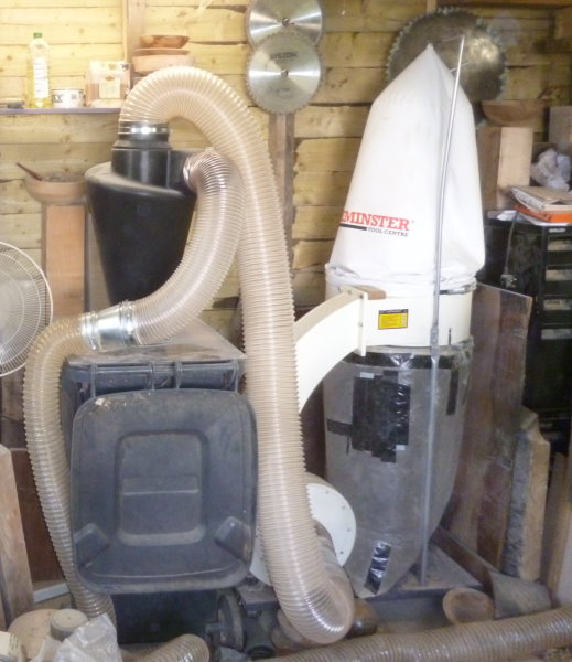

No problem with normal chips from the lathe I could not resist trying, though as expected it did not like the long curly ones or the nylon birds' nest that got stuck in the cyclone.Would be nice to find something strong enough to pick up metal grindings.
Industrial Henry sucks swarf easily om nom nom. And rust from needle guns. Rust is HEAVY. Random anecdote: We once filled a big Henry machine with rust dust, coukdn't lift it. Put a chain hoist on the handle, pulled the handle off the machine..little red thing sitting there smiling. We had to empty 3/4 of the rust back on deck to move it..Would be nice to find something strong enough to pick up metal grindings.
