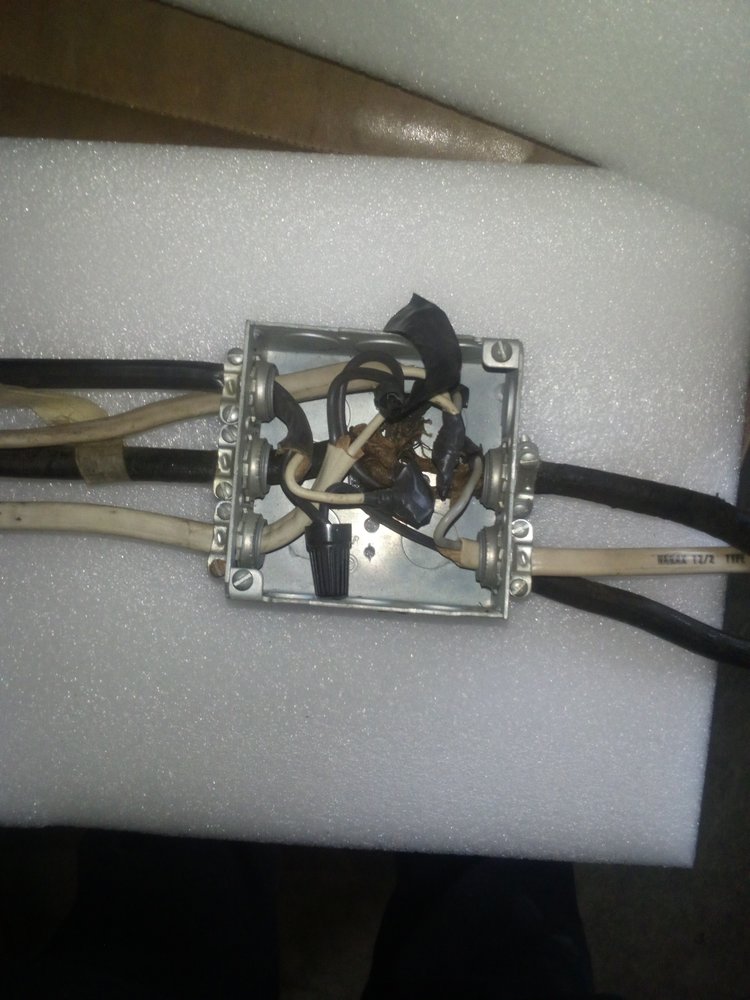

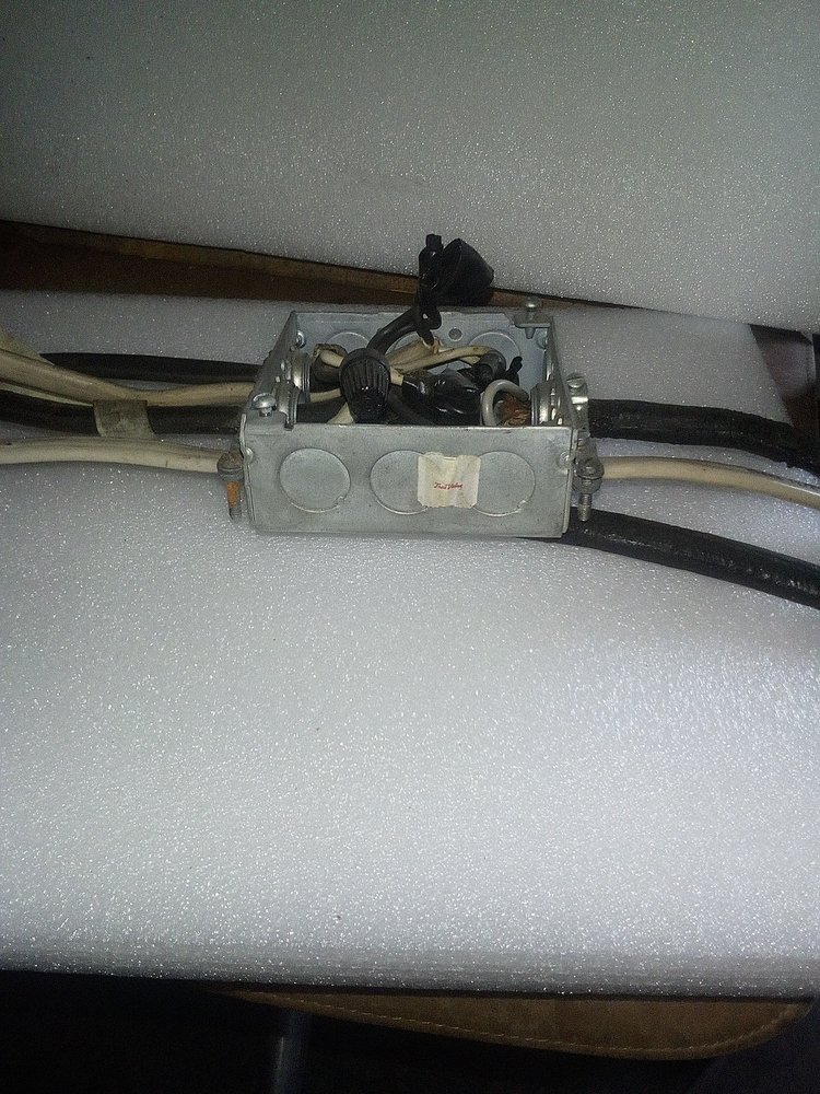

Found this buried in the vermiculite at the parents house attic......View attachment 473924View attachment 473925

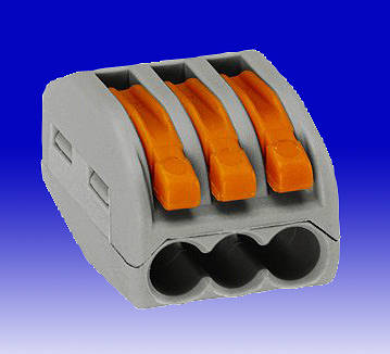

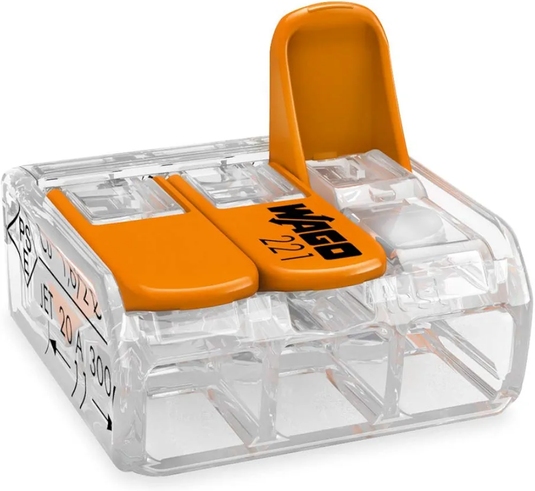

Old style:
Newer, see through type:

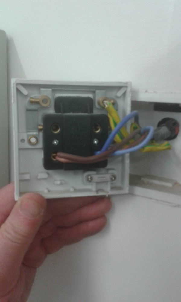

Did you not test/prove dead the equipment before you started working on it?.View attachment 473931
This isolator put me in Hospital. I switched it off, the metal case alarm was not dead.

What was wrong with it?View attachment 473931

the incomers and out going are connected together probs didnt do safe isolation test on it 1st dont take anything for granted its turned off and you will live to tell the taleWhat was wrong with it?
That how I saw it.Yeah I wasnt sure, it's hard to tell.
Was that terminal screw touching the earth bar?
the earth bar is set back from the mains terminals so wont touch if unscrewed. if it was touching there would be a bloody big bang no screw left . a big hole in the bar and a ton of black carbon round itThat how I saw it.
Or else it was out far enough for a certain person to make contact with live and earth.
