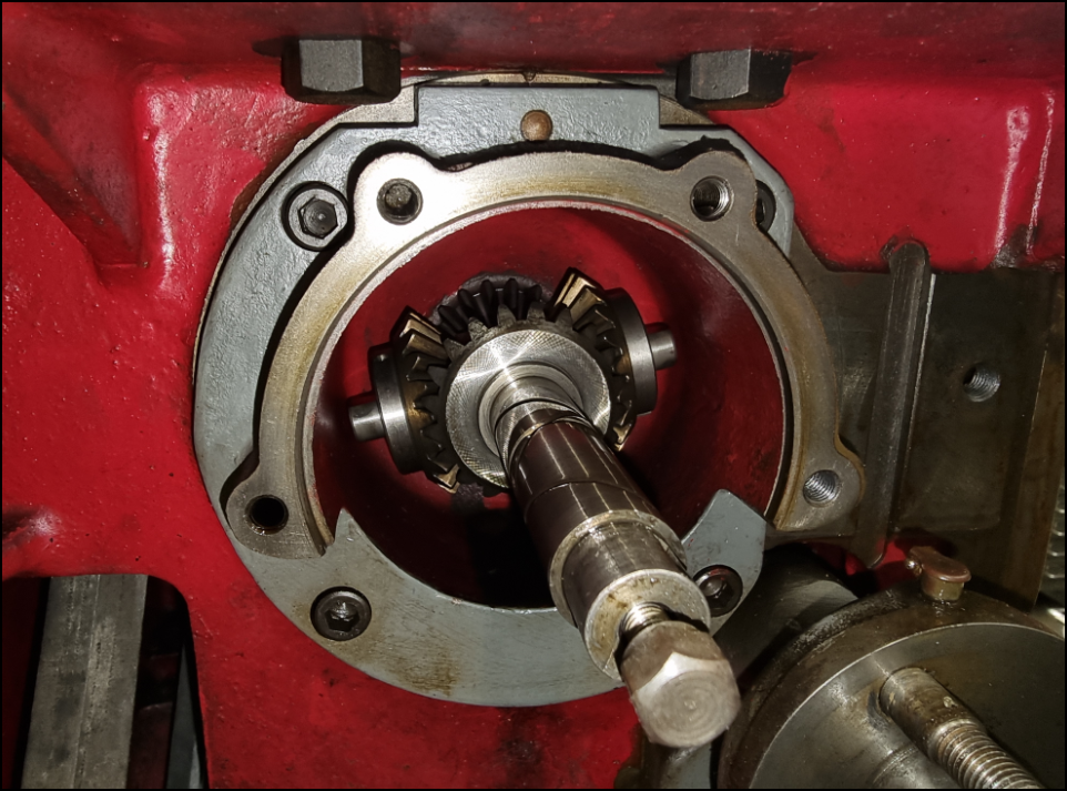

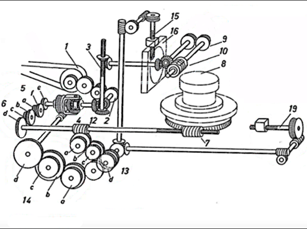

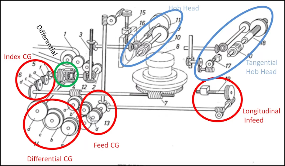

The differential adds an option to make bevel gears. If the differential is not in mesh, then the result is a helical gear. If the differential is engaged, (the table rotation is slowed down or speeded up refer to the reference, the helical gears teeth can be left or right angled. The differential's gearsets and resulting angles are in a big-big table in the manual.So the helix is created by a gain or loss per rotation in the index feed?
Is there a link to the video? What is purpose of the differential?
Can’t the extra index feed be recreated by a slightly incorrect index train for the regular spur type?
Look up YouTube user Toms Rabbit hole.So the helix is created by a gain or loss per rotation in the index feed?
The teeth width is measured, then corrected by the depth of cut. First, you make a heavy cut around 75-80% of the final tooldepth, then measure the tooth width (W(k) in EU), then make a final pass accorduing to this dimension. I only know the metric measurements. Eg if the desired tooth width is off by 1mm or so, then you make a cut with this off-dimension with a correcting factor (~~1,43? I dont rememeber). The factor and all this method is mentioned in the manual. I only worked with a Lambert No. 68 hobber.does it also correct the bevel gear teeth for width? I can't begin to think how...
But the tooth width tapers along it's length? so it would need to be cut 3 times?The teeth width is measured, then corrected by the depth of cut. First, you make a heavy cut around 75-80% of the final tooldepth, then measure the tooth width (W(k) in EU), then make a final pass accorduing to this dimension. I only know the metric measurements. Eg if the desired tooth width is off by 1mm or so, then you make a cut with this off-dimension with a correcting factor (~~1,43? I dont rememeber). The factor and all this method is mentioned in the manual. I only worked with a Lambert No. 68 hobber.
Hmm, maybe bevel gears need a special machine, with shafts at adjustable angles, maybe shaper territory?The differential on mine only adds rotation to allow for helical gears helix angles. Nothing tondonwith bevels it can't cut them.
Yea.. it's not bevel gears, it's called helical gears.. I f*cked up with the correct word..The differential on mine only adds rotation to allow for helical gears helix angles. Nothing tondonwith bevels it can't cut them.

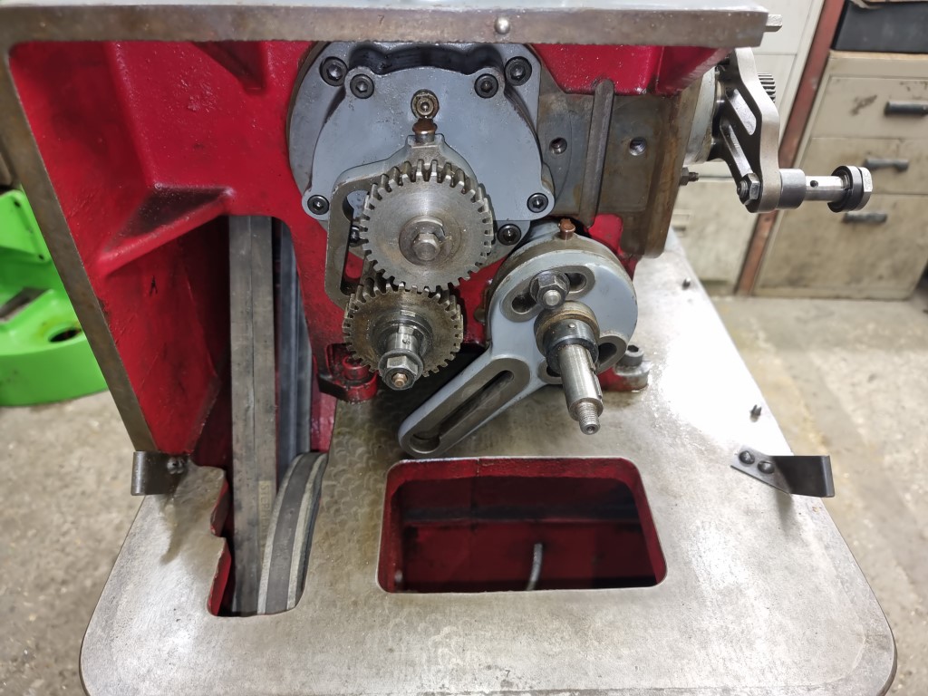

Glad to see you function at about the same pace I doNo workshop tonight. Instead I relaxed at my PC and took the time to edit the above image to show the geartrain better, to help visualise the functions. It's pretty cool and it only took me several hours.....
