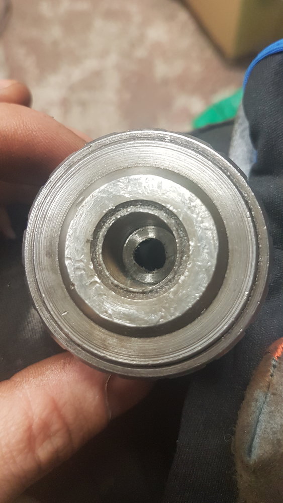

I recently bought a replacement used chuck for my pillar drill. It's a Jacobs 34, same as what it had before. Already had the arbour fitted.
I used it today and noticed there was alot of run out.
I bought it as it was smooth and had very little wear on the key teeth.
However, the drill bit doesn't seem to have much run out at all.
I've not measured it yet to check exactly what's going on though.
Before I start messing with it, is it common for the chuck body to run out (I'm going to guess it's getting on for 1mm!), but for the jaws to be true?
Pretty sure the taper in the quill is good as I never noticed any issues with the old chuck and a couple of days ago I used a large mores taper drill with no issues.
