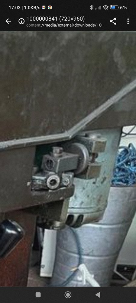

I did notice in a picture of the mb4/3 that something seems missing from what I presume is the belt tensioner. Any idea if this is a serious problem?

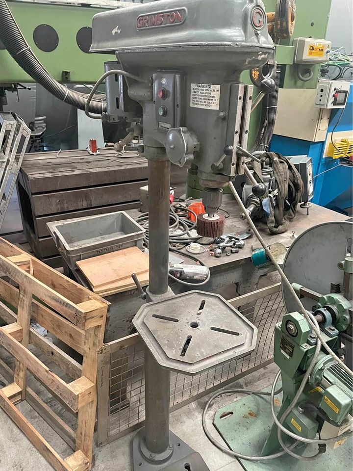

Looks like a nice solid machine but bottom speed is 500rpm. That may be too fast, depending on what you are doing.Anyone got any thoughts on an old Grimston drill? One on ebay close(ish) to me now.
Yeah, will be run off a VFD. Depends what it goes for, just looking as it's near me.Model 1B in case you did not yet see it:

I share the concern above about the slowest speed being a little high. However, being three phase, you will likely have to run it from a VFD so realistically you could run at half the published speed (i.e. 250 rpm) with no issues.
